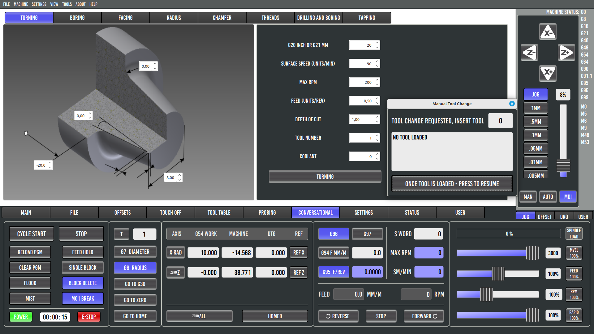

I’ve just updated, and now the screen displays correctly. The arrows seem to respond properly, but none of the conversational macros work—or maybe I’m doing something wrong when entering the values in the fields, although it doesn’t work in simulation either. I’m attaching a screenshot.The default RPM the spindle should run at when I press the Forward button still isn’t working.
By the way, I’m not sure if I mentioned it, but I’m on the dev branch.

I’ve updated AndyPugh macros to the latest version, and now it seems to work, but it shows the tool change tab and doesn’t go any further.

15 Feb 2026 00:35 #342970
by Lcvette
Replied by Lcvette on topic Some problems with probe basic lathe
You maybe could check the lathe macros uo files using editvcp and fine the lathe macros in the probe basic widgets directory and verify the parsee widhet entry names correspond correctly with the macros being used. From a glance it appears they may not be the same.
github.com/kcjengr/probe_basic/tree/main...dgets/conversational
You need to make sure those variables are get ng from the ui to the subroutine at the top.

I’ve tried changing the field names in Turning using Qt Designer so they match the macros, but without success. I’m not exactly sure if what I tried makes any sense, since I don’t have experience with this.I’ve looked at the files in the link, but are they for Probe Basic Mill? This is a bit beyond me because I don’t really have the necessary knowledge…I also saw a post on the Facebook page about an update to the lathe conversational section. Does anyone know when that update will be released?

dont change the ui names, modify the macros otherwise on an update you will be overwritten while macros in your config folder for machine are not

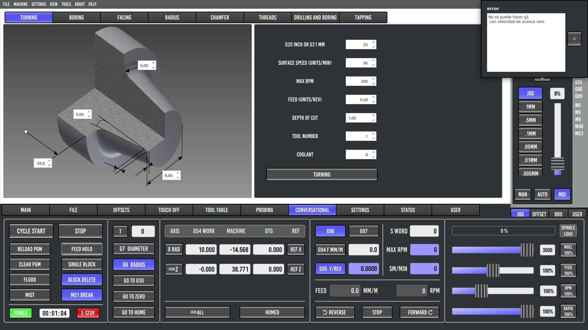

I changed the macro names, but I wasn’t able to get it to work.
I’m not sure if the names I saw in Qt Designer are the correct ones…
