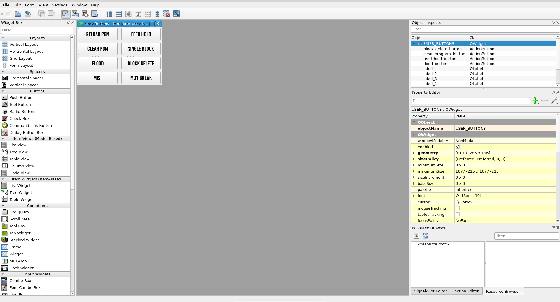

Hello,
i need some buttons in Probe basic which activates outputs from my Mesa 7i76e. The attached photo show what i need.
I found /user_buttons/template_user_buttons/template_user_buttons.ui (attached). Would that a nice place add the buttons. But so far i don´t know how to start the ui ind Probe Basic GUI.

You can add to the user tab and turn it on in the initial file, this is covered in the docs
kcjengr.github.io/probe_basic/update_notes.html

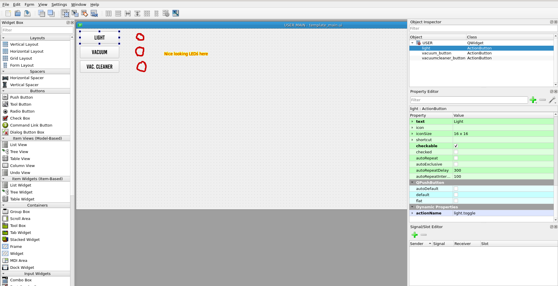

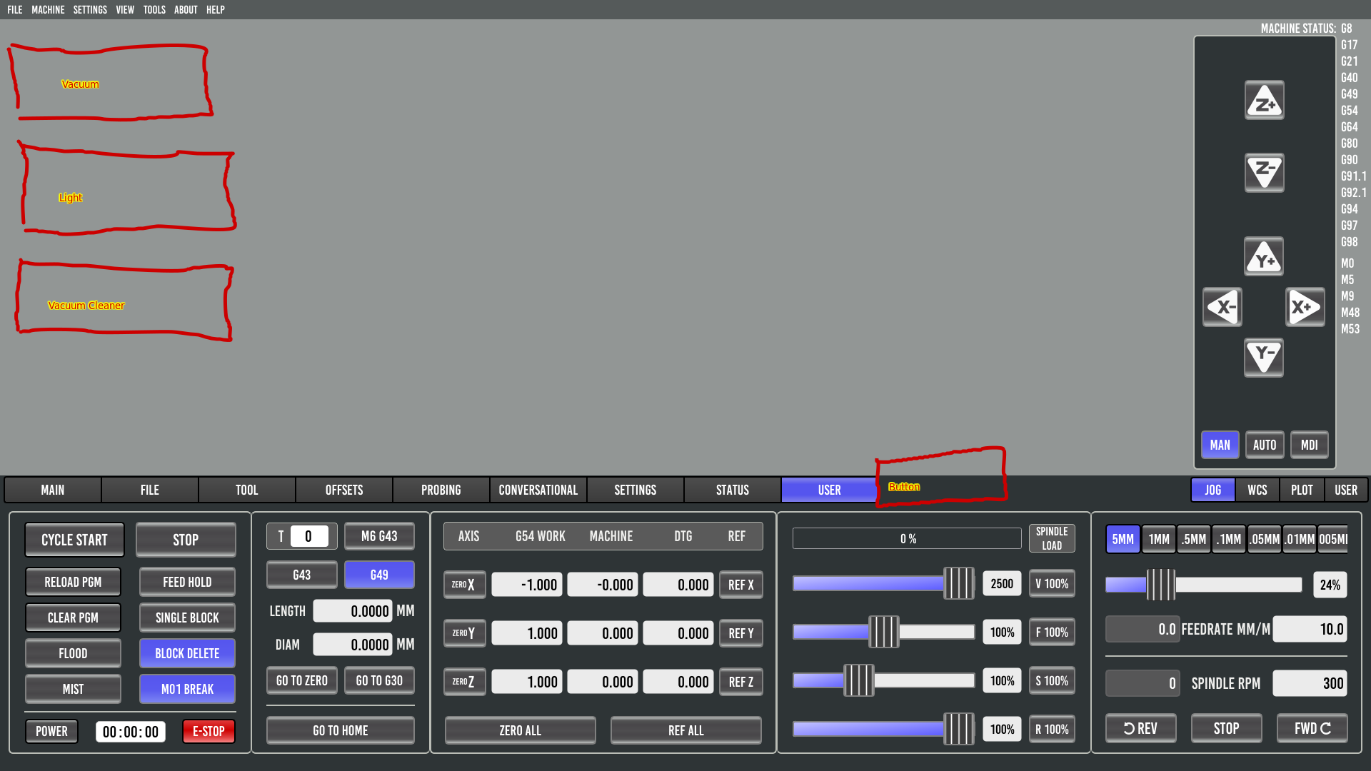

Hello,I've been working on this for the last few days and now understand how to add switches graphically under user_buttons/template_main/template_main.ui (see attached photo).However, I don't know how to link the light switch to the output of my Mesa 7i76e, for example. I tried to implement net light => hm2_7i76e.0.7i76e.0.0.output-02 <= qtpyvcp.light in my postgui_hal. Unfortunately, that didn't work. What am I overlooking as a newbie?
And in addition i´d like to have a nice looking Led right to the button. Red = off, green = on. I could not find one in QT Designer. Alternatively, the button itself could change from red to green.

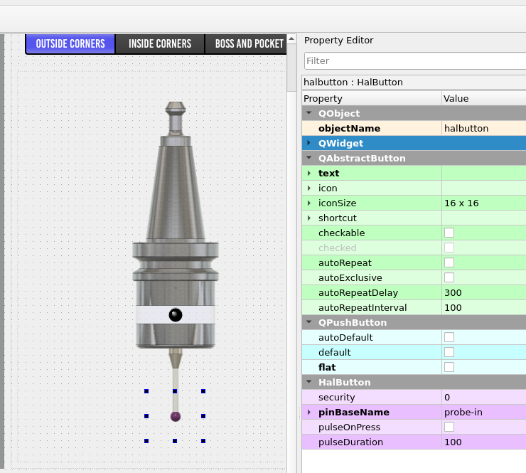

On the probe page in qt designer, there is a button where the probe to is and the output from linuxcnc goes to the led on the probe graphic, use that as a template

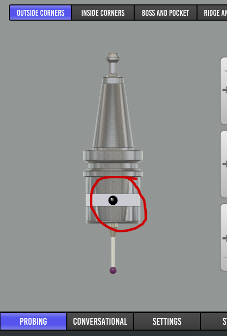

21 Feb 2026 12:09 - 21 Feb 2026 12:51 #343254
by DerKlotz
Replied by DerKlotz on topic Add Buttons in Probe Basic
You mean that led at the attached photo? I can´t find a probe section in QT Designer or do i need to be in Probe Basic Development modus instaed of stable?
And can you help me here ->
However, I don't know how to link the light switch to the output of my Mesa 7i76e. I tried to implement "net light => hm2_7i76e.0.7i76e.0.0.output-02 <= qtpyvcp.light" in my postgui_hal. Unfortunately, that didn't work.
Last edit: 21 Feb 2026 12:51 by DerKlotz.
- Lcvette
- Posts: 1681
- Thank you received: 783
21 Feb 2026 22:29 - 21 Feb 2026 22:33 #343284
by Lcvette
Replied by Lcvette on topic Add Buttons in Probe Basic
open a terminal and type in:
editvcp probe_basic
it will open the editor so you can see the properties. here is an image of them for reference:
Follow the sim hal and postgui hal to see the connections. note the pinbasename properties for the in gui button and the led and how the connections flow in postgui hal:
# *** Probe graphic simulation trigger push probe tip ***
net probe-in => qtpyvcp.probe-in.out
net probe-in <= qtpyvcp.probe-led.on
editvcp probe_basic
Last edit: 21 Feb 2026 22:33 by Lcvette.

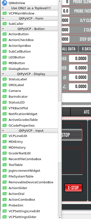

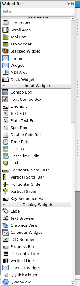

I can open probe_basic now and QT Designer starts. The sidebar here shows many more options then on the sidebar when i open template_main-ui. I don´t have these QtPyVCP Widgets. So QtPyVCP it is probably not installed.
So i tried to install it like shown here www.qtpyvcp.com/install/pypi_install.html . I installed the Prerequisites and did "python3 -m pip install qtpyvcp"
error: externally-managed-environment
