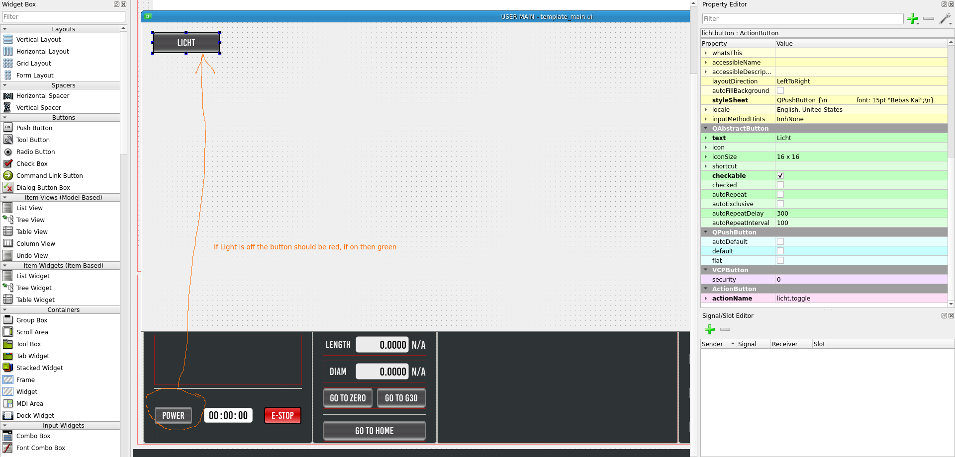

04 Mar 2026 09:03 - 04 Mar 2026 10:52 #343827
by DerKlotz
Replied by DerKlotz on topic Add Buttons in Probe Basic
After some days of trial and error i don´t know further
I created a button "Licht" in QtPyVCP. This light button should switch on my hm2_7i76e.0.7i76.0.0.output-02 from my Mesa 7i76e. In my probe_basic_postgui.hal and tried to implement this function with no success. See postgui Liine 28 and 29.
In addition it would be nice when the "Licht" button is read when off and turns into green when on. The Power on button in the basic GUI turns into green when on.

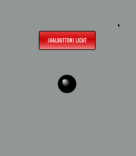

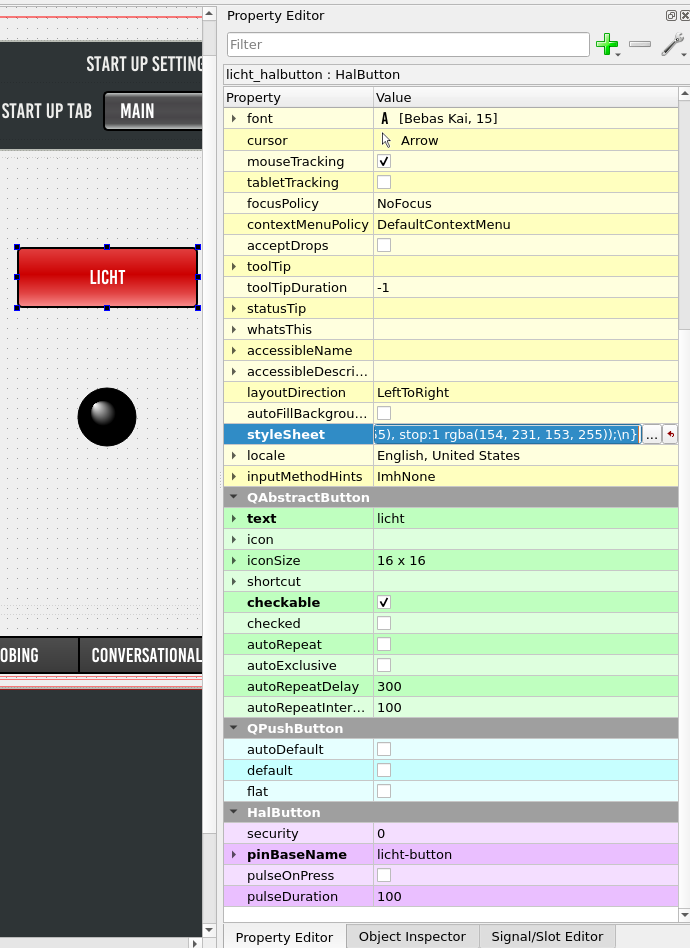

You are trying to control a hal pin, so you will want to use a HalButton from the custom widgets tree. the halpin will have the pinBaseName property you need to set for the button's connection to your licht net. see image below for references:

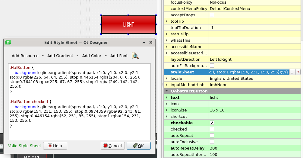

the button color can be style in the stylesheet (see image below) using the following color connections:
The button probe_basic_postgui.hal file connection code is as follows:
once done you should have something that works like this gif below, but for your physical light:
.HalButton {
background: qlineargradient(spread:pad, x1:0, y1:0, x2:0, y2:1, stop:0 rgba(226, 64, 64, 255), stop:0.446154 rgba(204, 0, 0, 255), stop:0.764103 rgba(225, 67, 67, 255), stop:1 rgba(249, 142, 142, 255));
.HalButton:checked {
background: qlineargradient(spread:pad, x1:0, y1:0, x2:0, y2:1, stop:0 rgba(154, 231, 153, 255), stop:0.0974359 rgba(92, 243, 81, 255), stop:0.446154 rgba(52, 251, 35, 255), stop:1 rgba(154, 231, 153, 255));
}The button probe_basic_postgui.hal file connection code is as follows:
loadrt time
loadrt not
addf time.0 servo-thread
addf not.0 servo-thread
# *** Time items required for Probe Basic to run ***
net prog-running not.0.in <= halui.program.is-idle
net prog-paused halui.program.is-paused => time.0.pause
net cycle-timer time.0.start <= not.0.out
net cycle-seconds qtpyvcp.timerseconds.in <= time.0.seconds
net cycle-minutes qtpyvcp.timerminutes.in <= time.0.minutes
net cycle-hours qtpyvcp.timerhours.in <= time.0.hours
# ---manual tool change signals---
net tool-change-request => qtpyvcp_manualtoolchange.change
net tool-change-confirmed <= qtpyvcp_manualtoolchange.changed
net tool-number => qtpyvcp_manualtoolchange.number
# *** Probe graphic simulation trigger push probe tip ***
net probe-in => qtpyvcp.probe-in.out
net probe-in <= qtpyvcp.probe-led.on
# *** Set line below for actual spindle readout from your hal file ***
net spindle-rpm-filtered scale_to_rpm.out => qtpyvcp.spindle-encoder-rpm.in
# *** custom gui hal widget connections ***
net licht <= qtpyvcp.licht-button.checked
net licht => hm2_7i76e.0.7i76.0.0.output-02
