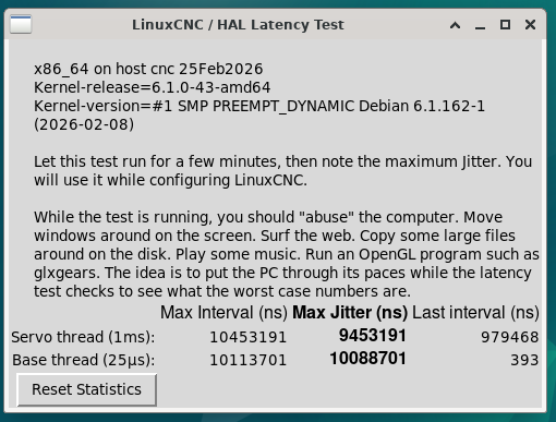

25 Feb 2026 16:08 - 25 Feb 2026 16:09 #343472 by DerKlotz
Replied by DerKlotz on topic Add Buttons in Probe Basic
Pretty sure yes... i got it to work now. But the latency of my new system is really really slow. I switch back to the old one.

25 Feb 2026 19:02 #343492 by tommylight
Replied by tommylight on topic Add Buttons in Probe Basic
Attached picture of the latency shows a Preempt-Dynamic kernel, not the required Preempt-RT kernel, so that will not work.
Try installing the RT kernel, if this works:
sudo apt install linux-image-rt

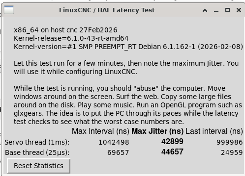

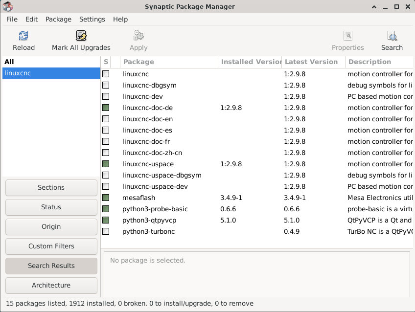

27 Feb 2026 10:27 - 27 Feb 2026 11:35 #343590 by DerKlotz
Sudo apt --fix-broken install didn´t work. I used the Synaptic Package Manager. I used Broken Filter, deinstalled it.
Then sudo dpkg -i linuxcnc-uspace_2.9.8_amd64.deb again and after it sudo apt install linux-image-rt-amd64 and restart.
Now i have the Preempt Kernel and Linuxcnc 2.9.8 installed
Seems to work now

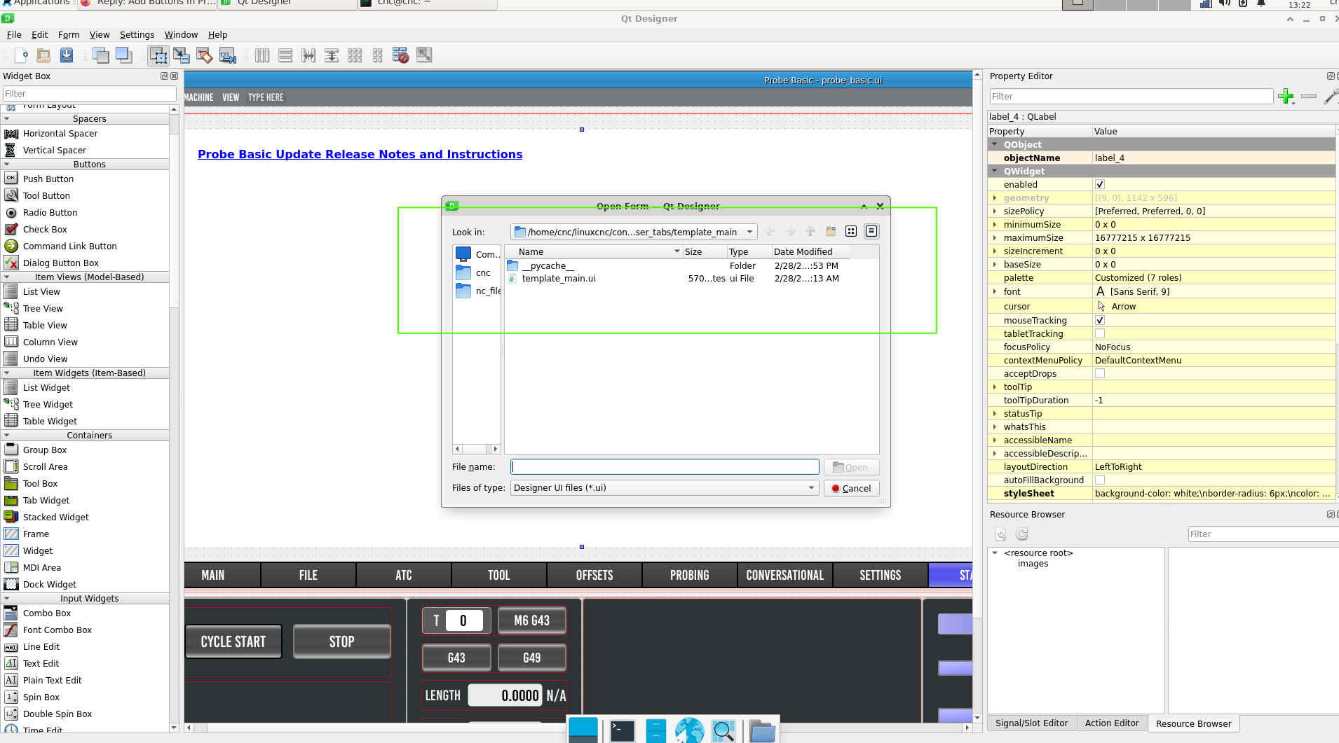

28 Feb 2026 12:24 #343648 by DerKlotz
once done you ONLY edit while running:
editvcp probe_basic
this goes for when you edit anything including the user sidebar, the user tabs, user buttons etc. this opens probe basic in qtdesigner and qtpyvcp so all of the existing custom widgets are available.
DO NOT EDIT THE PROBE BASIC SCREEN or it will break you apt update ability.
only run it to startup qtpyvcp with full functionality.
Just to verify...
-> edivcp probe basic
From there i open for example the main-template (attached photo) if i want to add buttons?
