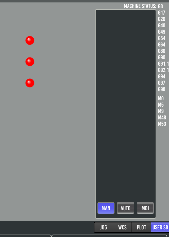

03 Sep 2026 03:16 #349260
by spumco
Replied by spumco on topic (Solved) Probe Basic - HAL pins not being created
Ok, HalLedIndicator is now showing up in halshow.
Every time I tried to edit probe_basic.ui I couldn't save it due to permissions. And trying 'sudo editvcp probe_basic' resulted in an error before opening.
Had to
The user tab is not showing up on the screen (see attached), but at least I've made some progress.
Had to
- make a copy of probe_basic.ui and probe_basic.qrc
- paste copy in some non-root folder
- open sudo -thunar and rename the original
- open the copy in vcp
- open the user_tab.ui file and edit/save both ui files
- using sudo-thunar paste the probe_basic.ui & .qrc file copies back in to the python3/dist-packages/probe_basic folder.

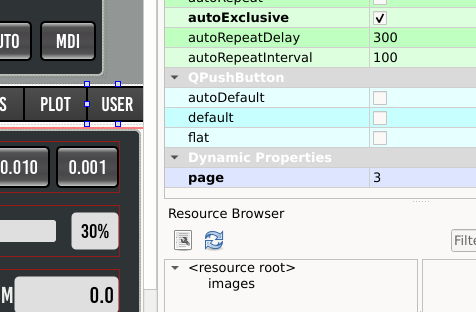

- Lcvette
- Posts: 1682
- Thank you received: 784
03 Sep 2026 03:45 #349262
by Lcvette
Replied by Lcvette on topic (Solved) Probe Basic - HAL pins not being created
you should not be saving the probe basic ui file only the files from the config folder. however, the main probe basic ui must be opened first to load the qtpyvcp widgets correctly. you can open it but not save it, only save the config user files. each one must be saved and then close designer and reopen for the next that should avoid the call for the qrc file which is located in the usr/python3/probe_basic system wide directory. you really should never have to go into that for this work.
the dro ui's like i said above have a timer that prevents them currently from registering the hal widgets on initial startup. I was too tired to mess with it tonight, but will have aquick look in the morning to see if its something simple. i know i had to add the timer to prevent other issues i was dealing with from loading multiple ui files so i make no promises. you may need to add the led's to the sidebar tab or something which shouldn't have any issues as demonstrated previously above.

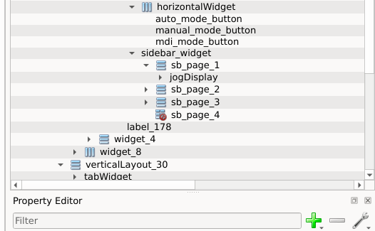

- spumco
- Posts: 2180
- Thank you received: 905
03 Sep 2026 21:29 #349297
by spumco
Had another go at it after updating again. Here's what I've found:
When selected, the user sidebar tab is empty, so I think that confirms the right stack page is being selected, but the user ui file isn't being loaded.
No error messages in terminal during startup, and I didn't change any file names or paths from the templates.
The only thing suspicious I can see is what looks like an 'inactive' icon next to the sb_page_4 object in the object window. Or I'm misinterpreting the icon - not sure.
- qrc file issues are gone. No error message that the qrc can't be found - that's a win.
- Created six hal LEDs - 3 in main window user tab, 3 in sidebar user tab
- All six LED hal pins are present in halshow - still good
- main window user tab LEDs are displayed
- sidebar user tab does not display LEDs or anything else (Qlabels)
