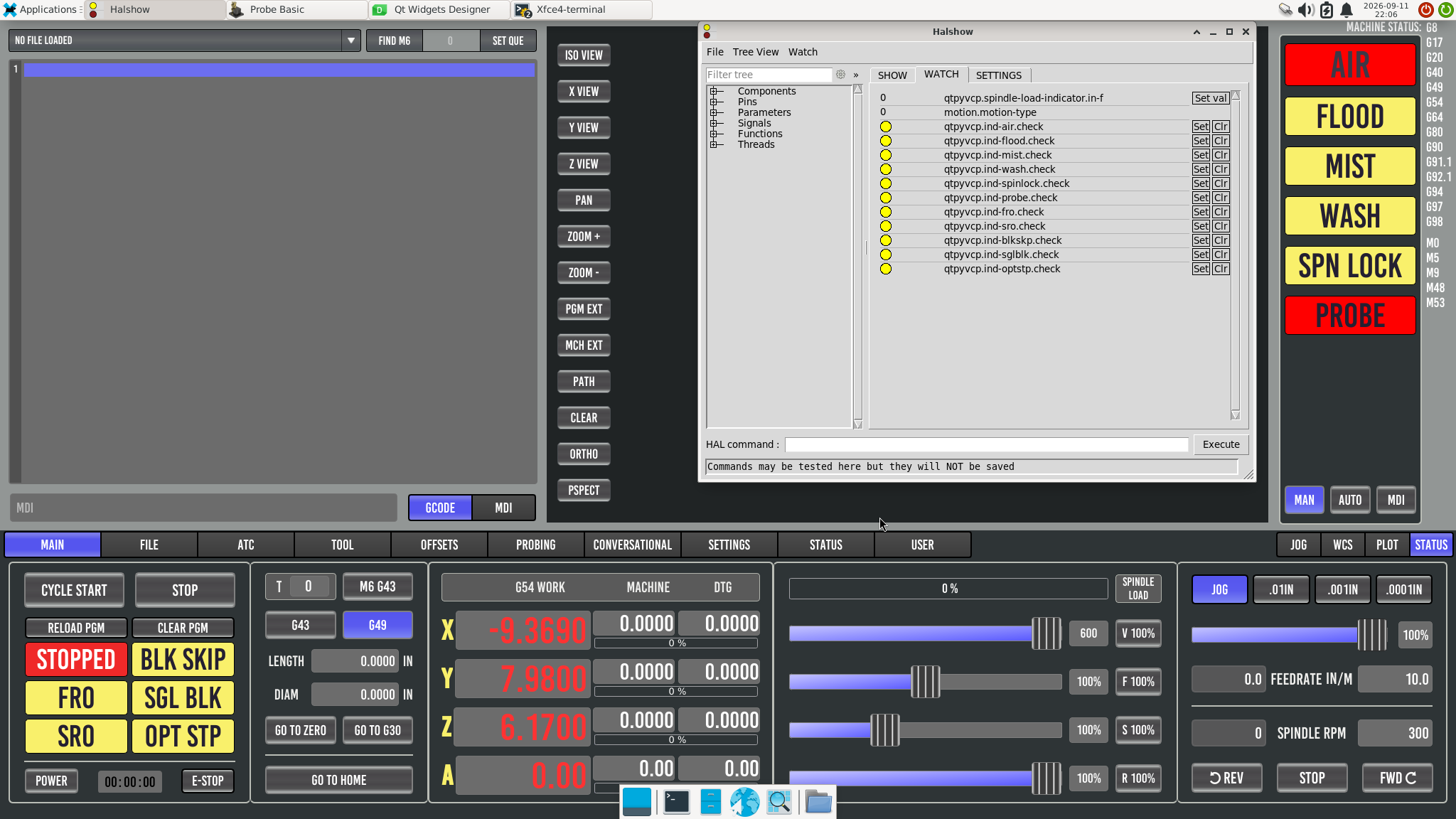

11 Sep 2026 18:52 - 11 Sep 2026 18:56 #349583 by spumco
Updated and startup sidebar selector works great, thanks very much.
Problem... something odd with the indicators.  The non-flashing indicators are no longer changing color when checked, either in Qt or the sim when I toggle the halpin.  But the flashing indicators still work perfectly.
Same thing in the user_button ui - flashing works, static color change does not.
I didn't change anything in the sidebar ui file before/after the update.

12 Sep 2026 02:11 #349587 by spumco
I couldnt figure out what was interfering with the non-flash 'checked' state, but I figured out a workaround:  set the flashState="false" to the same color as "true" and the indicator appears solid when on.

16 Sep 2026 18:19 #349681 by Lcvette
did you change the style sheet for non flashing?
16 Sep 2026 19:06 #349683 by spumco
Yes, the style sheet was appropriate for non-flashing.
