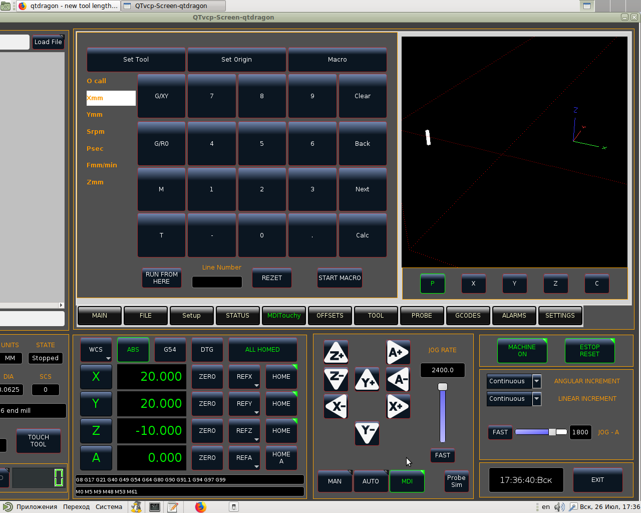

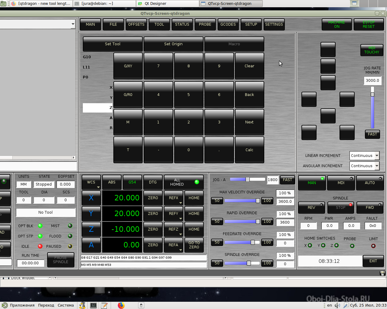

- hottabich
- Posts: 574
- Thank you received: 96
25 Jul 2020 16:23 - 25 Jul 2020 17:36 #175748
by hottabich
Replied by hottabich on topic qtdragon - new tool length after a manual tool change
Is QtDragon original right for you? QtDragon is missing the Mdi Touchy widget for macros, I think so.What is your opinion? Is this option as in the screenshot suitable?
Open post # 168892 on link, download, run and you will see three options there.
looks good, but unfortunately too big.
unfortunately only have a resolution of 1440x900.
making smaller is not possible, otherwise the arrangement will be lost or?
Last edit: 25 Jul 2020 17:36 by hottabich.
- seebaer1976
- Posts: 37
- Thank you received: 5
25 Jul 2020 18:32 - 25 Jul 2020 18:35 #175770
by seebaer1976
Replied by seebaer1976 on topic qtdragon - new tool length after a manual tool change
thank you for your help.
the original qtdragon is just the right size.
think the mditouchy is not the right one.
the only thing missing is a remap m6 macro, which in the case of a milling process with several tools, measures the new tool again after clamping and adjusts the offset against the reference tool.
as I post forum.linuxcnc.org/qtvcp/39423-qtdragon-...hange?start=0#173125 and forum.linuxcnc.org/qtvcp/39423-qtdragon-...hange?start=0#173323 times.
Last edit: 25 Jul 2020 18:35 by seebaer1976.

26 Jul 2020 06:57 - 26 Jul 2020 06:58 #175862
by hottabich
How can you use a macro in qtdragon without mditouchy or mdi_tab? I created a macro for myself return. At any moment I stop the program, go wherever I want, do what I need with the instrument, come back and continue running the program. Not suitable for shape cutter
Last edit: 26 Jul 2020 06:58 by hottabich.

- hottabich
- Posts: 574
26 Jul 2020 14:44 #175904
by hottabich
Mdi Touchy allows you to use controlled macros. You can adjust the macro for your tasks.
