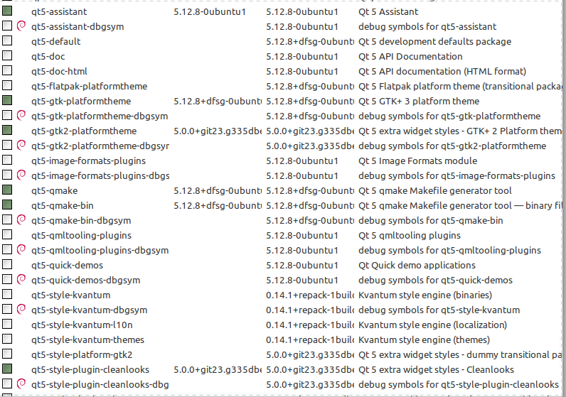

I ran the script and picked full install. It looked like it installed stuff but I get the same result. I do see that qt-designer is installed and it opens. I see this in the package manager.

- Posts: 7368
- Thank you received: 2181
03 Oct 2020 16:36 #184733
Replied by cmorley on topic Can't get LinuxCNC to start with qtdragon
is python-pyqt5 installed?

- Posts: 7368
03 Oct 2020 18:05 #184760
looks like mint 20 didn't include libraries for python2 pyqt.
unfortunately python3 for linuxcnc is not fully supported (though qtvcp does work with python3) and there are no python3 packages built yet.
It may be possible to pull in python2 libraries from another repository but i would recommend switching to mint 19 or debian buster to get official support.

- JohnnyCNC
- Posts: 572
- Thank you received: 115
03 Oct 2020 18:33 #184762
by JohnnyCNC
Replied by JohnnyCNC on topic Can't get LinuxCNC to start with qtdragon
E: Package 'python-pyqt5' has no installation candidate
I think I will try Mint 19.3 first.
