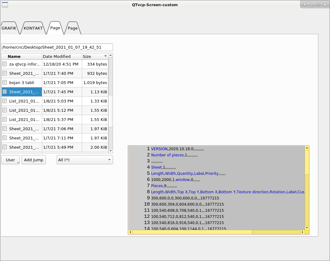

09 Jan 2021 16:40 #194654
by Pro_El
Replied by Pro_El on topic Learning to work with new QTVCP screens and handler
Hello Chris
I'v build screen to dynamically show and create custom rectangles for my automatically saw cutting software.
My next stage is to import *.CSV file and use the data inside the file. It is text file separates with commas. This files is usual generate from software for nesting.
I manage to import this file with FileManager Widget in QTDesigner and see in GcodeDisplay (like in the screenshot attach).
I did not manage to open and see with other widget like FileDialog.
My question is: can i use data inside GcodeDisplay and how can i read and use like my variables,
Or there is other recommended by you method (with other widget or module) so i can import csv file and manage data from the file.
Thanks a lot Chris,
Thanks a lot Chris,
- Posts: 7368
- Thank you received: 2181
09 Jan 2021 17:48 #194658
Replied by cmorley on topic Learning to work with new QTVCP screens and handler
The gcode editor is fairly specialized to work as a gcode display.
It's possible to display other things but it's all custom work and the widget is not very friendly.
(for instance If type PREFERENCE in the MDI line of qtvcp screens, it will display the preference file.)
I did find this:
stackoverflow.com/questions/15416663/pyq...widget-with-csv-data
I assume it would display a table of the data.
getting the file widgets to return a file path rather then loading directly into the gcode display takes some coding.
fir instance - the file manager:
linuxcnc.org/docs/2.8/html/gui/qtvcp_cod..._file_manager_widget
I did find this:
