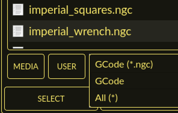

Replied by cmorley on topic FileManager extensions
Try this:
It currently requires a combox label added with a space between it and the extensions
Chris
PROGRAM_EXTENSION = .nc,.tap G-Code FileIt currently requires a combox label added with a space between it and the extensions
Chris

19 Nov 2020 18:22 #189848

19 Nov 2020 18:25 #189849
Gcode (*.ngc) and All (*) are always added. Is that problematic?
- phillc54
- Posts: 5711
- Thank you received: 2100
19 Nov 2020 18:29 #189850
by phillc54
Replied by phillc54 on topic FileManager extensions
If I click on GCode then the .tap and .nc files show but the .ngc ones don't.
If I add .ngc file to the filter then click GCode .ngc .tap and .nc files all show.
It would be nice if the files in the filter could be set as the default and also if the extensions were shown in the ComboBox.

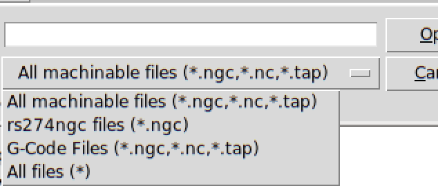

19 Nov 2020 18:48 #189855
by phillc54
This is what Axis does:
That sounds OK, the All Files is a handy backstop though.I think I'll add a default only if the INI entry is missing - otherwise you won;t see any files.

19 Nov 2020 18:58 #189856
yes having 'all' always would work too.
