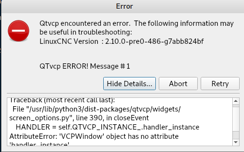

ok, back. 2 more smallish problems....
I cannot get the overall dragon screen location option to work. I've tried lots of variations.
.....DISPLAY = qtvcp -d -g 1600x1200+0+0 dragon -u dragon_handler.py
my 'dragon' panel is slightly resizeable. that is the largest is can get. no matter what I try, it still opens in it's smallest size in the upper right of the monitor. Any clue???
also, recall that I start up a small ferror panel via the post_gui hal file. it works good. i like it.
but it does not close when I close linuxcnc. I have to close it seperately with the X button, then it throw an error.
see the image.

QtDragon should remember the size and location of the window automatically without using -g - if it doesn't, that sounds like a preference file problem or a customization problem.
-m or -f should work too
I do believe the other error is fixed already - but I'll check. yep it's fixed. I guess your version is behind the source.

Preference file? what should be in that?
I see under [SCREEN_OPTIONS] there is mainwindow_geometry = xxxxxx
What should that be?
If I delete that specific line, will it regenerate? or be overridden?

If you hand edit the preference file - the screen must not be running or it will be overridden when the screen closes.
If you remove the line, it will regenerate.
I believe the line represents x,y,width,height

Chris,
ok I think i see what's up.
this is the last out of the pref file. I shut down dragon first, then my ferror panel.
if the numbers are as you mention, it's writing the info from the ferror panel..not the main dragon panel.
next time I run I will shut down the ferror panel before the main dragon, and see what happens....
[SCREEN_OPTIONS]
mainwindow_geometry = 1664 67 248 440
[SCREEN_OPTIONS]

Well that's interesting. Does your panel has a screen_options widget?
You can control it's preference file from there.
Replied by cmorley on topic NCGGUI and QtDragon
