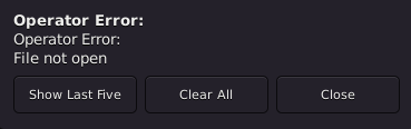

Note: Using POSIX realtime[QTvcp.QTVCP.QT_ISTAT][[33mWARNING[0m]  Invalid message configuration (missing icon) in INI File [DISPLAY] sectioN (qt_istat.py:400)Could not open command file 'qtdragon_hd_postgui.hal'79267958Stopping realtime threadsUnloading hal componentsNote: Using POSIX realtime
When I leave only:
[HAL]
HALFILE = my-mill.hal
HALFILE = custom.hallinux
starts but I get the following message:

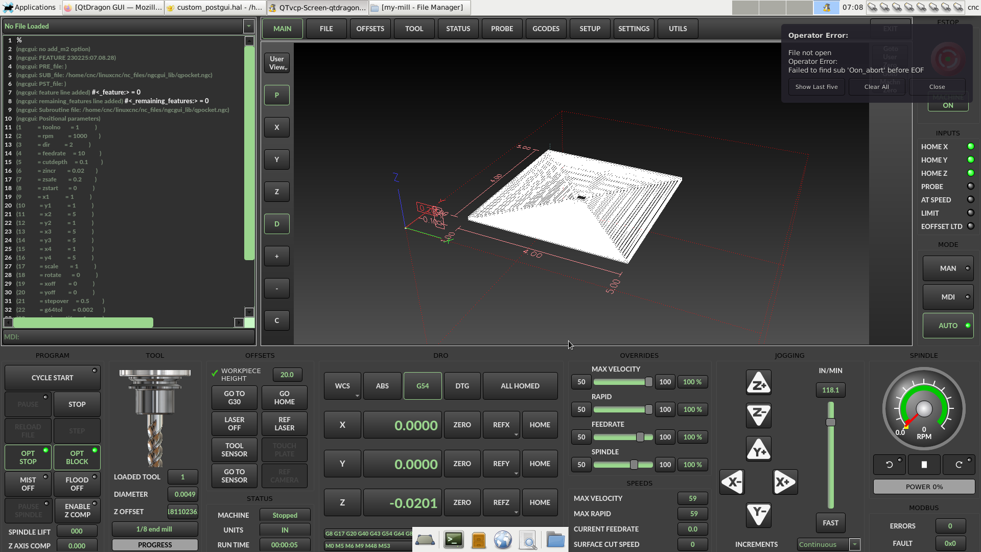

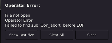

NGCGUI also started to load but still not working.I see the lines but the program itself does not start, and when I press stop, this error pops up
25 Feb 2023 12:30 #265338 by cmorley
Replied by cmorley on topic NCGGUI and QtDragon
You are missing the on_abort.ngc file.
linuxcnc.org/docs/2.9/html/gui/qtdragon.html#_abort_detection
The [HAL] section must reflect the actual files you want loaded. The documentation shows sample code, it's not meant to be copied verbatim.
The 'file not open' error I believe is caused by the option to reload the last file on startup.
Since (I assume) there was no loaded file in memory when qtdragon shuts down, it would cause this error.
You can turn off this setting in the settings page or eventually it should fix it's self.
