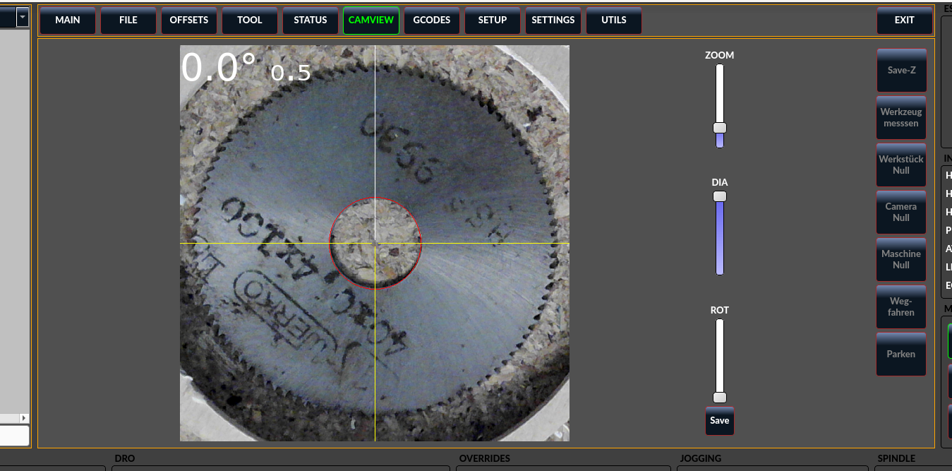

Hello,
Unfortunately, making the X value smaller doesn't help me, on the contrary it makes the image worse, see appendix.
For now I'll leave it at that, I'll scale up Y, the picture isn't that much worse. Especially since the button strip means that 1.5 on the Y axis is now sufficient again.
Actually, as I understand it, the output window should adapt to the aspect ratio, in my case there would be a black stripe on the right and left.
But the way it is now, you can work well.
Happy and healthy new year to everyone.
Greetings Frank
Greetings Frank

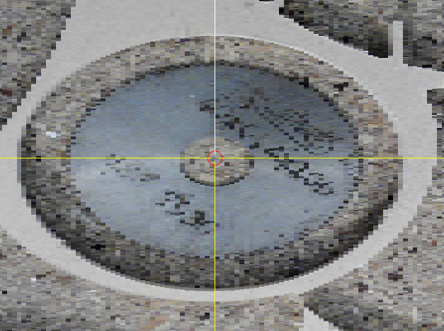

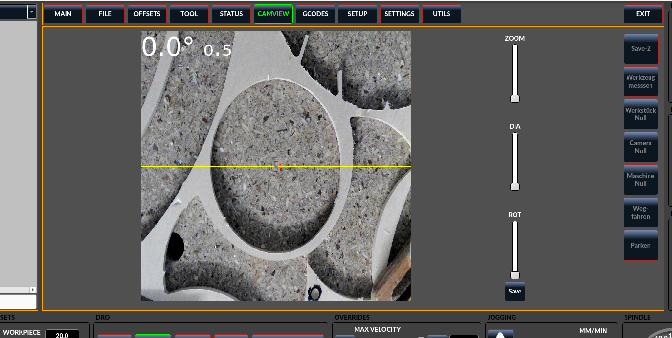

Hello,
I don't think that simply restricting it to square will improve the situation.
In normal QTDragon you can change the size of the window and when you make it smaller the image is compressed until, for example in my case, the circle is round. I think it's easier to adjust a variable that is perhaps stored in the INI, where you can determine the value once. You only touch it again when you change the camera. The current version only returns round circles when I use the camview_widget.py they sent and now scale x instead of y.
As it is now, I would row back because I think it could cause problems for more users.
Attached are pictures with directly after today's update without any customization and the one with round circles is with the modified camview_widget.py from them.
I just found a Python script to find out the resolution of my camera. If everything is recognized correctly it is 1600x1200 pixels.
Thank you and best regards, Frank.

Hello,
that looks very appealing.
Thank you very much for the effort you put in for me.
If the question were, does it make sense to actually install the controllers? That makes it easier to find the right values, but the whole process is only rarely needed once. Once you've found the value, it's actually done.
In this regard, it would be good to know what other users think about it.
I'm actually of the opinion that user interfaces should be kept slim if possible, as long as it doesn't impair usability.
For my part, I wouldn't have a problem if I had a section in the INI that contains these values, as long as it survives the updates.
I just looked at the aspect ratio again.
My camera has 1600x1200 pixels, which corresponds to a ratio of 4:3. This means that the image is slightly wider than it is tall (exactly a factor of 1.3333).
As I understand it, that's what it would mean for a square display. The image is either compressed (oval) when using all pixels in X or so that the circle remains round, pixels on the right and left have to be cut off.
Kind regards, Frank.

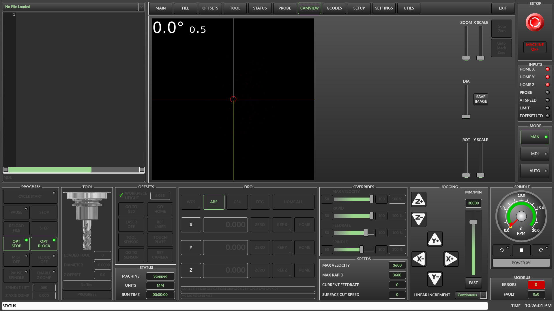

Ok I pushed another change that looks in the preference file for:
[CUSTOM_FORM_ENTRIES]
Camview xscale = 100
Camview yscale = 100
These are in percent.
You can only edit the preference file when qtdragon is _not_ running.
When it is next loaded it will use the new settings.
Chris
