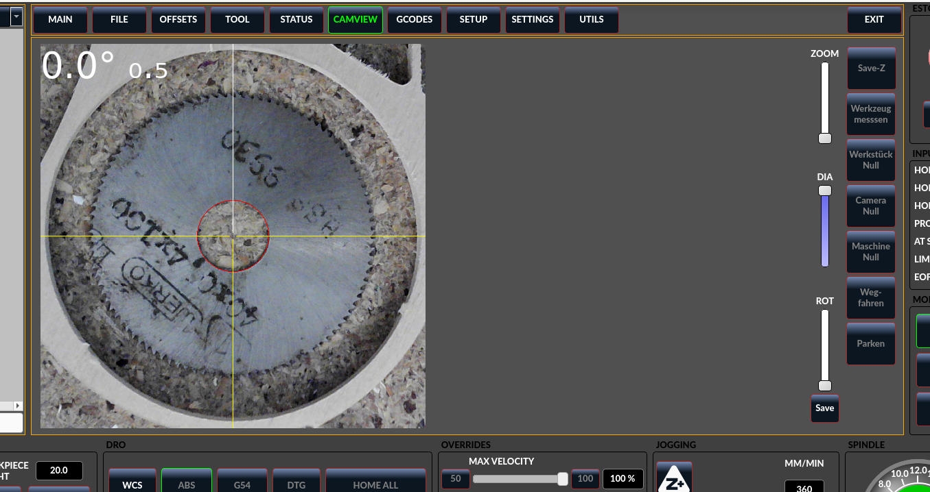

Hello,
Thanks, just tried to give it a try.
Disabled QTDragon.ui and dealers in my home directory and added the section to the INI.
But no matter what I pass as a value, nothing changes in the image.
Before changing Linuxcnc closed and then restarted.
All other files have the status of today's update.
Does the section have to be in a certain position in the INI?
Kind regards, Frank.

Replied by cmorley on topic Camera configuration
The entries go in the preference file - qtdragon.pref in your config folder.

Hello,
Sorry, found it, it's in the QTDragon preferences.
Works as expected, thank you!

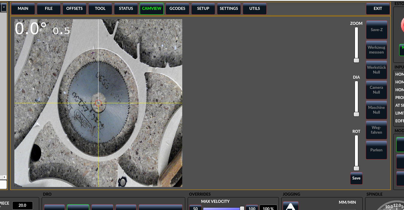

Hello,
I just played with the parameters and it does what it's supposed to do.
Fortunately, this also makes it possible to show the image slightly enlarged without using the zoom control.
Values smaller than 100 percent result in a completely distorted image.
But I would leave it like that because the desired function is guaranteed.
