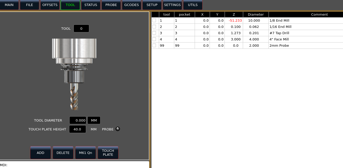

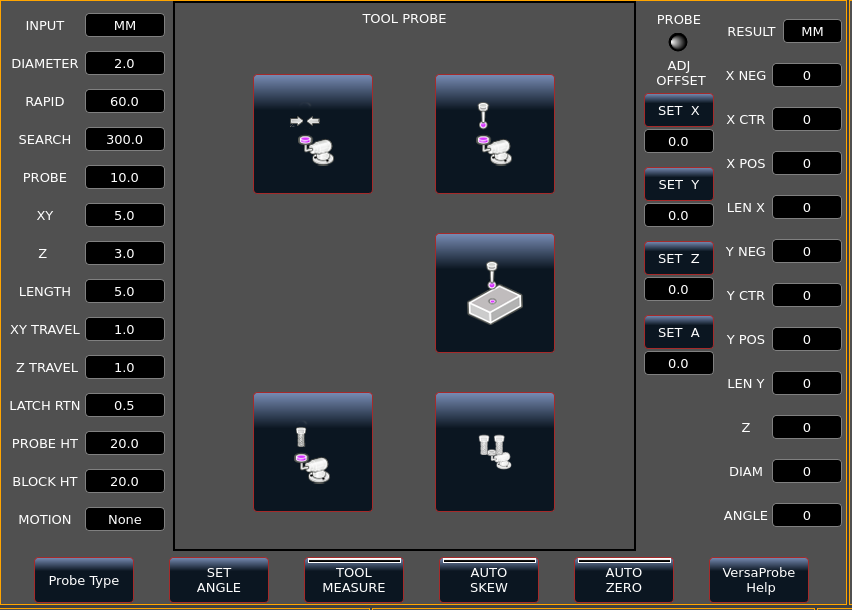

Ok, i've updated once again.  some nice improvements in QtDragon.
But, looking at the probing pages, i'm not sure what's up????
What's the Tool Probing page????
and how does it relate to the tool page????
I know documentation is not too fun, but it is pretty darn important.
Also, where is the arithmetic behind all the tool setting?  I sure would like to see it, even if it's a scan of the back of an envelope or napkin, or something.  Or, better yet, point me to the current documentation.

13 Mar 2024 10:57 #295830 by Roguish
I'd be happy to test it out. I just don't get how it's supposed to work.
I'm trying to get my tool setting worked out.
I purchased a tool setter and definitely want to use it.
I do not want to have everything automatic.
I prefer to set all my tools before starting to cut metal...
Like, use M6 Tx to change the tool. click a button (or run a program, even if it's in ngcgui) and have the tool Z offset set in the tool table. Use M6 Ty and repeat.
I've started an ngcgui routine, but need the arithmetic to go on.
the tool setter can also be used to determine the tool diameter.
what I've seen in the past was to rotate the tool in reverse and very slowly to a touchoff on the setter. as part of the prep, though, I think the tool setter center and diameter should be probed.
So, some additional documentation, even if it rough and prelim, would be really useful.
Then I could start testing and coding.........

15 Mar 2024 20:17 #296013 by cmorley
This was the rough instructions I used:
INI must have under the VERSA_TOOLSETTER heading:
X
Y
Z
MAXPROBE
Z_MAX_CLEAR
DIAMETER
tool set probe the bare spindle with 'probe tool setter height' button. this number is without tool or user offsets.
load/call a tool in linuxcnc - jog into toolsetter position
Tool set the tool with the 'tool height of current tool' button'
tool table should update and the status tab will show the calculated offset as well as the tool setter height and raw probe results.
I loaded and tool set a couple tools.
Now I have heard of people tool setting the probe but I can't see how that can be accurate (hard to get both trip points to trip at the same time), so i did something different:
before I but the probe in, I used one of the tools I had already tool set and positioned it over my vice. I used a 1/2 diameter pin to set the height above my vice. Then I zeroed my user system (g54 in my case).
Now I installed my probe (didn't change the tool number in linuxcnc) and again used the roll pin to set the Z height of the probe on my vice. Now the Z DRO reading is the difference between the original tool length and the tool probe length. So now I take the original tool Z offset (found in the tool table) and added (subtracted? I can't remember) the DRO setting and entered that as Z for tool 99 (the probe).
Then I called up tool 99 in linuxcnc.
Not saying this is the best way - just what I did. Should only need to do this once as long as both probe lengths don't change.
I set the 'auto zero' button in versa probe and used the spindle probe to 'down z probe'  the top of my vice.
Finally I changed tools back to one of the tool set tools and jogged it to the top of my vice and the dro was very close to zero.

15 Mar 2024 20:20 - 15 Mar 2024 20:29 #296014 by cmorley
I should add that this process uses the bare spindle face as the reference point for tool length.
Some people use a reference tool instead and I think you could do that with the same procedure, but I have not tried it.
Last edit: 15 Mar 2024 20:29 by cmorley.
The following user(s) said Thank You: Roguish
15 Mar 2024 20:28 #296015 by cmorley
I also forgot to say the tool table must have at least a rough diameter setting for the tool to be probed. the routine will offset the tool in X axis (before probing) if the tool diameter is bigger then the tool setter diameter.
