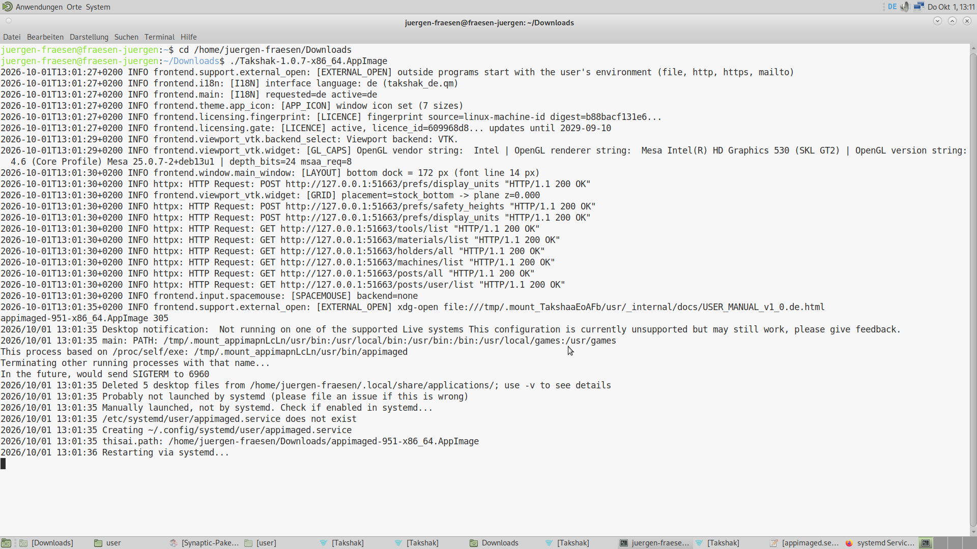

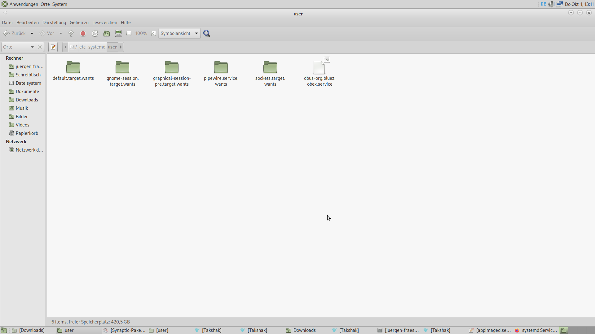

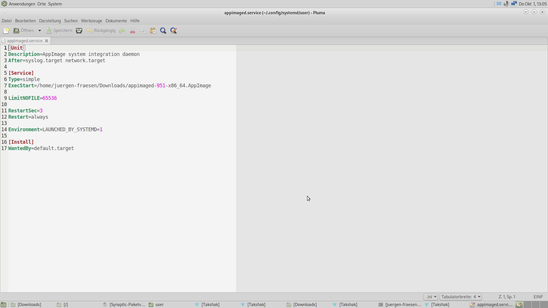

Das Handbuch kommt immer noch nicht…
Es kommt aber nur der Fehler :Not running on one of the supported Live systems“
So wie es aus sieht fehlt mir die Datai das appimaged.service in /etc/systemd/user/
wie bekomme ich das da rein ?

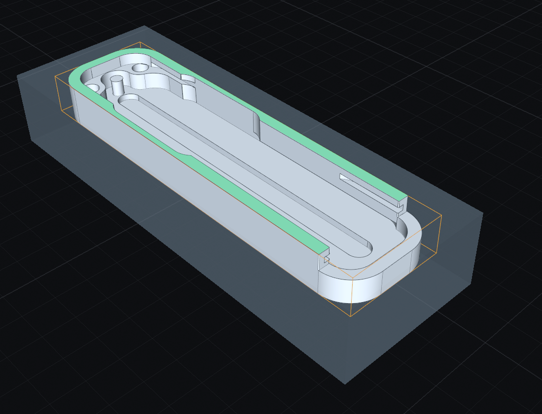

So far a mixed bag for me. For context, I normally use FreeCAD's CAM, which is honestly really good most of the time... except for occasionally breaking in seemingly incredibly dumb ways (ie, simple contour operations have gotten broken multiple times). That's been frustrating enough I was willing to try throwing some money at the problem- looking for a stop-gap "works" solution until FreeCAD stabilizes enough to stop driving me up the wall. No matter how good a standalone CAM package gets, not being integrated with your CAD is a hindrance.
Most of the stuff I do is multiple tools, generally "2.5D" (ie, very little surfacing), but operations on multiple sides and undercuts are common. Normally I'll use adaptive to rough the inside and outside- sometimes different areas w/ different stepdowns to optimize MRR- then add some contours/finishing passes to clean up edges/corners. Drill, undercut, chamfer/deburr, then cut off and flip for the other side.
The below is a "review" of version 1.0.7. Full disclosure I've only messed with it for a couple hours, so I may be wrong about some of these things! It's possible I just haven't figured out how to do stuff yet.
My current take is that it's a nice teaser/tech demo, but doesn't have nearly enough control to make parts in practice. Everything I listed in the "bad" section below is pretty much a breaking issue for me (YMMV!). That said, I really don't want to be too negative here- the core (actual toolpath generation) seems to work really well! It "just"- fully recognizing that may be a huge task- needs maybe 2-3x as many options for controlling the details of those paths to make it actually useful. (again, for me- YMMV)
If it looks like progress is being made a couple weeks from now I'll probably think it's worth gambling the $200 that it'll get usable for me someday, otherwise I'll be considering the 30-day refund policy.
The good:
The odd:
The bad (a lot of these boil down to "not enough control"):
I haven't tried a lot of stuff (surfacing, tapping, drilling, actually posting g-code, ...).I tried the automatic feature recognition a bit, and it was hit-and-miss. (Issues with the AFR do not appear to be with AFR itself, but rather things I selected after that showing up in the AFR list. So of course me selecting nonsense looked like bad AFR. Still a problem, just a very different one, and not AFR itself) I have not tried the tool library functionality enough to know how good a job it does of remembering speeds/feeds for different materials/operations/etc.

- Adaptive ONLY appears to machine the inside of your part- if you want to rough the outside, too bad, I guess?
- Adaptive has no option to force specific depths- it has a stepdown setting, but will always do Z plane detection and cut any depth it finds one. Really breaks the high-DOC-low-WOC idea of adaptive in practice- especially since it cuts top-down, instead of cutting the bulk out from the bottom, then rest-machining the next layer up, and so on.
- Chamfer operation is real rough. Sometimes it works when you select a top or bottom face (to chamfer all edges of said face), sometimes it doesn't. Manually selecting edges kinda works, but the hit box for edges is tiny, and the closed loop detection seems to only sometimes work. You can't seem to de-select edges by clicking on them in the model, you need to find them in the list. Some edges it seems to entirely refuse to recognize.
- No option I can find for ramping into pockets- helix or plunge only. Problematic if you have a long, narrow pocket that you want to ease into, but no space for a helix. Literally the only time I accept a plunge entry is drilling.
- Lead-in/-out options are limited- you can pick a lead-in radius on some operations, but not others, and you can't add a slight overlap between the lead-in and -out points on closed contours
Collision detection seems over-sold- eg, the chamfer operation will happily crash into a wall where the edge you're chamfering meets another face.See below- I misinterpreted the website, my fault.- I'm also not seeing a way to control where an operation starts or to add offsets to start/stop points to manually work around that. Looks like it only does collision detection for 3D operations

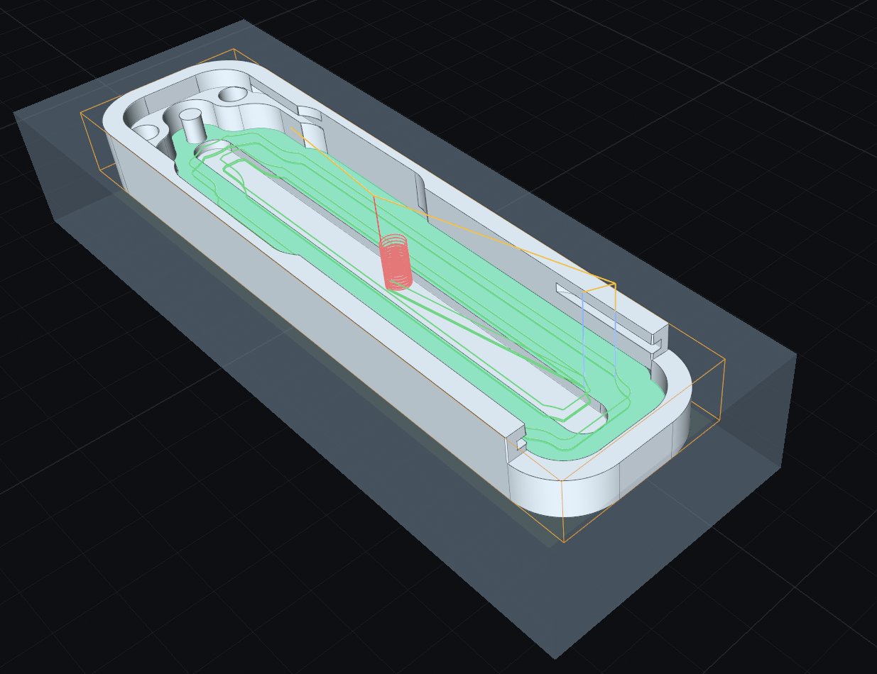

Hi @dbtayl, a follow-up on the chamfer point. You were right, and we've reproduced it.
When the edge you chamfer ends against a wall, the path runs the tool to the end of the edge, and the tool's side cuts into the wall. That was 3 mm with a 6 mm V-bit on our test part. Collision detection doesn't come into it: the chamfer path should never touch that wall in the first place.
While chasing it, we found a second issue in Mill Chamfer: the outside corners of an open chain of edges are cut up to 0.8 mm too deep. Closed loops (outer rims, pocket rims) are not affected by either.
Both are logged on our community hub. The fixes will be in the next update (1.0.8).

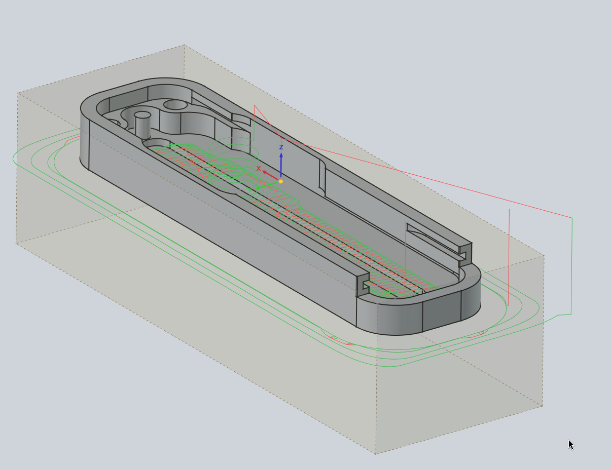

Adaptive doesn't clear outside stock, regardless of bounding box vs silhouette selection. This is with bbox (silhouette is even more constrained):
(you can also see it cutting a bunch of layers, when I'd really like it to do one depth on the outside and one on the inside- at least the option to control that)
Re AFR: This appears to be a different bug than I presented- it appears cuts you add manually subsequently show up in the AFR list- that caused me to believe it was partially detecting features, when in fact I had only partially selected them.

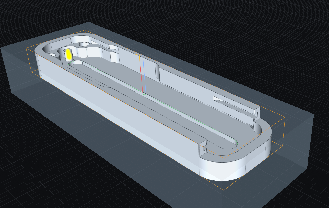

New thing I just found: Pocket operation doesn't seem to respect the entry method for more than the first pass- you can see one helix entry, then a plunge on the outside pass. Doesn't seem to matter if I check the "keep tool down" box or not.
(this also illustrates a second thing I think is a bug- that green face is stuck highlighted, makes it hard to see the toolpaths)
And while I'm being picky... controlling the helix angle is important. Some tools choke at more than 1 degree, others are fine at 5 degrees.

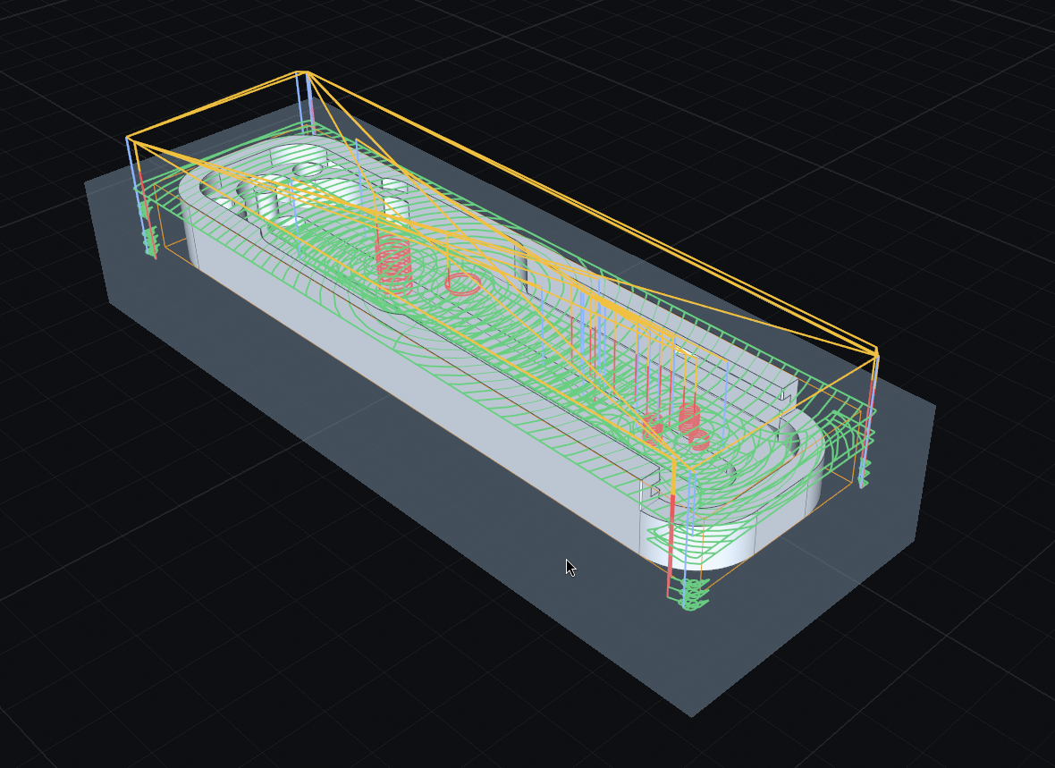

For context, this is what I'd expect to be able to get out of the Adaptive operation:
That lets me set the speeds/feeds to optimize MRR within my machine's limits, based on the depth of cut I know it's taking. If it starts taking variable depths of cut, I'm running far slower than I need to for the shallow stepdowns. Not to say Z level detection is a bad feature at all! if I weren't so obsessive about trying to optimize toolpaths, it'd be great to have a one-click option. But it's suboptimal if you're trying to optimize cut time.
