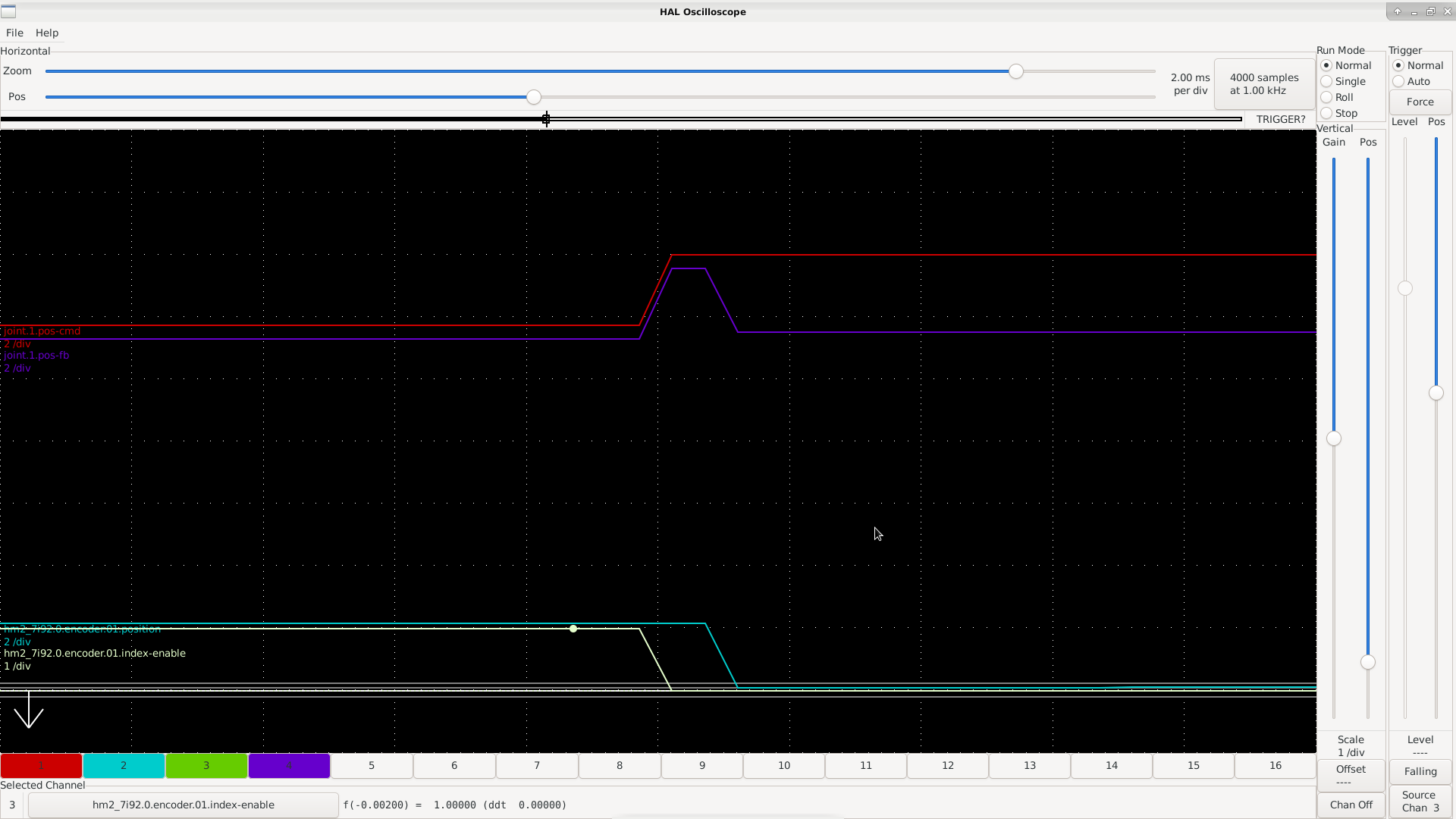

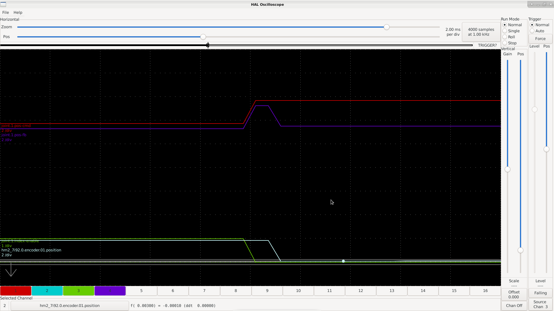

Replied by PCW on topic Following Error When Homing
Could you plot the encoder position instead of joint feedback
they are supposedly the same but just want to make sure

04 Nov 2022 14:38 #255950
by turbostew
Replied by turbostew on topic Following Error When Homing
I don't understand why you expect them to be zero..... Is seems they would settle at "HOME" after homing. That is what the DRO reads.... is the home offset added downstream to an expected zero joint cmd and fb? I want to understand the inner workings better....

04 Nov 2022 14:39 #255951
by turbostew
I will plot, BTW, thank you so much.

04 Nov 2022 14:40 #255952
The encoder feedback is zeroed at index
the axis has an offset but not the joint (or encoder position)

04 Nov 2022 14:45 - 04 Nov 2022 14:45 #255954
by turbostew
According to HAL they are the same..
net y-pos-fb <= hm2_7i92.0.encoder.01.position
net y-pos-fb => pid.y.feedback
net y-pos-fb => joint.1.motor-pos-fb

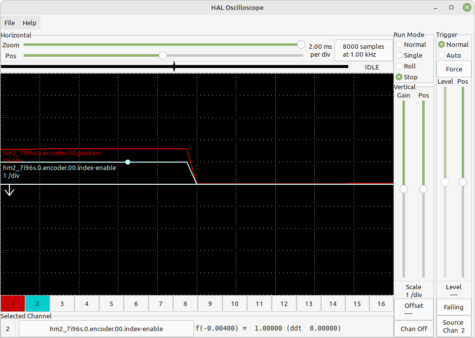

04 Nov 2022 15:28 #255958
Yeah, for the same reason, can you plot the encoder index enable rather than joint index enable?

04 Nov 2022 15:41 #255960

- Posts: 18118
- Thank you received: 5336
04 Nov 2022 16:21 #255964

04 Nov 2022 16:57 #255970
by turbostew
