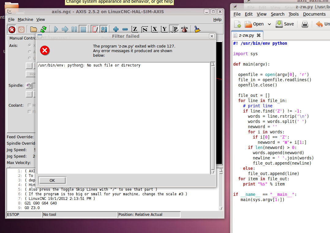

What is your INI line for z-zw.py?
You can put the file anywhere you like if you use the full path to the file in your INI.
I didn't test it in /usr/bin but I assume you need to copy it using sudo and make it executable.
John
John

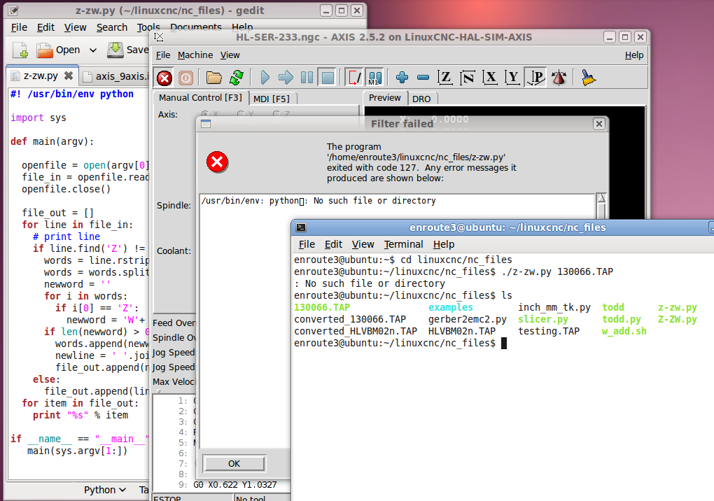

I tried it both ways with the full path in /home/enroute3/linuxcnc/nc-files/ and with it saved to /usr/bin (using sudo) and the file(s) were made exicutable. All gave the same results.
If I had the path wrong in the ini file it gave a different error, saying that it could not find the script. In this case /bad path name/z-zw.py.

I think I understand what the problem is. Put z-zw.py in the same directory as the file your converting and have your ini file point to that directory.
John
John

The script with print "%s" % item should not be run from the command line.
I see you must have ran the other file a few times as I see the converted files.
Are you using a stock 10.04 LiveCD install? It seems to be choking on the location of python in the first line of the script.
John
John

Maybe because I forgot to quote the file name parameter in the script. Is there by any chance a space in your network file path?
Fire up gedit:and add quotes to $1, like this:
Does that work?
Replied by arvidb on topic Creating a Script
Ok, this sed script works but...
It will load and convert files saved on the hard drive, but when I try to load a file that was saved on our network I get file not found errors. But files opened from the network that don't go through the script still open fine. Why?
Fire up gedit:
$ sudo gedit /usr/bin/w_add.sh
sed 's|Z\([-.0-9]*\)|Z\1 W\1|g' "$1"
Does that work?
