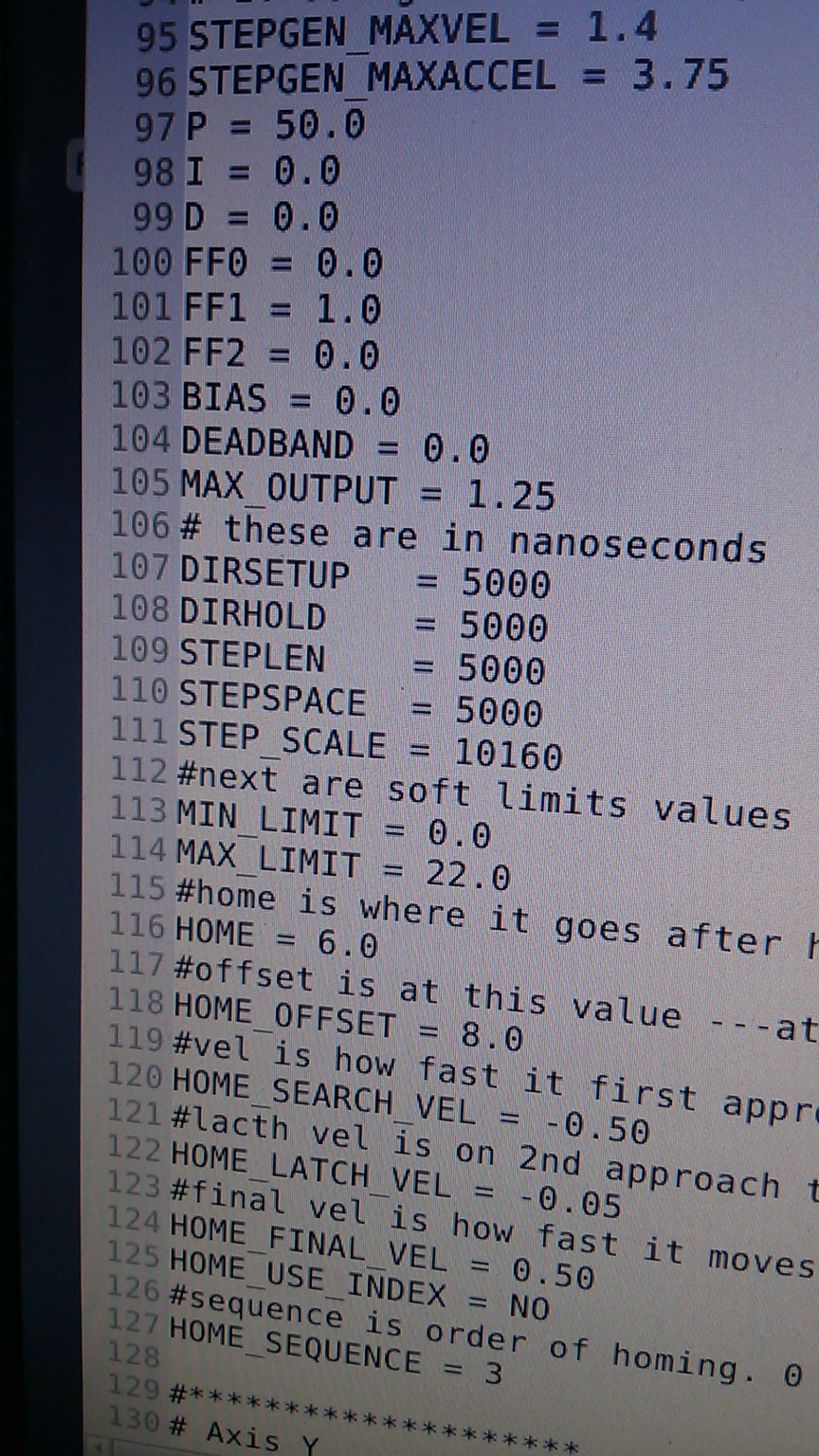

Mr JT, ok, thanks I tried it just as you say. I set home offset to 1.0 and home to 0.0
I think it is a bug in my head or a bug in this cnc.
Doing as you say, it seeks HM then stop at HOME = 0. Cannot violate min soft limit of zero for left end or error popup.
For doing as you say then dotted red box show machine limits decrease size to HM -1.0 make it too small, loses travel area.
Then I try many many combo of numbers in HOME and OFFSET parms.
0,1 or 0,-1 or -1,0 or 8,6 or 6,8 or 8,0 or 0,8 or 2,0 >>> etc. >>> systematic testing
IT NEVER RESPECT HOME VALUE. It always goes to zero after finds HM switch. Only difference is with HOME value determines where dotted red box is cut off smaller.
I also changes SEARCH_VEL and LATCH_VEL to both positive and tried homing from about 4" position. It worked ok hunt to right but same end results. IT NEVER RESPECT HOME VALUE. It always goes to zero after finds HM switch.
I see that this is never noticed if HM switch is same as LIMIT switch and shared same for both purpose. But it looks for me like it is not what is said in linuxcnc.org/docs/2.7/html/config/ini-homing.html but then I must be reading something wrong.
I want to home from about middle of X (say 12" position) and goes left toward HM. This HM switch about 8" from left limit (aka zero). Then after HM is located precise then go to 6.0" and stop. And soft limit should still be 6 more inch left of where it stopped.

I have correct ini I'm edit cause every time I edit it then run LinuxCNC then those edit takes effect. Besides, only 1 ini file. Top of windows says 2.7.4 so that looks right. I updated it last week.
I no doubt what you said about your machine. But it is not agreed with linuxcnc.org/docs/2.7/html/config/ini-homing.html cause it says like this paste here:
3.6. HOME_OFFSET
Contains the location of the home switch or index pulse, in joint coordinates. It can also be treated as the distance between the point where the switch or index pulse is latched and the zero point of the joint. After detecting the index pulse, LinuxCNC sets the joint coordinate of the current point to HOME_OFFSET. The default value is zero.
3.7. HOME
The position that the joint will go to upon completion of the homing sequence. After detecting the home switch or home switch then index pulse (depending on configuation), and setting the coordinate of that point to HOME_OFFSET, LinuxCNC makes a move to HOME as the final step of the homing process. The default value is zero. Note that even if this parameter is the same as HOME_OFFSET, the joint will slightly overshoot the latched position as it stops. Therefore there will always be a small move at this time (unless HOME_SEARCH_VEL is zero, and the entire search/latch stage was skipped). This final move will be made at the joint’s maximum velocity unless HOME_FINAL has been set.
Note
The distinction between home_offset and home is that home_offset first establishes the scale location on the machine by applying the home_offset value to the location where home was found, and then home says where the joint should move to on that scale.]
And my Home switch is not sharing with my neg limit.
So, the start part of homing work exactly according to manual. Works good all the way up to point when DRO is set = to HOME value (like 8.0 for mine). After that it is supposed to go at FINAL_VEL to the HOME position (like 6.0) for me.
I think the cnc software is not correct for HM switch in mid area of travel. It disrespect HOME always !
But maybe I read it wrong. That what I am needing to know: Should I experiment and see what is happens and try to work around a bug or should I believe the manual at linuxcnc.org/docs/2.7/html/config/ini-homing.html and I am reading it wrong?
thank you sir,

- Alicee
- Posts: 22
24 Apr 2016 23:13 #73825
by Alicee
Replied by Alicee on topic after home it goes past offset toward 0
Hi Mr JT and thanks your helping very much.
I know I am somewhat unbelievable cause this machine is doing not right yet. But I made a video so you can see it.
see attach (u can del ".clp" to play as mp4)
Thanks for looking!
Thanks for looking!

- Alicee
- Posts: 22
24 Apr 2016 23:49 #73828
by Alicee
hehehehe
I guess I need expectation adjustment. LOL. Did you see video?
I try many things with ini settings. I try every combo. It always goes to zero AFTER proper setting offset in DRO.
It always does initial hunting, back off, slow hunt, set DRO, then go to zero (I said disrespect HOME always).
I also try "-not" in hal but that made worse, now it is not "-not".
what is your expert opinion what should do now?
Thanks,
Alice

- Todd Zuercher
- Posts: 4786
- Thank you received: 1476
26 Apr 2016 12:28 - 26 Apr 2016 12:30 #73896
Replied by Todd Zuercher on topic after home it goes past offset toward 0
I think I might see your problem. If the ini file you posted further up is still the one that you are working with, the problem is that you have 2 HOME= entries in each axis section. The first "HOME = 0.0" in each section is the one that is obeyed the second (the one you are trying to use) is then ignored. If you delete the extra HOME = 0.0 it should work for you.
# Axis X
[AXIS_0]
TYPE = LINEAR
HOME = 0.0 (DELETE THIS LINE AND ALL SHOULD BE FINE)
FERROR = 0.5
MIN_FERROR = 0.05
#next is in machine units per second
MAX_VELOCITY = 1.2
MAX_ACCELERATION = 3
STEPGEN_MAXVEL = 1.4
STEPGEN_MAXACCEL = 3.75
P = 50.0
I = 0.0
D = 0.0
FF0 = 0.0
FF1 = 1.0
FF2 = 0.0
BIAS = 0.0
DEADBAND = 0.0
MAX_OUTPUT = 1.25
# these are in nanoseconds
DIRSETUP = 5000
DIRHOLD = 5000
STEPLEN = 5000
STEPSPACE = 5000
STEP_SCALE = 10160
#next are soft limits values
MIN_LIMIT = 0.0
MAX_LIMIT = 22.0
#home is where it goes after homed to HOME sw position
HOME = 6.0
#offset is at this value ---at home pos this is put into DRO
HOME_OFFSET = 8.0
#vel is how fast it first approach the switch, hunting, - is neg direction + is pos
HOME_SEARCH_VEL = -0.30
#lacth vel is on 2nd approach to sw position
HOME_LATCH_VEL = -0.04
#final vel is how fast it moves AFTER it is homed and going to offset, 0=maxvel
HOME_FINAL_VEL = 0.50
HOME_USE_INDEX = NO
#sequence is order of homing. 0 is first. Simultaneous if same number. -1 = don't do
HOME_SEQUENCE = 3
Last edit: 26 Apr 2016 12:30 by Todd Zuercher.
The following user(s) said Thank You: BigJohnT, Alicee
