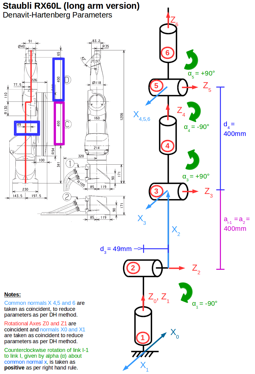

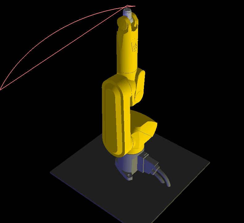

Based on the puma560 files, I've built a custom vismach model of a staubli RX60L (long arm version) and got it working in preview:
What I am trying to do:
I want to get the axis movements, XYZABC, to work, but I can only use jog. Eventually I want to run a simple gcode program such as the stock milling one.
What is going wrong?
I am getting an error in terminal when trying to home the machine which reads:
The program does not exit and I am able to resume using 'jog' in joint mode. Nothing is returned in dmesg.
A small message displays in axis saying 'kinematics Inverse Failed'
What have I done to try and fix the problem?
I note that this error appears to relate to matrix operations in gomath.c, called from genserkins.c, and the former of which return the GO_RESULT_ERROR if they fail, triggering the error from genserkins.c in the terminal:

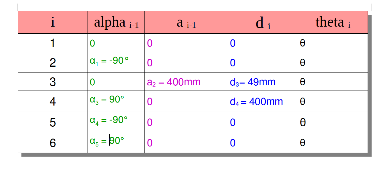

I have updated generkins.h, the hal file and the ini file with the parameters as I believe them to be correct, taking data from the manual and from a DH parameter analysis I have carried out (attached). I have recompiled my RIP install with the new versions (I did not run sudo make install however, its just at "make" level)
[Note: The DH params below are slightly different than in some onlinestudies, which refer to the short arm and where the zero position of the arm is horizontal rather than vertical.
These are my new genserkins defaults:
.......Followed by the halfile params (I experimented with alternate angular units to no avail):
What code am I using?
I have attached genserkins.h, the new staubli gui file (zipped to get around file extension requirement), and the updated ini and hal files.
What help would I like?
My skill level: Intermediate python and c++, new to linuxcnc

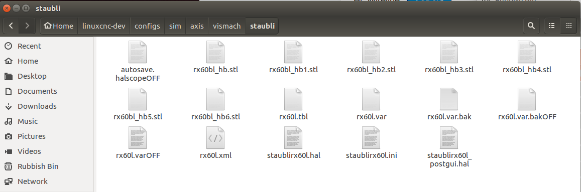

I seem to have come up against a brick wall with fixing this one. I believe my DH params are correct and have checked my files for errors, but cannot see where the problem might be. Can anyone suggest where to start looking? Am I just missing a step? Here is the contents of my vismach folder:
#define DEFAULT_A1 0
#define DEFAULT_ALPHA1 0
#define DEFAULT_D1 0
#define DEFAULT_A2 0
#define DEFAULT_ALPHA2 -PI_2
#define DEFAULT_D2 0
#define DEFAULT_A3 400
#define DEFAULT_ALPHA3 0
#define DEFAULT_D3 49
#define DEFAULT_A4 0
#define DEFAULT_ALPHA4 PI_2
#define DEFAULT_D4 400
#define DEFAULT_A5 0
#define DEFAULT_ALPHA5 -PI_2
#define DEFAULT_D5 0
#define DEFAULT_A6 0
#define DEFAULT_ALPHA6 PI_2
#define DEFAULT_D6 0.......Followed by the halfile params (I experimented with alternate angular units to no avail):

OK some progress. I changed the home values in the ini file to 5 arbitrarily for each joint, and now I do not get kinematics failures when homing, but I do when trying to move in the X Y Z A B or C axes. There seems to be something off with where axis believes the joints to be. Moving in X briefly worked, but immediately said it had hit a soft limit. The rotation gauge jumped from its home zero point right to its limit, which makes me think I missed something in setting up the joints.
I also modified the DH params too and included d6 = 105, to include the distance from joint 5 to tool tip. I added a 40mm long tool.
EDIT: OK I am starting to suspect I have used an inappropriate DH convention. I recall reading somewhere that a specific convention was used in genserkins, I will have to look the book up (or just bodge it!). Its proving a tough nut to crack, but I am using the absolute world position numbers as a guide as to where things might be wrong. It seems there is an erroneous 90 degree offset to joints 2 and 3, however reversing their direction or setting them to zero does not seem to help.
Is there a way to view the actual kinematic model, rather than the vismach one?
