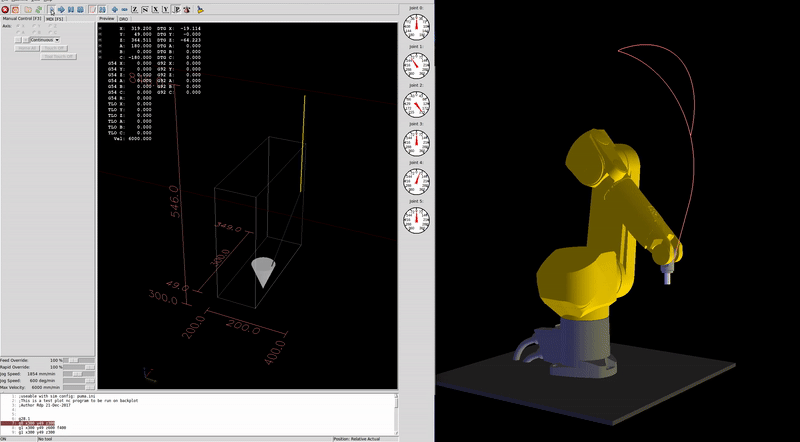

08 May 2018 05:11 #110371 by Wireline
Replied by Wireline on topic Genserkins failure with custom robot
Resolved

08 May 2018 15:40 #110398 by tommylight
Replied by tommylight on topic Genserkins failure with custom robot
Looking nice !
08 May 2018 16:16 #110400 by chimeno
Replied by chimeno on topic Genserkins failure with custom robot
Hello WireLine,
very good!!
regards
Chimeno

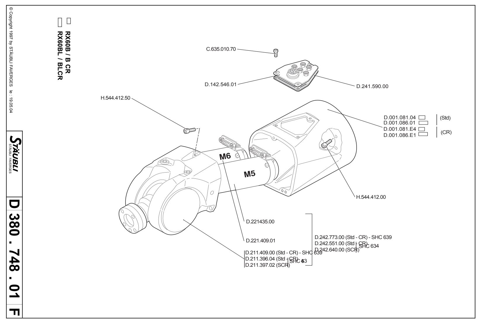

09 May 2018 18:24 #110470 by andypugh
Replied by andypugh on topic Genserkins failure with custom robot
Does that Staubli have the end-effector that needs two motors to work in combination?

10 May 2018 09:08 - 10 May 2018 10:45 #110513 by Wireline
Hi Andy,
Good question, I am not sure. Its the RX60BL that used to be at the London Hackspace, I heard mention that you had contact with some of their members :)
Is this likely to cause a problem with the kinematics?
EDIT:
This is an exploded section of the arm. The end effector as far as I know is pneumatically operated, e.g. for a gripper. There are two motors each controlling joints 5 and 6.
Last edit: 10 May 2018 10:45 by Wireline.

14 May 2018 15:01 - 14 May 2018 15:17 #110738 by Grotius
Replied by Grotius on topic Genserkins failure with custom robot
Hi Wireline,
Nice work!!
It is good to see this very impressive gif animation.
For future development I issue a custom robot screen design, separate of the axis screen.
This would bring so much more user interface possebilities, and it is simple after one year of study !!
Try also external offsets and adaptive speed. For robot's it's really fun. If you have distance sensor on the gripper, you can let the robot move with external offset's from his program path and go back to it. Just like table tennis. Really amazing to see this. With laser you can use the external offsets to follow the welding path. Valk Welding does this with panasonic robot's. I worked over there years ago.
Is it possible to make a short tutorial how to make a vismach working model and how to load it into linuxcnc?
Maybe a few links, wich 3d file format to import, etc. The important issue's.
This can save other's much time.
I like to try a plasma gantry model in vismach. But i have also a seperate external rotary axis. Is it possible to make this in vismach?
