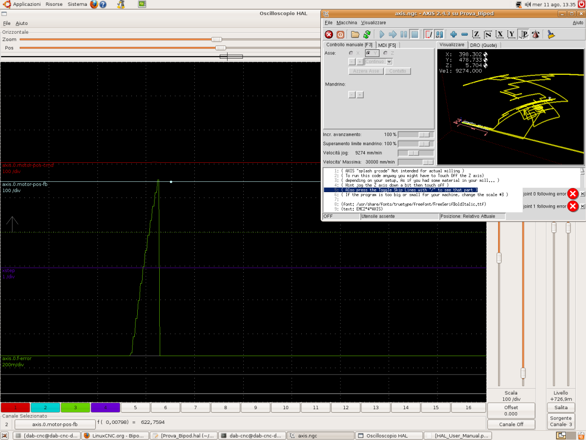

11 Aug 2010 11:42 - 11 Aug 2010 11:43 #3692 by dab77
Replied by dab77 on topic Re:Bipod setup
The img i attached is a screenshot with halscope triggering axis.0.ferror.
channels motor-pos-cmd and motor-pos-fb have the same scale, so i think is the result of what you suggested.
what do you think?
...and thanks for your time and interest..
Last edit: 11 Aug 2010 11:43 by dab77.
11 Aug 2010 11:56 #3693 by andypugh
Replied by andypugh on topic Re:Bipod setup
It is a bit difficult to see what is happening there because the scales are so big for the cmd and fb channels.
You can apply an offset to the -cmd and -fb channels (the button at the bottom of the scale slider) which will then let you decrease the scale while keeping the traces on the screen.
However, I think I can see a change in the -cmd value, but not in the -fb value..
11 Aug 2010 12:21 #3696 by dab77
better?
11 Aug 2010 13:29 #3698 by andypugh
At a guess, I would say that STEPGEN_MAXACCEL is much lower then MAX_ACCEL in the INI file. Basically the stepgen is not keeping up with the command.
This is nothing to do with the kinematics module. (but to test that you should perhaps re-test with the original, unmodified trivkins kinematics module, if you still have it)
Another possibility is that the combination of base-period length, step-per rev and axis-scale is much lower than the max velocity of the axes.
11 Aug 2010 13:31 #3699 by dab77
ok..
kind of my newbie fault. :blush:
with a very low speed it works!
before i left for each motor a good speed, which was 600mm/s.
i had to set it to 50mm/s to make it work without errors...
now i have a big noise coming from my motors (nema23-3A...chinese...)with low speed, but i'm going to play a bit with microstepping. now working with 1/2.
thanks again!
if you have any other suggestions, you're welcome!
cheers, dab.
