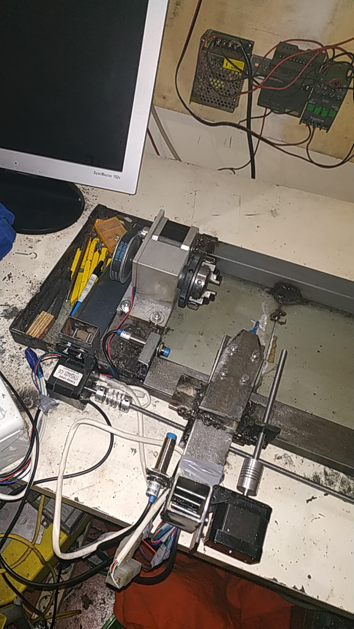

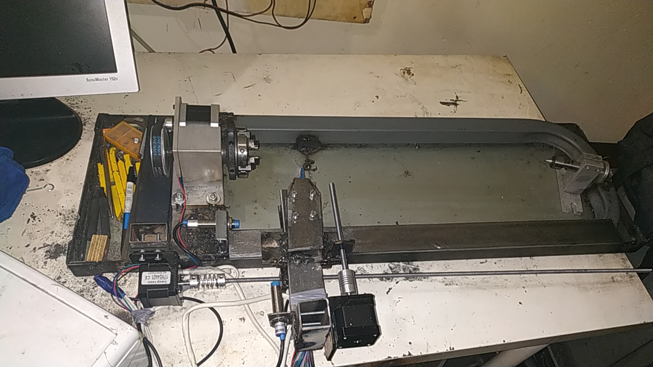

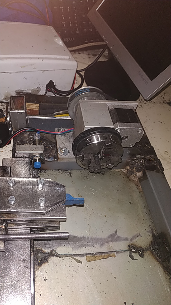

hi frends
I have built a lathe with 3 axis as usual but the axis are moved with 3 steppers, first attempt was with grbl ant that doesn't work maybe i need to reprogram but i can't program this is so difficult for me and now I'm trying to configure with linux cnc but in the manual lathes are sincronized with encoder i wish to configure with steppers.
Is it possible?
How can I do it?

You will have to give us more info or pictures of what you are trying to do, that translation is not ok.
Why 3 steppers on a lathe ?
Linuxcnc is not Linux with GRBL!

I don't think that LinuxCNC knows how to configure a stepper spindle (I could be wrong).
So as a first step use the stepconf wizard to configure for a normal 2-axis lathe, and get the X and Z axis moving.
Once that is working you can start to manually edit the HAL file to add the spindle stepper.

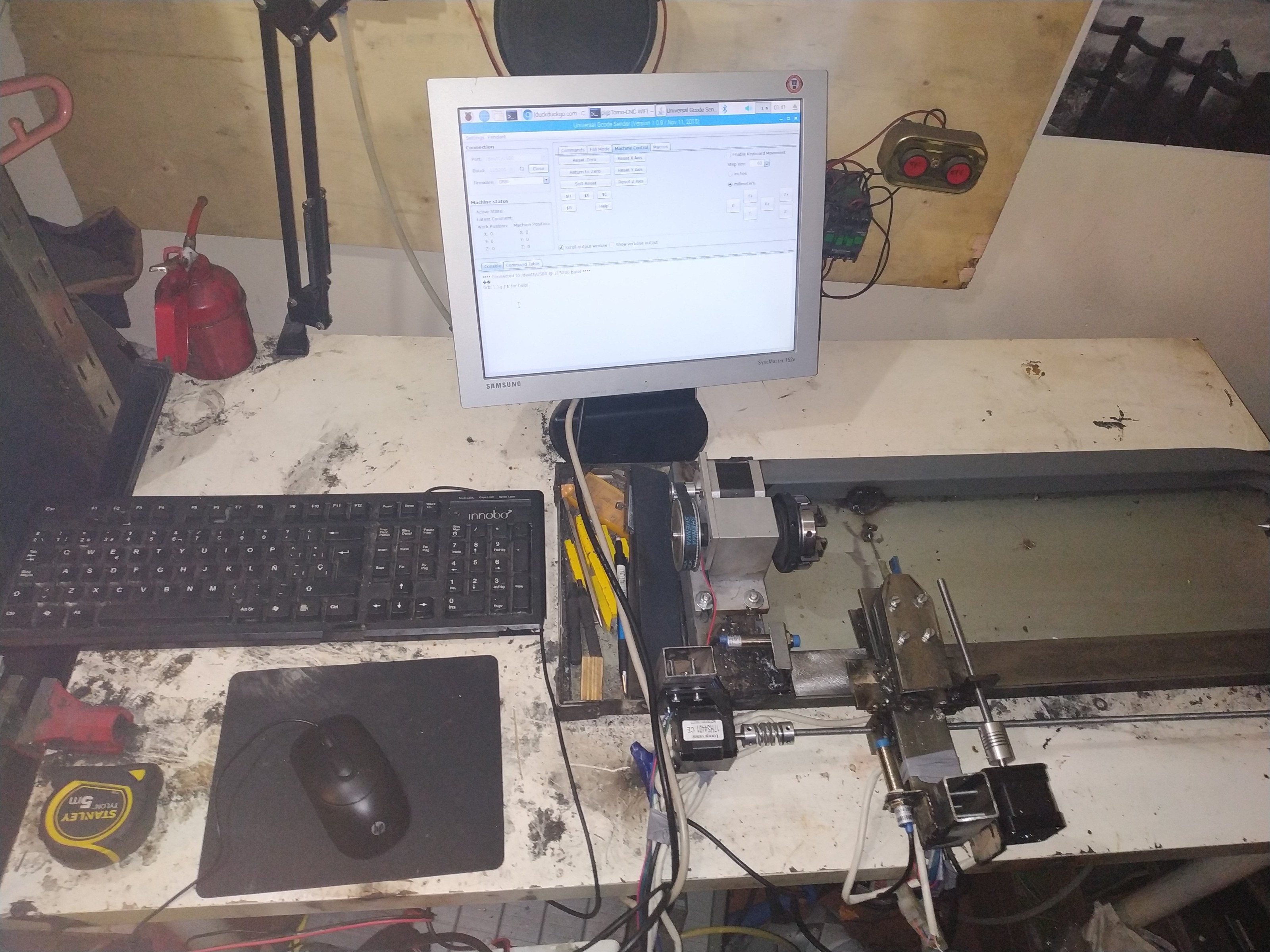

I've been working a lot finally I can move the 3 steppers with xyza configuration but "y" is useless but I can't copy the configuration of "a" axis to hal in lathe x,z configuration and returns error codes:
[axis_1]scale' not found
5425
Stopping
5425
Stopping

Is this a request for help?
Than we need your lcnc version and your configuration.
