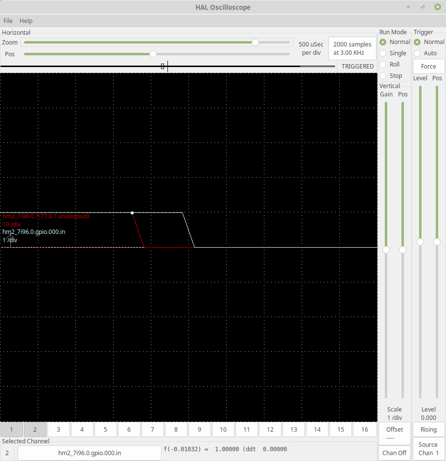

28 Jan 2021 17:30 #196974
Replied by PCW on topic Setting Servo Max Acceleration
Here is a halscope plot of a 7I77 analog output driving a isolated input
(10V analog out driving input with ~5V threshold):
Note that about 1/2 of the total roughly 666 usec delay
is the 1 servo period pipeline delay (333 usec in this case)
due to the analog write being done at the end of one servo
thread invocation and the GPIO read being done at the
beginning of the next servo thread invocation.
This shows that the delay from LinuxCNC write to
analog output is in the region of 333 usec.
The one servo-thread period pipeline delay
is compensated in the PID via the
"pid.N.error-previous-target" bit being set true.

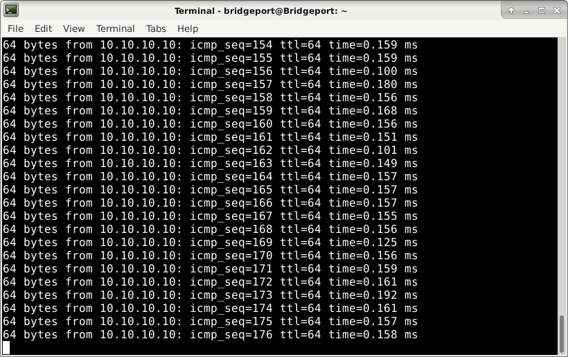

09 Feb 2021 17:41 #198169
by Michael
Replied by Michael on topic Setting Servo Max Acceleration
Before I ditch using these servos in analog mode altogether I wanted to check these ping times are accurate. The very first ping was .310ms and then there are a couple intermittent ones that approach .200ms but for the most part are around .150ms. Any thoughts on these times or ways to improve them if we can?
- Posts: 18111
- Thank you received: 5330
09 Feb 2021 18:19 - 09 Feb 2021 18:22 #198173
The first ping will tend to be longer because the ARP cache data will have expired
and a ARP transaction will be needed before the first ICMP echo request (ping) can proceed.
(the driver disables ARP while running)
As long as the servo thread can run without violating real time constraints the actual timing
is not terribly important, as sampling events (such as reading the encoders or stepgens
position) that affect motion can be re-timed by the DPLL
Last edit: 09 Feb 2021 18:22 by PCW.

09 Feb 2021 18:30 #198175
by Michael
I did try and play with the DPLL and encoder timing in a few different ways and only managed to make things worse. This included the encoder sample frequency filter between true and false, none of which shortened the delay time.
Short of a "real oscilloscope" reading on the drives analog input and encoder output, the manufacturer won't acknowledge that the drive response is the issue. I don't have an oscilloscope.

09 Feb 2021 18:48 #198177
The DPLL does not shorten the delay time, it just reduces the uncertainly in the sampling time.
Note that my plot shows ~666 usec delay from commanded analog out to detected read data
and as I explained, because of the:
1. Read (encoders)
2. Process data
3 Write (Analog)
4. Wait until next servo thread invocation (step 1)
ordering of operations, about 1/2 of this 666 usec delay is inherent in LinuxCNCs
read. process, write operational sequence. So our hardware /LinuxCNC/Host Ethernet
overhead is only responsible for at most a few 100 usec of delay. The rest is in the drive.
1. Read (encoders)
2. Process data
3 Write (Analog)
