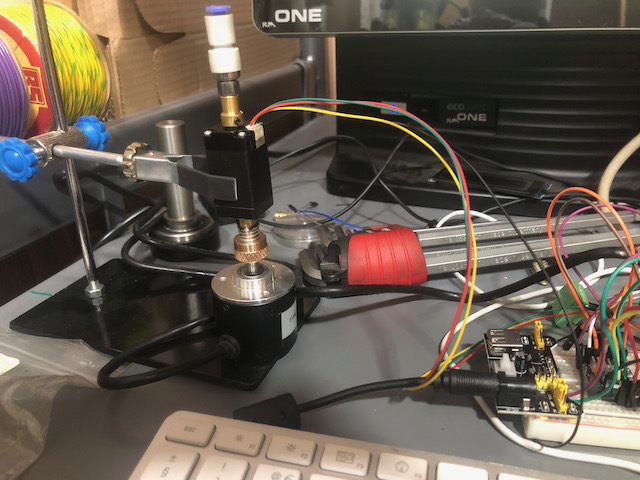

I made a stepper-encoder spindle simulator to check this with:

Neat test setup!
I got the component compiled ok.
