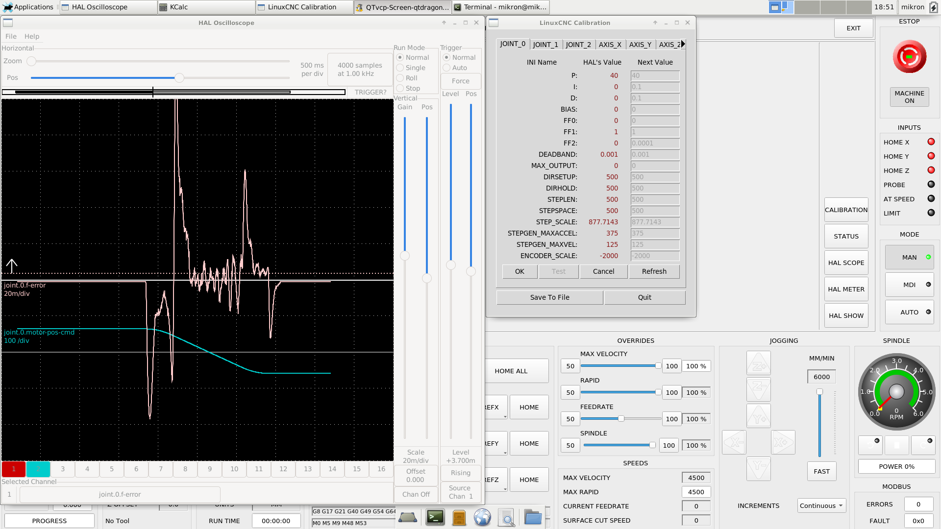

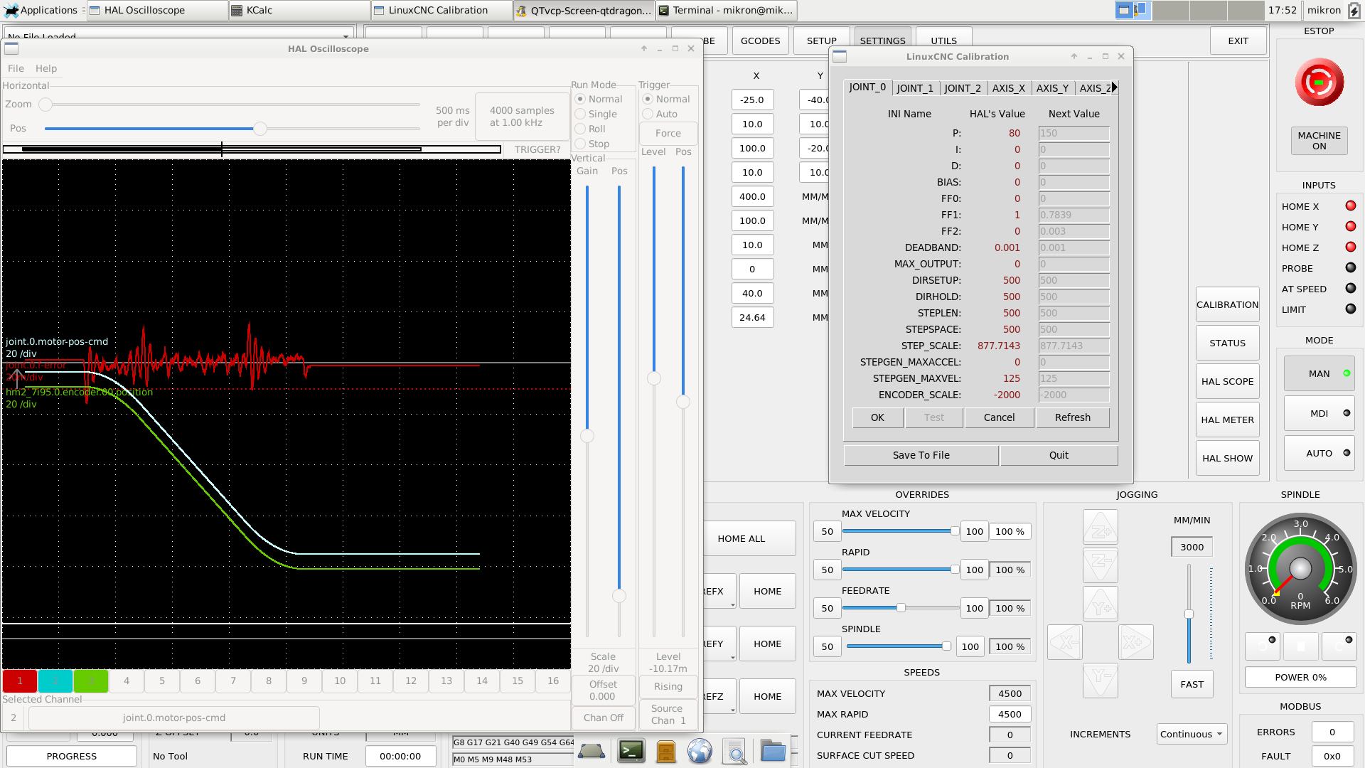

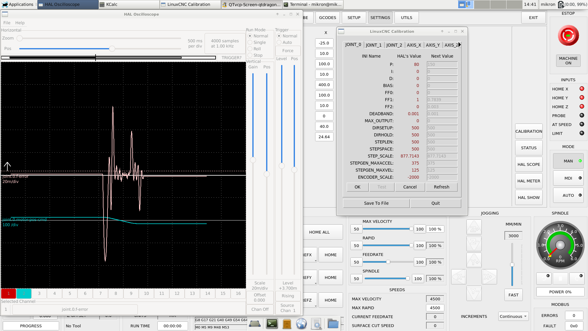

Hi guys I need another rescue mission from you all big servo tuning brains.
I have spent whole day reading all the tuning guides in here ant trying and trying and I can only make it worse but not better.
attached are two pics of one with p40 and one with p80 and my ini file.
I have tried to tune P until it oscillates with all other at 0 then tuning ff1
then I tried ff1 at 1 all other 0 then tuning P
and many other combinations but my brain is about to explode and have no luck at all getting it better.
Can someone guide me in my struggle please?

Given that this is a metric machine 20m / div your peak error is about 0.08mm (or What is the machine? That isn't great for a lathe, but might be OK for a wood router.
Try the P=80 with D=0, is it better or worse? 0.1 feels a bit high.
Is the pid.N.eedback-deriv pin connected in the HAL? It looks like the machine might be over-reacting to encoder velocity noise.
Steady-state error looks excellent.

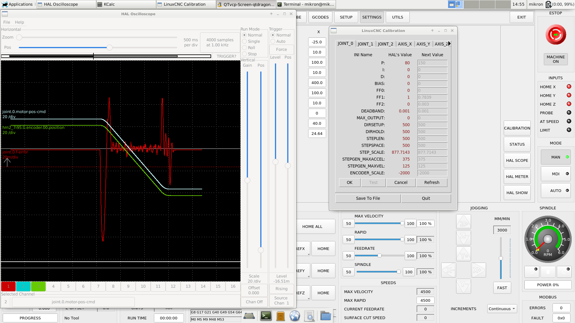

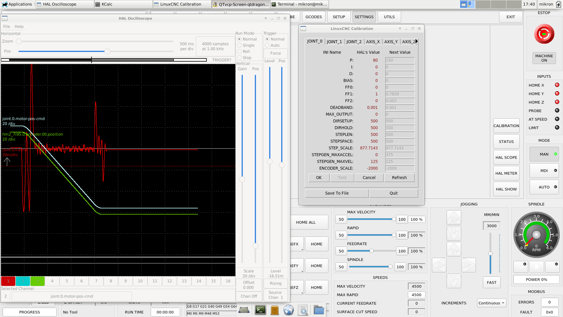

I tried P=80 D=0 and everything else 0 picture attached.
Attached is screenshot of the same settings but motor cmd and encoder pos and they both seem to match when overlayed so why is the error all over the joint?
The thing is I can not find the pid.N.feedback-deriv pin connected. How should I connect it and what is it going to do for me?
I have attached my hal as well.

It's only bad as the axis first starts moving. (And bear in mind that this is an error _along_ the path, so will have much less effect on part geometry than an error perpendicular to the path.)
To try to improve this:
In this section
try adding
This should help FF1 to be a bit more accurate.
You could also experiment with setting the STEPGEN_MAXACCEL to zero (unlimited) as there isn't a physical stepper motor to worry about.
It might also be interesting to see what happens if you reduce the MAXACCEL of the joint itself. (you probably don't want to keep it that way, but just to see what happens)
In this section
net x-index-enable <=> pid.x.index-enable
net x-enable => pid.x.enable
net x-pos-cmd => pid.x.command
net x-pos-fb => pid.x.feedback
net x-output <= pid.x.outputtry adding
net x-vel-cmd pid.N.command-derivThis should help FF1 to be a bit more accurate.

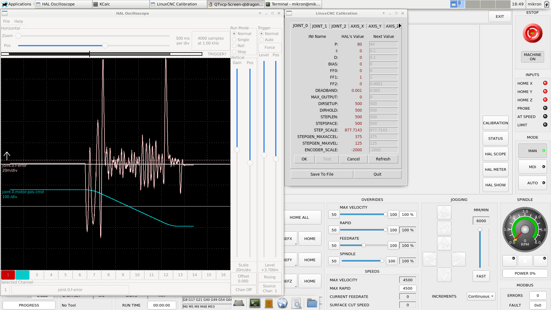

Right with the deriv connected I get the attached curve.
will play with maxaccel in a minute

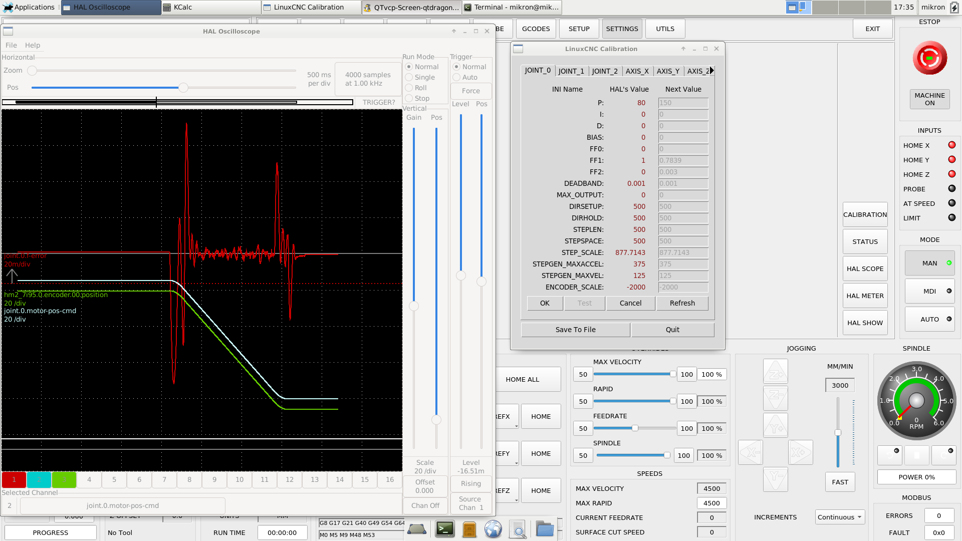

Stepgen maxaccel at 0
- Posts: 19899
07 Apr 2022 15:58 #239558
Replied by andypugh on topic Another servo tuning
Does changing the FF1 value affect the initial deviation when movement starts?
I would concentrate on just that for the moment, try increasing and decreasing FF1 and FF2 (one at a time) and also try changing D (try 0.0001, 0.001, 0.01) and try to get a feel for what changes.

an if I drop the axis accel to 100 I have been machining with this setting and the results were seriously good.
but I would like to bump up the max speed and acceleration a bit if we could figure out what is going on.
thanks
thanks
