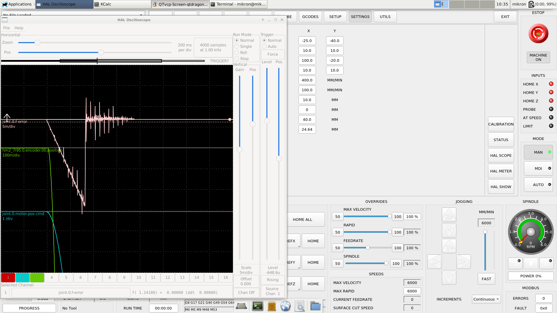

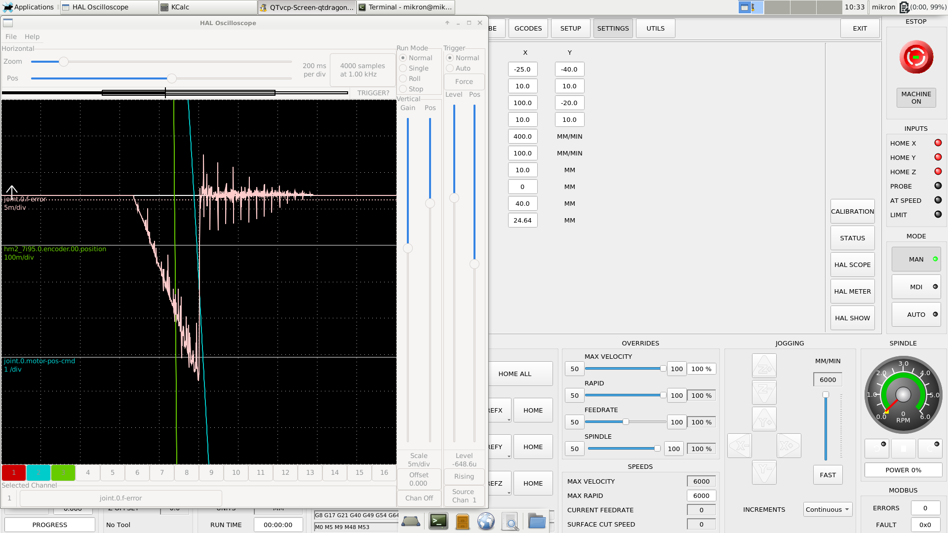

12 Apr 2022 10:00 #240052 by myval
Replied by myval on topic Another servo tuning
Spikiness zoomed in. Where does it come from?
12 Apr 2022 10:16 #240055 by andypugh
Replied by andypugh on topic Another servo tuning
I set it in position control without pid , motor-pos-cmd => stepgen.position-cmd
just get this massive ferror spike but it runs ok.
I am not sure that I believe those plots, I don't see how f-error can change that instantaneously.

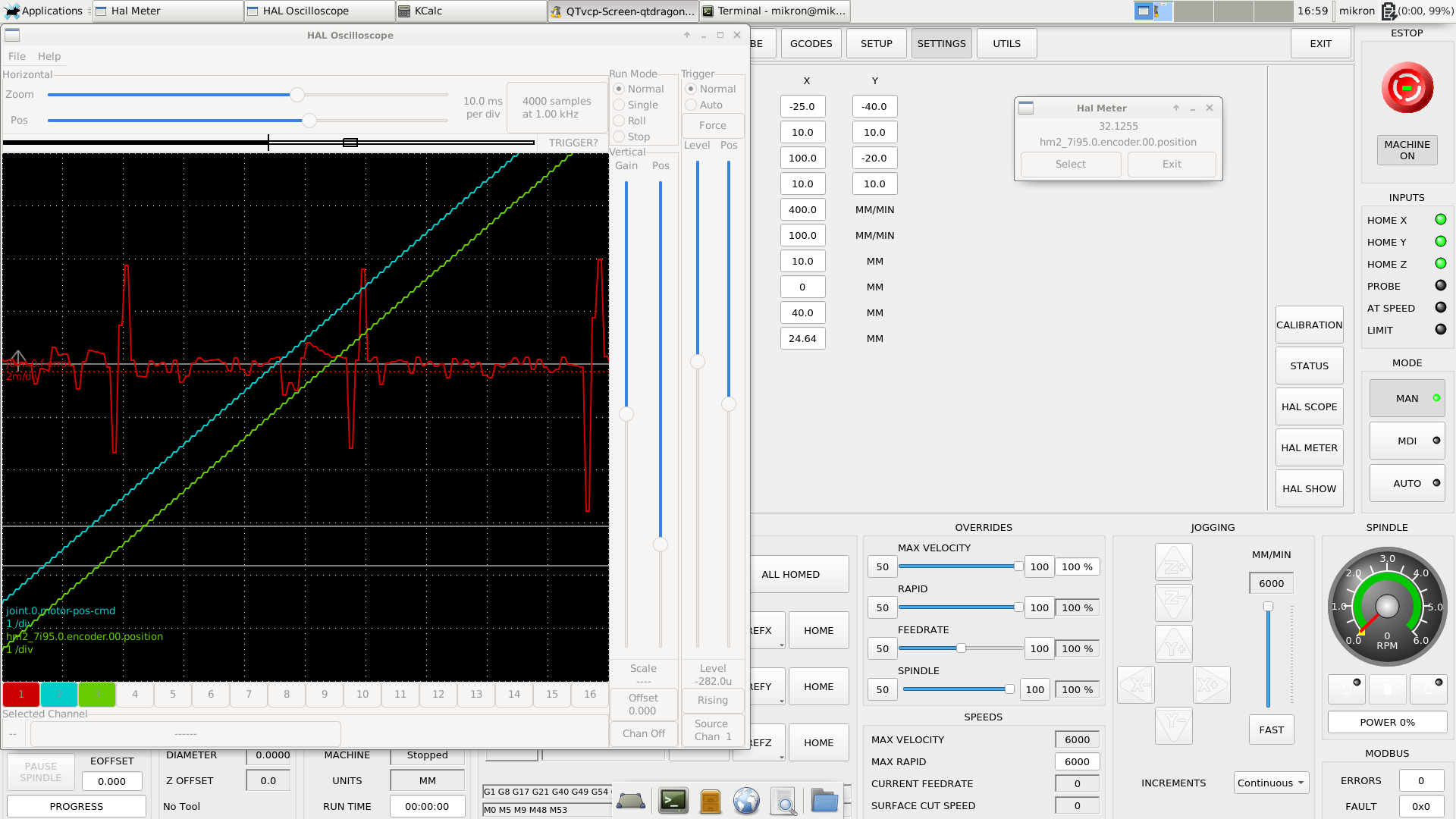

14 Apr 2022 09:25 #240235 by myval
Well I just discovered that he f-error spikes must come from linuxcnc / mesa since in open loop
this is input into f-error calculation instead of encoder
net    x-pos-fb    <=    hm2_7i95.0.stepgen.00.position-fb
net    x-pos-fb    =>    joint.0.motor-pos-fb
and I am guessing it will be the other input into the f-error calculation so the motor pos cmd? I dont know the inside of the system so it is my guess only but process of elimination.
is some wrong mesa setting? or is it linux cnc setting? computer problems?
don't tell me that I am the only one in the world with this problem?
19 Apr 2022 16:42 #240687 by andypugh
It is possible that these spikes are happening every servo period, and correspond to the position error due to the servo thread latency.
(Though it would have to be an aliasing problem, as there are 200 servo periods per square on the time axis)
You could switch to the approach commonly used with the Mesa stepgens of running them in velocity mode with a PID component. You then run a fixed P of 1000 and FF1 of 1.0 and the servo thread jitter is accounted for a little better.
But: Do you still have encoders? What do you see if you use those for feedback?
