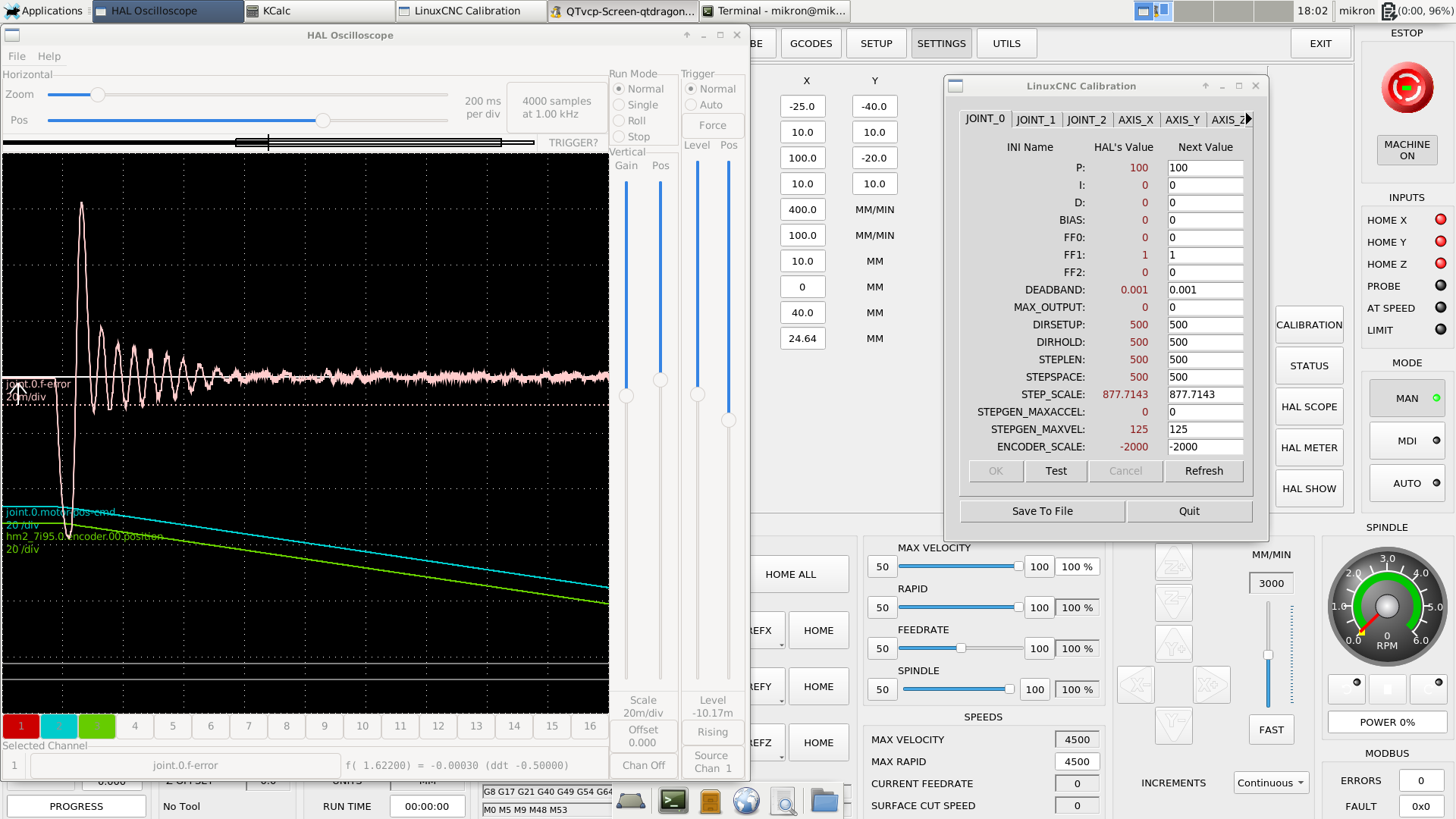

Just to make life easier we had massive storm and power outage. It never ends.
I have tried increasing decreasing FF1 and FF2 and 1 and 0 is about as good as it gets with changing D I can only make it worse.
I am wondering if it is not some kind of system noise because it is very squigly while it is on in steady motion. Could there be a problem with the motor driver? I am feeding it step dir instead the usual +-10v
This is just a thought I am guessing that Peter could shine some light on this.
Would it be better if I reconfigure drives for lets say PWM dir?
I could not use the original Bosch servo drives and the first try was with small cheap drivers which ony had Step Dir but the new once I have can be set into different types of inputs.
I have drives set in position control too.
Could any of these cause these issues?
correction: can only set it to PWM 50% zero set point not PWM dir

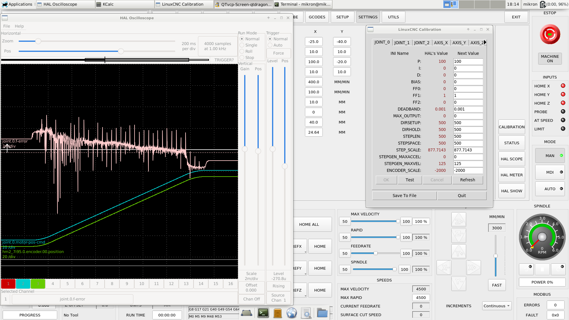

So this is what happens if I bump up accel to 300 and limit the speed to 16 m/min in hal

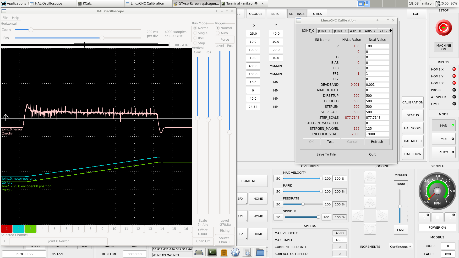

here is the openloop net x-pos-fb <= hm2_7i95.0.stepgen.00.position-fb
but I don't know how the ferror is calculated in this case I had to decrease scale it 2m now otherwise I could not trigger.
Edit: I forgot to bump up the max speed again
is there any way to reload HAL without closing and opening whole thing again?

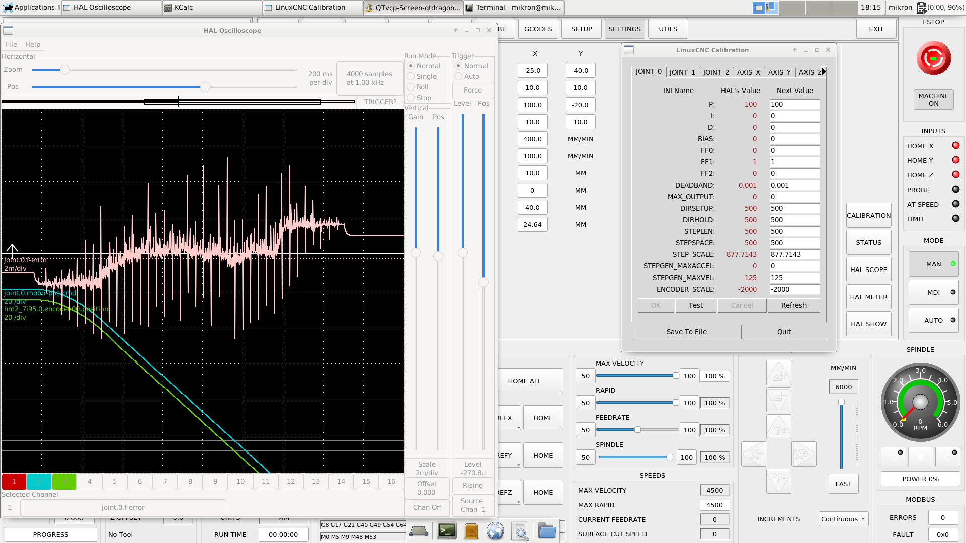

and open loop with
MAX_VELOCITY = 100.0
MAX_ACCELERATION = 300.0
at 3000mm/s and 6000mm/s
now since I don't know where the ferror comes from in this case I kind of have no idea what this measurement tells me. I guess I would be happy if this was actual encoder to cmd difference.
