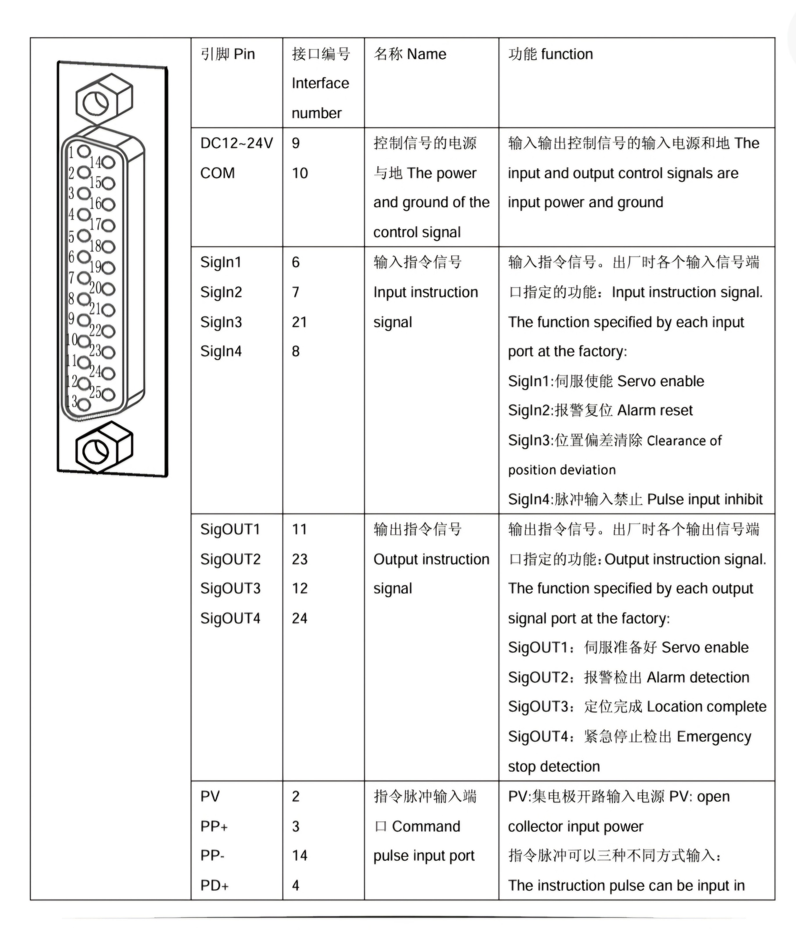

cofhal - I will look at your files now, I did have another idea as well - could i simply use two stepgens? one for step.dir for spindle and another one for the "C" axis? and have a mesa output pin switch a dpdr relay to simply alter where the same motor gets the input?

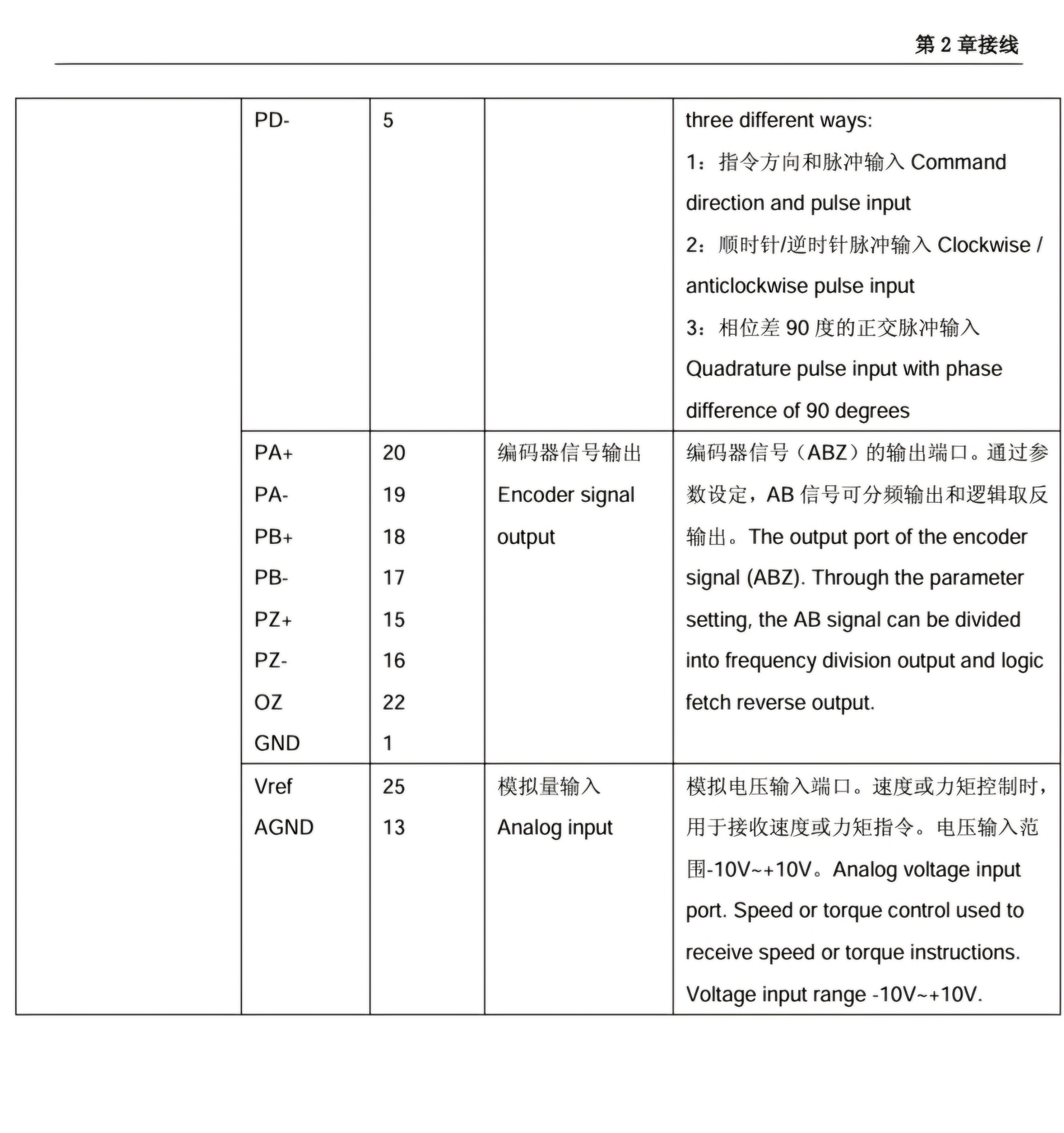

one more question before i forget: what issue could be encountered by having a different model of servo driver? Given that you are driving both the spindle and c-axis both with step/dir signals, you just need a driver that can output step/dir, right?

If I received it, please delete the email address. I have another question: Do you have feedback from the servo motor encoder connected?

EDIT: I double checked and it seems you received my email. I removed your email from my post. I will type out a small part of my email here for other people in the community who might find it useful in the future.
Part of email:
Importantly, I have an external encoder that is already attached to the lathe headstock, so I DO NOT need to use the encoder on the servo driver, infact, I already have the encoder set up correctly to my mesa board. In a future project I may use the servo encoder but i suspect my drive does not actually have encoder output setup as the manual says not all versions come standard, and i have no connector (although it must be somewhere inside haha)
