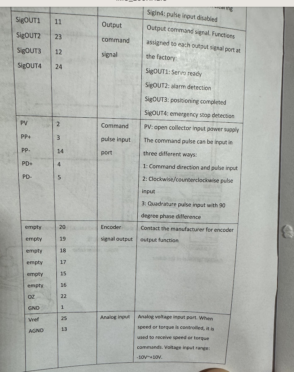

05 Apr 2025 12:15 - 05 Apr 2025 12:24 #325771
by ffffrf
Replied by ffffrf on topic Using a servo as a spindle and positional axis - keep getting vague errors
here is a picture of my physical manual, its slightly different than the online manual. However, do you think it actually does work and this physical copy of the manual is wrong?Also just to clarify - are you also saying that because my current encoder is not 1:1, that it will not work?I can go ahead and try to solder on the wires to my servo driver and test it out
Currently using a 1024 p/r pulley mounted encoder

Also could you explain how your physical setup for homing of the C axis / spindle? It is something I am having trouble with after modifying your HAL and INI (which I will attach here).
