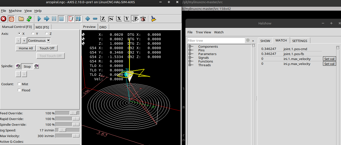

03 Apr 2026 17:39 - 03 Apr 2026 17:44 #345114 by Aciera
Replied by Aciera on topic CSS/G96 for other than X-axis?
Interesting. Just checked on a sim on 2.10pre and setting ini velocities to 0 does not quite work for me. The tool moves to the start of the spiral and then moves back. A bit strange really:
Same on 2.9.8
Last edit: 03 Apr 2026 17:44 by Aciera.
03 Apr 2026 18:30 #345124 by spumco
Replied by spumco on topic CSS/G96 for other than X-axis?
Hmm.  I didn't check on a sim, just my real hardware.
My backplot jumps when I do the switchkins switch, but no amount of fiddling could get the hardware X-axis to move when I had velocity set to zero.
