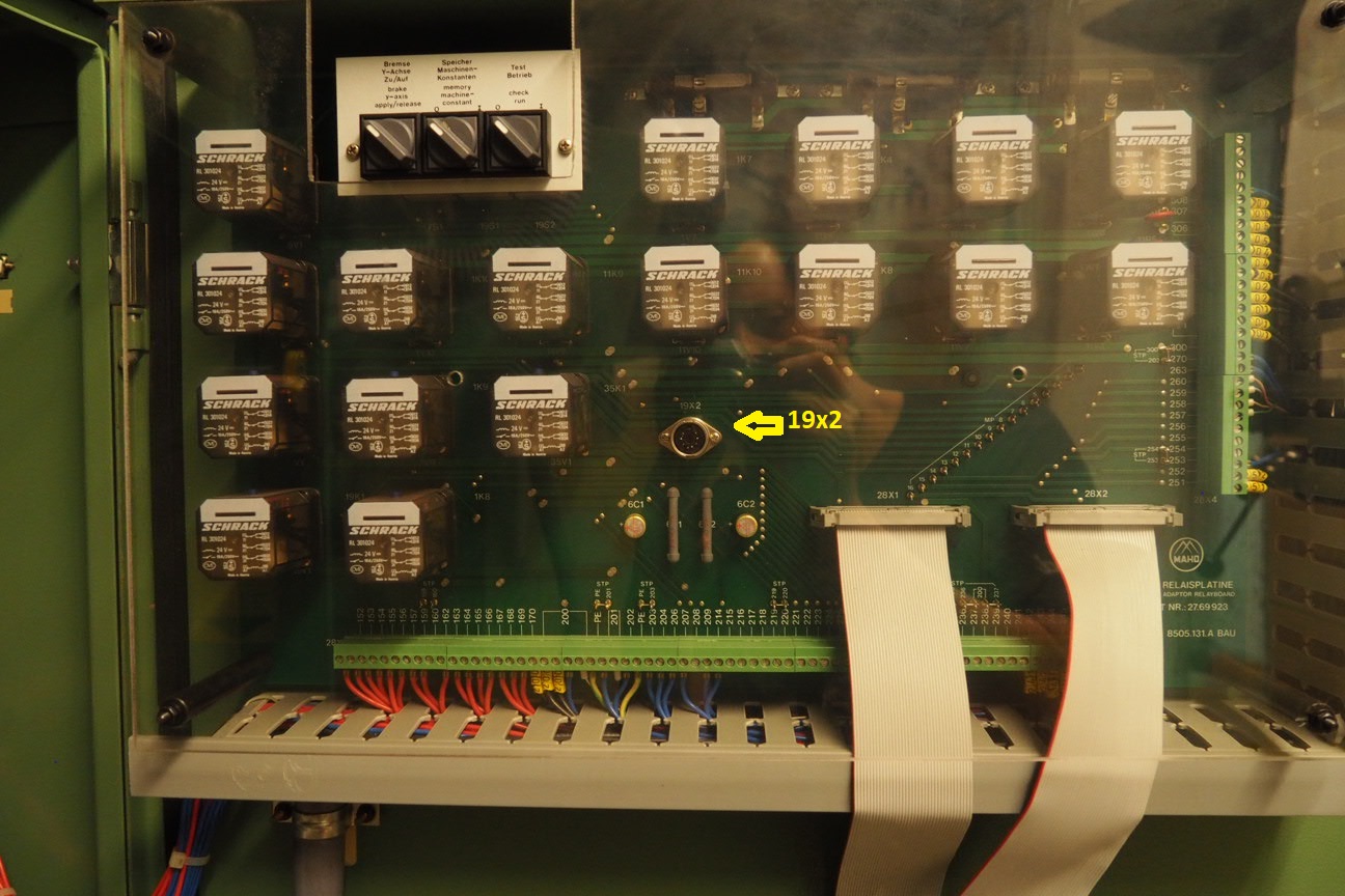

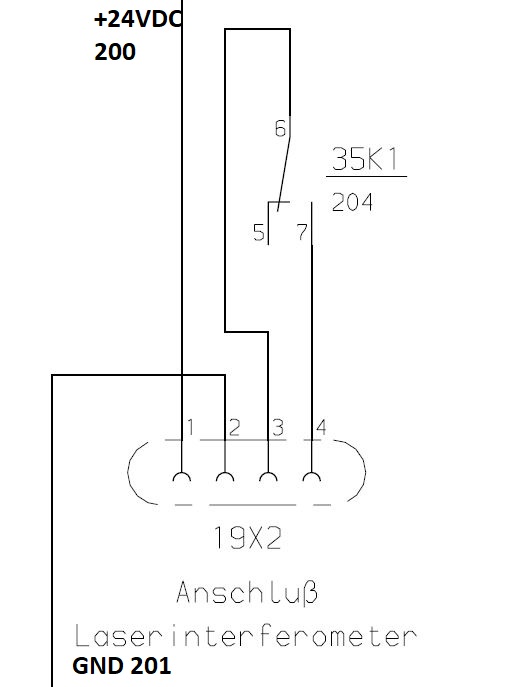

Has anyone figured out what the 19x2 socket is used for , located in center area of large relay board .
Bob
It is for connecting a laser interometer.

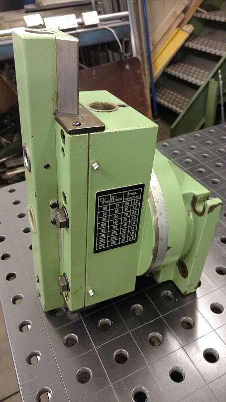

There is slotting head on Ebay Kleinanzeign right now. It looks a little different to mine, maybe it is for a 600? I think I paid €1200 for the 400 sized slotting head and horizontal overarm, both practically unused. The one advertised is"make an offer"..
Any idea what a price range might be for a MH600E slotter head ?
Bob

Laser interferometer , wonder if it was for verifying the cutting tool or part location.
My guess is for cutting tool verification . Maho seemed to be as advanced in technology as some of the other leading machine builders.
The slotting head gray or silver colour looks to me as if it was from the pre CNC machines era .
For some reason I think those were made by some outside company for MAHO . Thanks for the information.

I agree that the hammerschlag paint looks like it is from a manual machine, but the design look otherwise very similar to mine.

Your slotter attachment plate or where it is bolted to the machine ,wonder if all slotters are the same except for the attachment plate ?
Bob

Agreed, it does look they had one design of slotting head and switched out mounting plates to suite.
Mark
