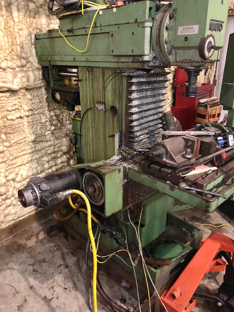

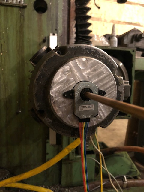

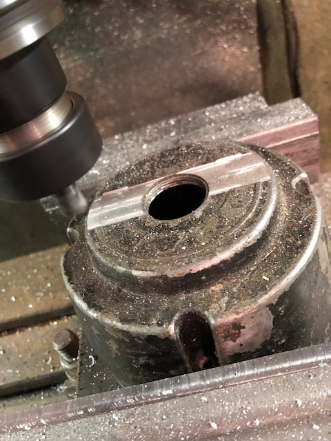

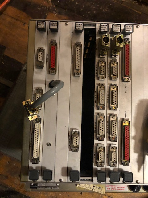

Here is an update on my MAHO project.
First machine being rebuilt is one of the 600E machines. I stripped it down a couple weeks ago after a failed startup. I hooked up the main transformer and found it to be "leaking" voltage through the frame, gave me a nice little zap. Not wanting to chase wires, I removed the controller, box, and transformers. Much smaller machine with all that stuff pulled off.
I machined the servo caps and drilled/tapped the rear of the servo rotor (glad it wasn't hardened) to add encoders. I know this is a Linux CNC forum so forgive me for saying that I tested the setup using Mach3. I wired the x axis to a gecko driver and was able to get the axis traveling accurately.
Christmas left me with an Amazon gift card so I put in an order for a Centroid Acorn. I have one on my lathe and have been very happy with it, really like the ability to rigid tap and the the options built into the board.
Here is my full breakdown if anybody is interested:
Power supply $85-
I'll be using drives that aren't rated for the 170 volts the machine originally used. To power the servos I'll be using a 30amp VARIAC transformer I got off ebay. I have power running through the rectifiers and capacitor the were on the machine.
AMT 102 Encoders $24 each-
These are and easy install and easy to upgrade. I've used them in the past with good results.
Servo Drives-
I'll be using leftover drives from other machine builds. If the DG4S work well, I'll probably buy one more and turn up the voltage of the VARIAC
(1) Gecko 320X $100
(2) DG4S-016035 $160 per drive
Spindle Motor- $100
Bought a used 220v 5hp 3phase motor off ebay.
10HP VFD- $170
Ebay
Controller- $299
Centroid Acorn purchased off Amazon
PC-$180
Refurbished laptop off ebay.
Software- $180
All in will be around $1,600. Get rid of the Centroid needs and you could do it for under $1,000. Affordable by CNC standards. I figure I can make some of my money back by selling off some of the old parts.
Will post some pictures when it's wrapped up.

Can the centroid or MACH 3 close the position loop with the Heidenhain scales, or are you just closing the loop between the motors and the gecko's, and leaving the controller to drive open loop?
As a comparison my retrofit cost about:
$100 - Old PC
$400 - MESA 5i25/7i77 plug and go kit plus 7i84
$20 -a couple of patch cables.
$140 - 2x 602 EXE's to fix existing failed components.
$100 - misc wire, ferrules, buttons, etc
So for under $800, I have the gearbox control, the µm accuracy Heindenhain scales in the loop, the hydraulic pump, and coolant pump under machine control. If you hadn't ripped everything out, you'd have $800 to pay for a repair or replacement of the transformer.
I have paid more than that because I made the custom control module, but that is optional.
The hot face is one of the Comprit products by RHI. This is an industrial refractory product rated for 1650°C (3000°F) processes. Apart from a couple of cracks and slag spatters, the heat does nothing except ensure a high Mullite content, and therefore great strength at temperature. My first furnace had a mullite hot face made to a recipe on Alloy avenue. But I cut corners on the lid and used hardware store chimney grout. It turned to lava and dripped during the first firing. Myfordboy has an excellent how to video series on making a furnace with a cast refractory hotface and Kaowool insullation. I'd recommend copying that design. Mine is similar, but takes advantage of scrap Calcium silicate insulation I already had.
Mark

I'm not too concerned about the linear encoders or the gearbox. On a machine this old and having no way to properly test anything, I'd rather just stick with what I know...at least on the first machine. My experience with older CNC machines is that it's only a matter of time before something gives up, and that part is usually expensive. I'll be using this machine for my business and it won't be making parts that need really tight tolerances. Speed control will be a breeze using the VFD. If I really need a low gear or high gear, I can change the gears manually. I don't see that being needed very often.
It seems the hydraulic unit is tagged as 380v but works fine with the 220v 3 phase, no issue releasing tools. Controlling the solenoids with a relay block is straight forward. I know there are benefits to the linear scales and the gearbox, but they aren't important for my application. It's more important for me to be able to have a capable machine that is cheap to repair and easy to troubleshoot. If I have an issue with any of these parts I'll be able to diagnose in a couple minutes and have a new part within a couple days.
Not knocking your route, I may try it on the next machine.

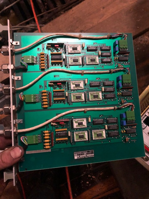

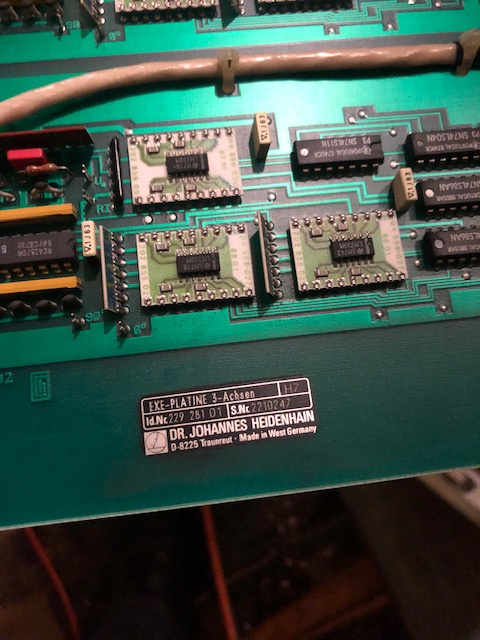

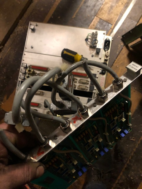

Could you get a photo of the Exe Board (converts the heidenhain scale 11micro amp signal to 5? volt level) . Am interested in the components side of that board.
Bob

Here are some pictures of the EXE board and the machine as it currently sits.
Question about the scales and EXE board. Can these be run to a DRO like you'd find on a typical manual machine? I have a couple manual machines that would benefit from a set of scales.
