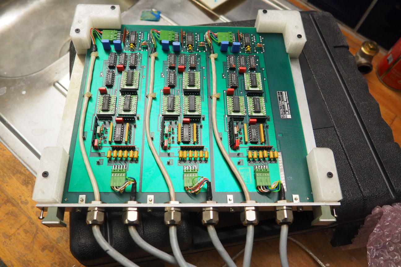

Thanks guys. I did print out the missing brackets for the Heidenhain EXE mounting. Another think I can do with the foot up is start designing the pendant in CAD, and then print a prototype.

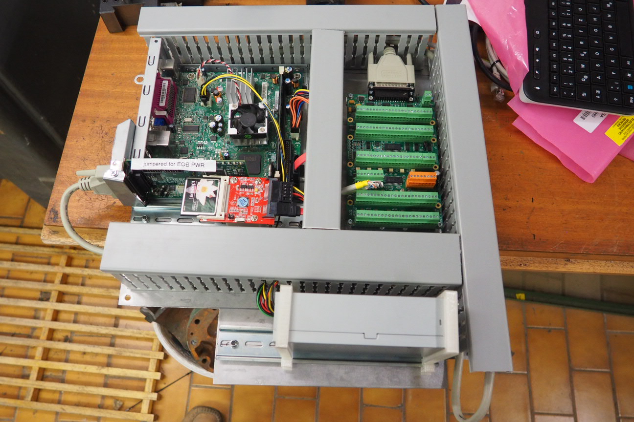

I pulled the controller board back out,
so I can set it up in my room and at least work on the HAL, Ini and Ladder files while I have my foot up.
Also got the EXE board mounted with its 3D printed blocks.

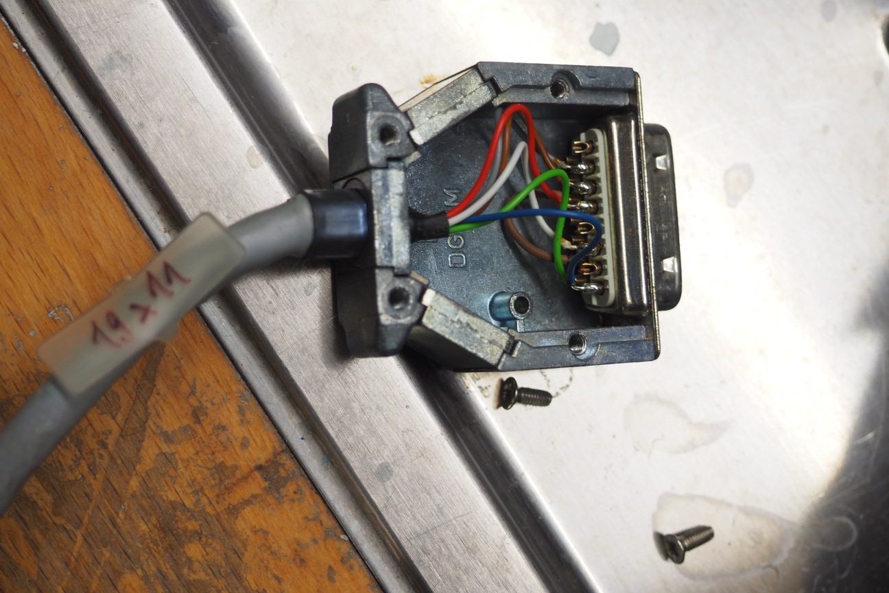

I was curious whether the output cable of the Heidenhain EXE carriers the differential signals, and the Phillips just didn't use them, or whether they were not output. I have no great hope of finding an old 1980's wiring diagram from the version of EXE MAHO used, so I am doing a dangerous assumption here. The product brochure of the more modern EXE gives the wiring colours, and I assume that a company like Heidenhain doesn't change them. The colors match up with the MAHO wiring diagrams.
There were only five wires connected from the EXE to the phillips. A, B, Index, 0v and +5V. There are seven wires in the cable. What I find a bit weird is that the two unused signals would be two different systems.
- the unused Blue - test connection sensor voltage +
- the unused Green - B inverted.
I could see them either bring both test signals out, or both differential invertwed channels out. Maybe I am overthinking this. If I find I have noise issues, I can still try making new cables back to the EXE board, and bring out the differential inverted signals.

If there were differential signals, where is /Z ?

Hello Andy,
Currently, the only differential signal which appears to have been brought out on the cable is Ua1 which you would normally call /A. The other two differential signals Ua0 = /Z and Ua2 = /B should be available on the EXE board at the pin head connector in pins 4 and 1 respectively according to the Heindenhain product info I linked in my last post. If I have noise issues, I'll have to make up a new cble to that green pinhead connector.
For those who speak german, youtuber Talla83 has some really good videos on the MESA cards which I found very helpful...
www.youtube.com/channel/UCHDMxw4Oum-wKm5UpMt2lzA
Mark

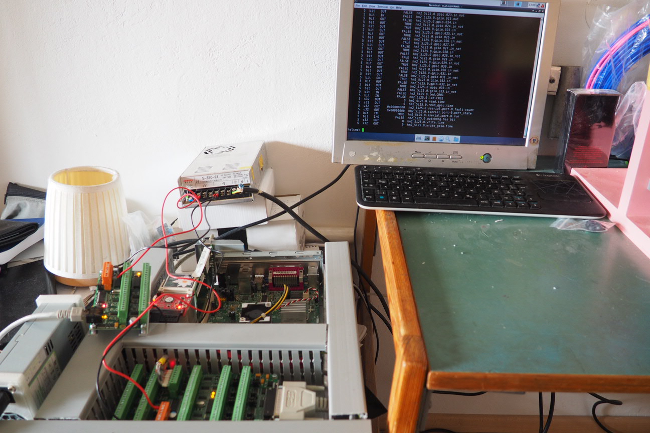

I have the 5i25, 7i77 and 7i84 all installed and powered, and seem to have the whole complement of pins when I run " show pins".
Just a question about putting the 7i77 in mode 3 to read the jog wheel encoder. Do I need to put the following command into my machine.HAL file, or is this a sticky setting which I only need to send to the 7i77 once, and it remains in that mode despite restarts?
loadrt hm2_pci config="sserial_port_0=300xxx"
[Edit] PNCConf answered my question. It out in set up line in the HAL which includes the config="sserial_port_0=000xxx so I just changes it to 300xxx.
Mark
