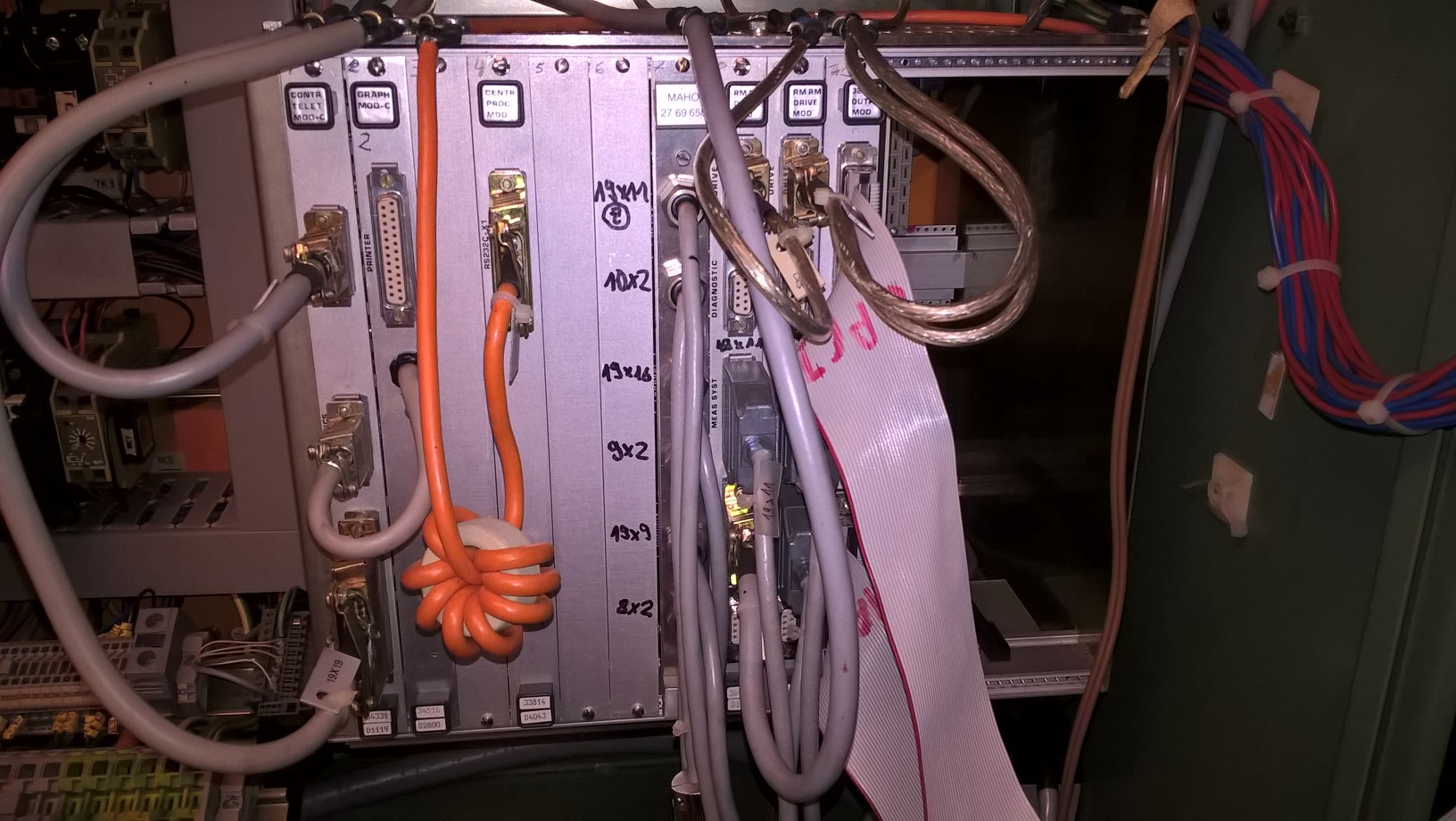

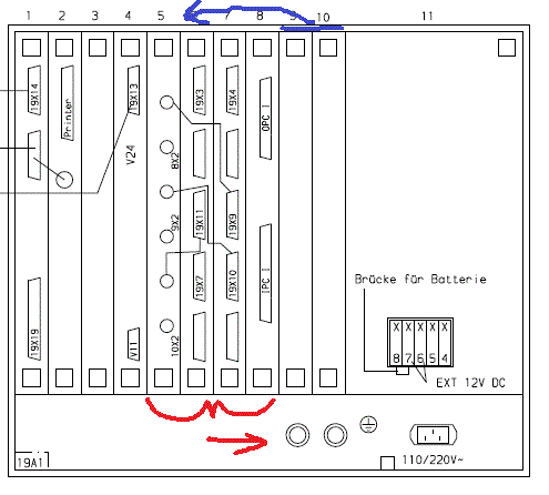

As I want to get the machine running under Phillips control before starting the retrofit, I noticed that four of the controller cards are no longer located in the same slots as when it was made. I doubted that the CNC backplane bus could deal with cards in the wrong place, and was hoping this was the reason that the Phillips 432 doesn't boot. Note, I pulled the PSU for Elko replacement.
I sent an E-Mail to DMG, and they responded that the physical location of those cards is not important. Shame, that would have been a nice obvious solution.

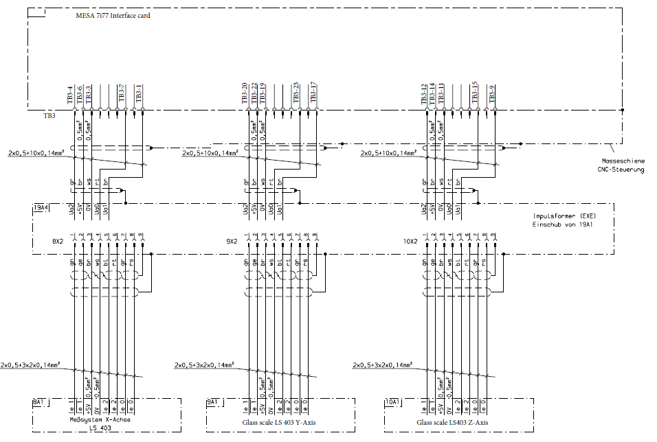

Luckily this MH400E doesn't have the Phillips glass scales. It has 11µA Heidenhain LS403's. The board in position 7 of my cabinet photo is a Heidenhain EXE which will be reused. This is the planned wiring of the scales into the 7i77.

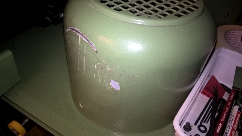

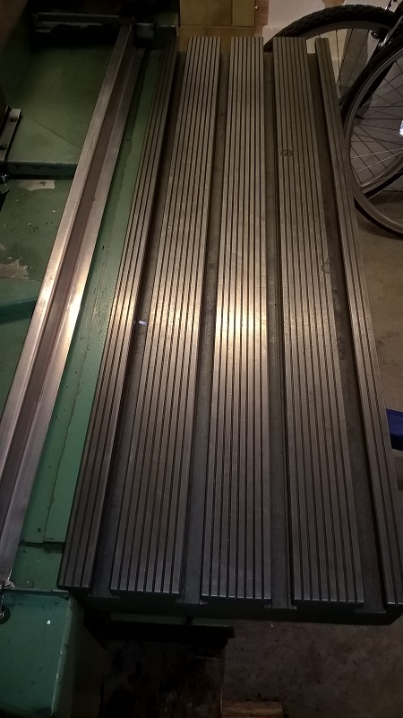

A friend beat out the dent in the spindle motor's blower shroud. Needs a little paint touch up.
The table is back on. There are four mill scars in it.

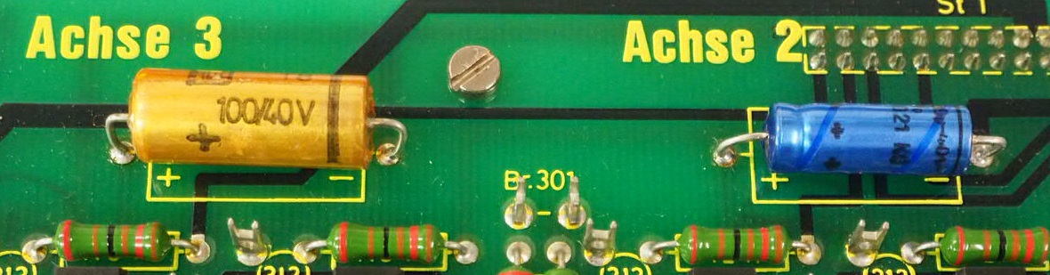

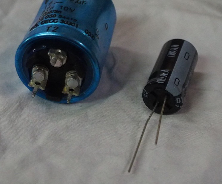

Came across this odd one in the Phillips PSU module.
It has three pins, although both the one marked T2 that to the right go into the same solder field. Is this two caps in one can, and they have only used one? Any reason not to replace it with the single cap I bought?
Mark.
- Thank you received: 4652
I would be surprised if the new cap has the same spec as the old one. Have you compared ESR?

I am replacing the caps based on the internet wisdom that 30year old electrolytics have a good probablity of exploding whenpowered up. I bought replacements based on capacitance, voltage, tolerance and thermal limits.
I would need to know the original ESR specs for those caps, rather than their current values right? I don't have a frequency generator to supply a known AC frequency either.
