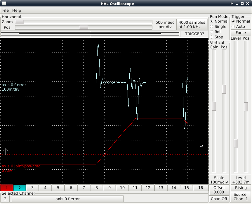

03 Dec 2017 11:44 - 03 Dec 2017 12:27 #102615
by RotarySMP
Thanks, that was it.

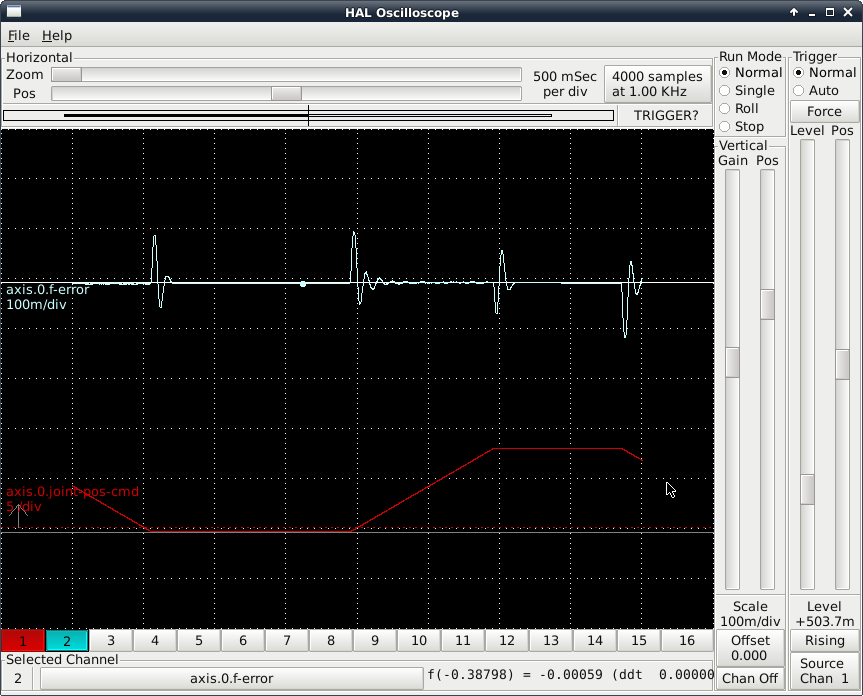

I could then move on to PID tuning. To the guys who programmed the HAL Oscilloscope, and the calibration screens, a big thank you. So far:
# Axis X
[AXIS_0]
TYPE = LINEAR
HOME = 0.0
FERROR = 20.0
MIN_FERROR = 1.0
MAX_VELOCITY = 45
MAX_ACCELERATION = 750.0
P = 6.5
I = 0
D = 0
FF0 = 0
FF1 = 0.22
FF2 = 0.03
BIAS = 0
DEADBAND = 0
MAX_OUTPUT = 0 # shouldnt this be 10V?
ENCODER_SCALE = -1000
OUTPUT_SCALE = 10
OUTPUT_MIN_LIMIT = -10
OUTPUT_MAX_LIMIT = 10
MIN_LIMIT = -20.0
MAX_LIMIT = 380.0
HOME_OFFSET = 0.000000
HOME_SEARCH_VEL = -1.000000
HOME_LATCH_VEL = -0.500000
HOME_FINAL_VEL = 0.000000
HOME_USE_INDEX = YES
HOME_SEQUENCE = 1

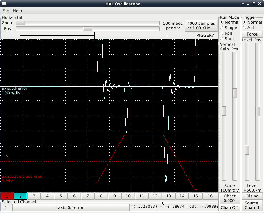

returns the following performance:
100mm/min,about 0.06mm overshoot during start and stopping.
500mm/min - Still about 0.1mm oversoots, but will a little more hunting.
1000mm/min - Overshoots now up to 0.3mm, with two overshoots.
2000mm/min - Errors up to 0.6mm.
I have been working through this #how-to"
www.wiki.eusurplus.com/index.php?title=Category:Tuning
In test 7 he states, "And finally the tuned system response:" but it is not clear to me what was done here.

03 Dec 2017 14:20 #102616
Replied by PCW on topic Retrofitting a 1986 Maho MH400E
It look like the acceleration is set much higher than the machine can follow
( there should be a visible parabolic corner on the position trace during acceleration but it looks like a sharp corner )

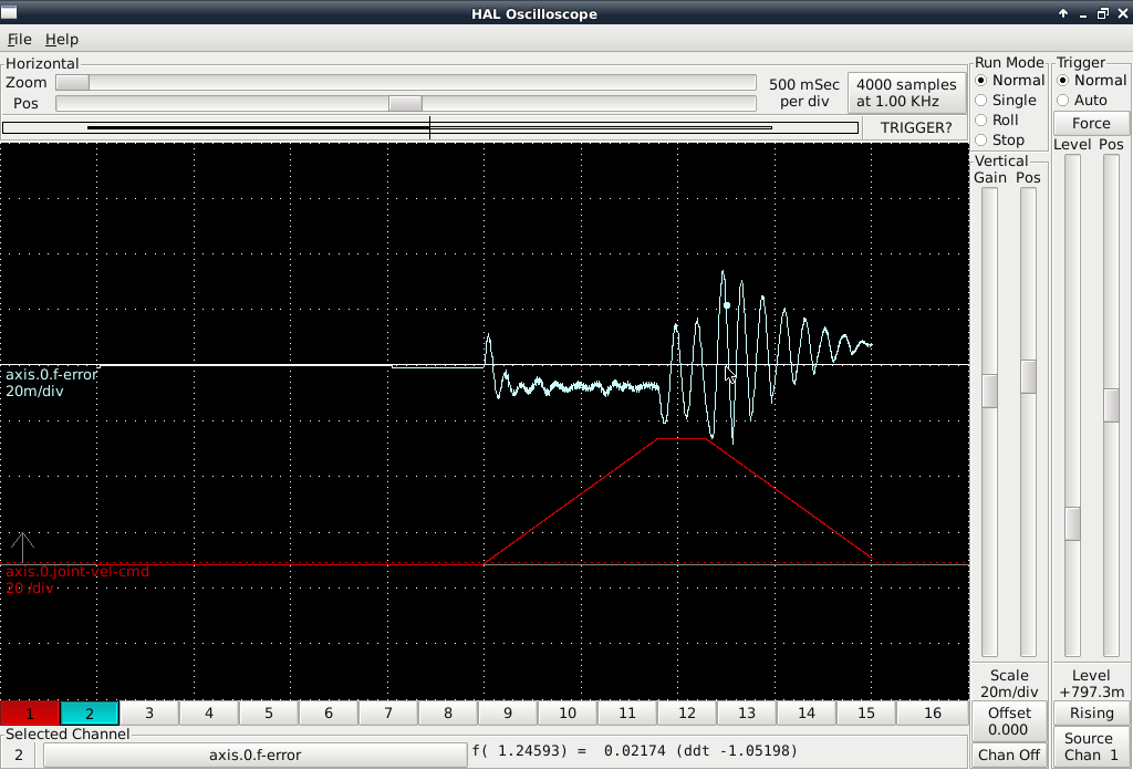

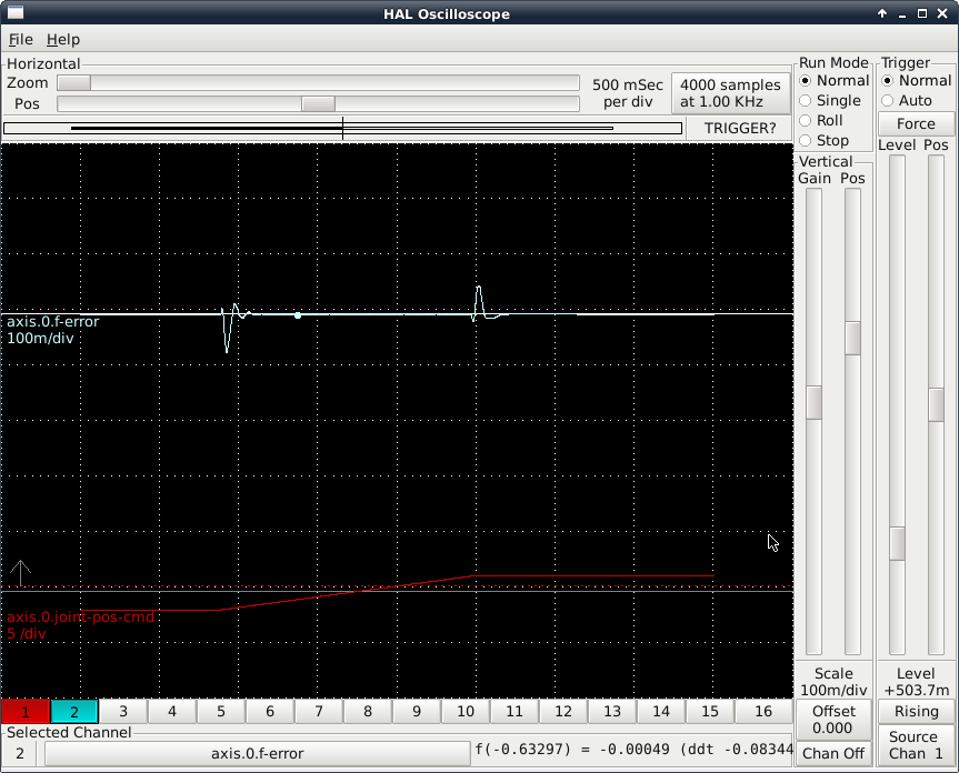

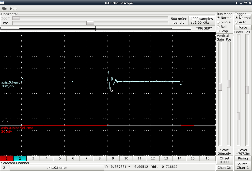

03 Dec 2017 17:11 - 03 Dec 2017 17:18 #102618
by RotarySMP
Good call. I had the acceleration too high, and also the min_velocity was too high. The X axis is now nice and smooth.
At 100mm/min the max error is now about 0.015mm.
at max speed of 2700mm/min it is also only about 0.03mm, but has some oscillation in deceleration which are not there in acceleration.

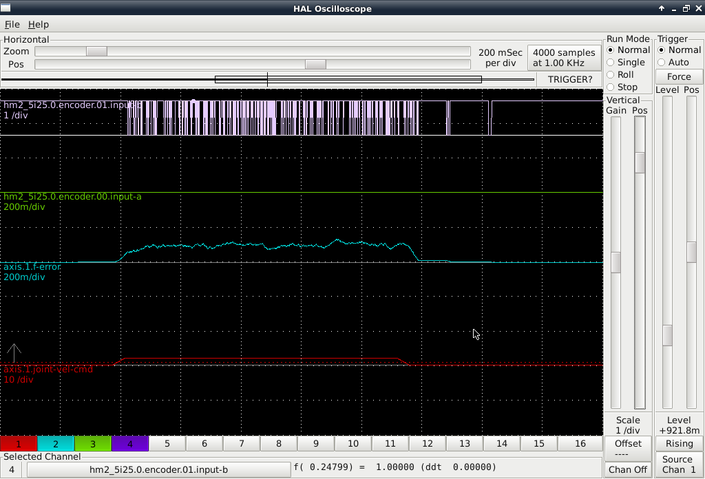

The home switch is the index of the glass scale encoder. I found at about 2mm from the end stop. Homing to it finds it that index, but then errors out with a message saying that the home switch had gone low before it could back off it. Any suggestions how to make this more robust?
I connected the net for the Z axis brake to the machine-is-on , but then had a go at getting the Y axis tuned. I had been having some problems with that Y Axis glass scale encoder stopping working, but it had seemed to magically fixed itself before I got around to trouble shooting it. That was wishful thinking...
There is no channel A output.
I need to trouble shoot that but got too cold after hours in the garage. It is below freezing here, with the light dusting of snow from wednesday still on the ground outside. The garage is the coldest room in my basement.
NMark
NMark
Last edit: 03 Dec 2017 17:18 by RotarySMP.
- Online
- Posts: 17450
- Thank you received: 5091
03 Dec 2017 18:10 - 03 Dec 2017 18:11 #102620
The encoder might be bad but your traces show the Y axis Quad- B and the X axis Quad-A
