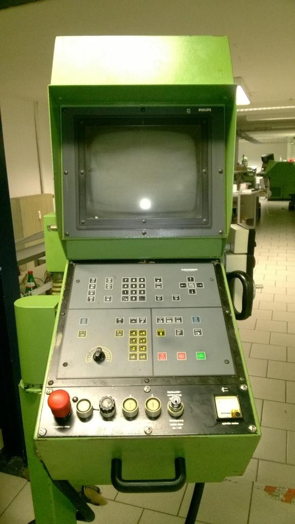

Thanks. 432/10 is the version of the Phillips controller. A Phillips 432 version 10 (Version 9 had a much simpler keyboard). Since I couldn't get any docs for it, I pulled the Phillips, and am no longer looking for it.

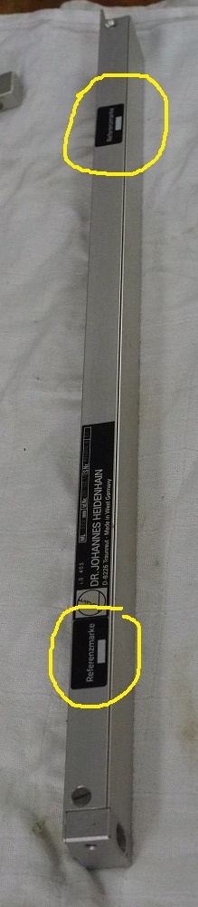

My X and Y LS-403's only have index pulses at one end. Havn't had any sign of live from the Z scale yet.
I hadn't heard of MAHO E models with DC main spindle drives. I thought the "E" model MAHO's use three phase spindle drives. The basic "E" with relays to switch the motor, and the 18 speed gearbox for RPM control, an the E2's with fewer gearbox ratios and a VFD.
Mind has the 380VAC three phase spindle motor, with relays to reduce it's starting inrush by starting in Star, and then switching to delta.
I was surprised to find out that the MAHO is a 110VAC machine, except of the spindle drive. Strange for a European manufacturer. At my house I have Two 380 three phase services in from the pillar box at the property boundary, with one splitting to two residual current CS's and then 16A normal CB's. So my basement is on a different circuit to the kitch en oven. Over here even apartments have a three phase supply, for the oven.

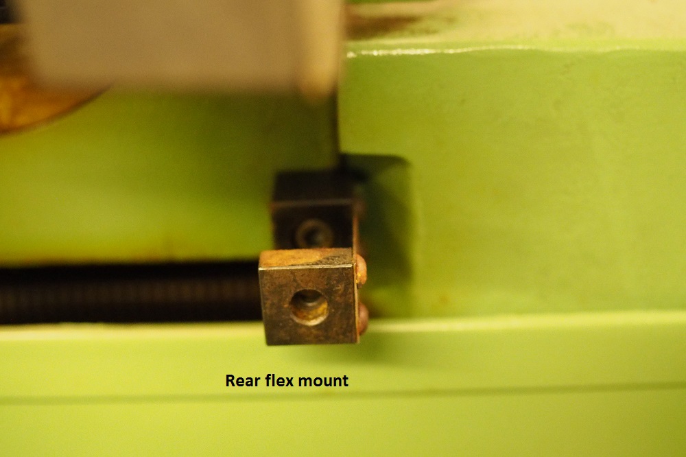

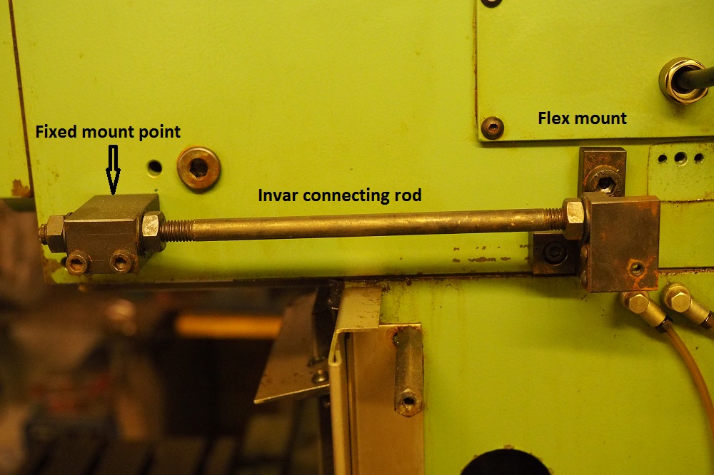

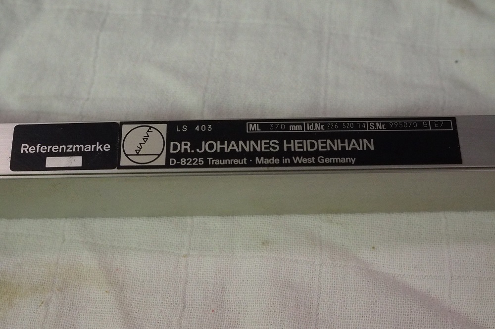

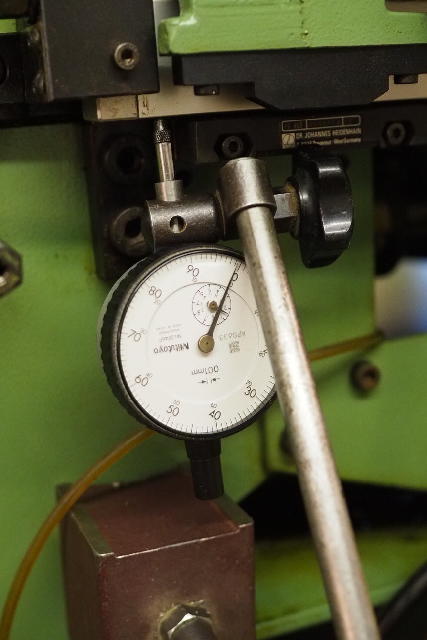

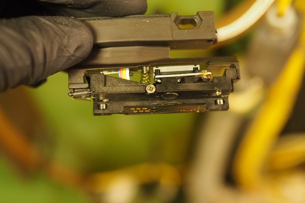

I finally pulled the Y axis glass scale encoder (Heidenhain LS-403) and cleaned it today. Thanks to J Green for the
instructions
I used digital camera sensor cleaners to clean the scales and the sensor head.
Pretty cool how MAHO built the LS-403 with a temperature compensating mount system.
The only rigid mount, perpendicular to the axis travel is the front block. The two at each end of the glass scale are flextures, which are soft in that direction, so the glass scale will detect Y axis (gearbox housing) growth, and the control will compensate.
Tomorrow I need to realign the scale, and sensing head.
Mark
Mark

"My X and Y LS-403's only have index pulses at one end." Thanks for jogging my memory. The scales mounted on my machines also only have one end label ( RM ) and it is the spare scale that has a ( zero pulse label ) at both ends. Have read somewhere people
commenting about their scale having the index mark painted over on the glass at one end. When the paint was removed the scale then had two index marks. My thinking was two index marks could help prevent axis over travel train wrecks at both axis ends .
Thus not counting on just the micro-switch at one end of axis travel. Hope your Z scale problem is only a poor solder connection.
But if you do scale surgery, please take lots of photo's. If the read head is removed, might consider powering it to see if the
( I think they are bulbs not LEDs ) light source is OK.

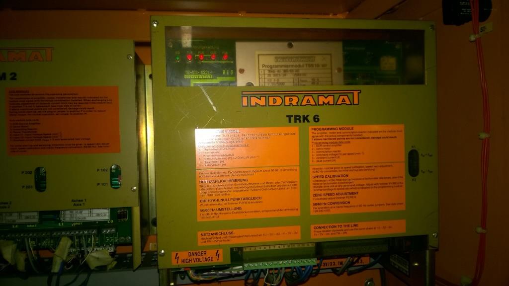

19 Feb 2018 21:46 #106191
by cgroth
Replied by cgroth on topic Retrofitting a 1986 Maho MH400E
Just in case someone is looking for more information. That's what the DC-drive on a MH300C looks like.
It is controlled by an Indramat TRK 6-4U.
I have the manual if needed. I also have Maho programming manuals for 432/9 and 432/10. It is a bit weird, Maho speaks of Software 6053/302 and version 600/700 respectively, the latter one showing the more complex keyboard known from the 432/10. Anyhow mine only has the the smaller keyboard.

Now you mention it, my Y axis scale does have two reference mark stickers.
I definately tried homing on the RH end ( which would be the ram fully retracted) when I was tuning the axis, but found no index there. I'll try again once I have the scale realigned. I procrastinated on that since saturday.

cgroth Thank You for the photos an information about the MH300C. That ,to me, looks like a very-very nice machine. It doesn't even have any belt dust from the belts. I am envious. Wish I could find one like it . Am also envious about that nice shop and it's tile floor. That is nice. Wondering what those other Green machines in the shop are?
You mentioned having manuals & information if needed. While I do not realy need manuals & information about the MH300C or TRK 6-4U drive & it's motor or information about 432/10 ,I sure would spend nights reading it. Am sure that others reading Mark's thread could find value from the manuals and information . Speaking just for me , I would sure appreciate reading it.
Again! Thank You
Again! Thank You

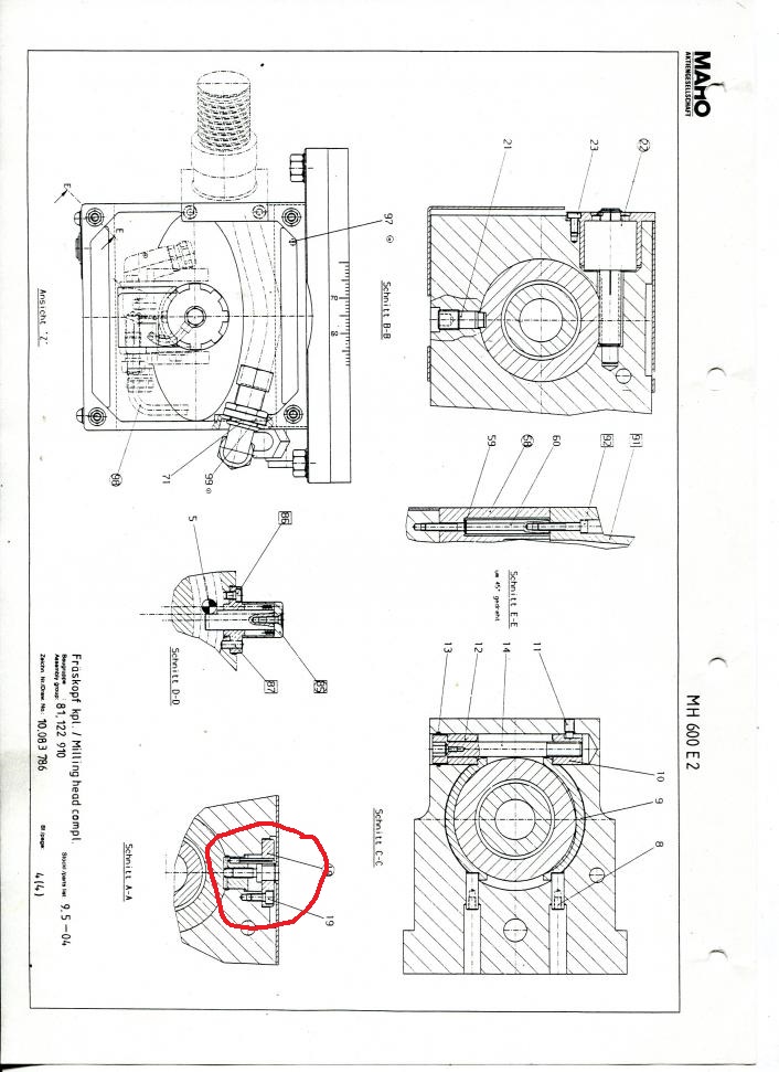

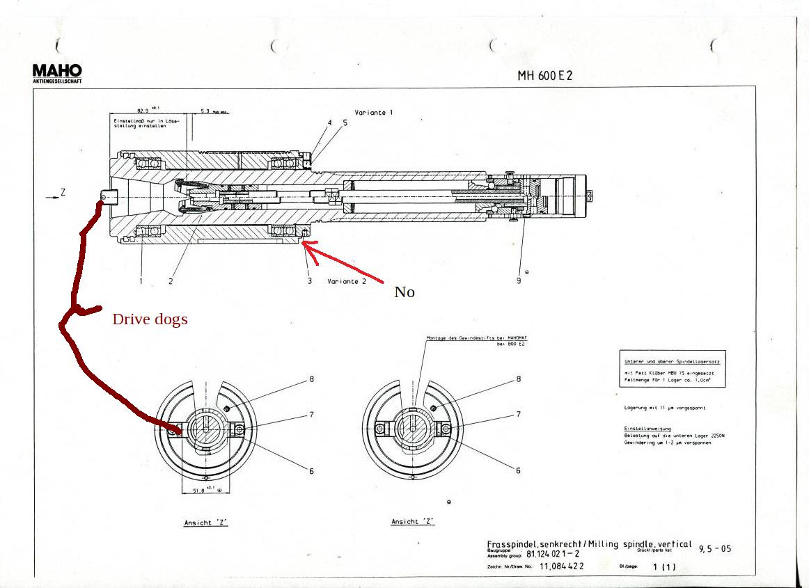

22 Feb 2018 23:44 - 22 Feb 2018 23:53 #106359
by J Green
Replied by J Green on topic Retrofitting a 1986 Maho MH400E

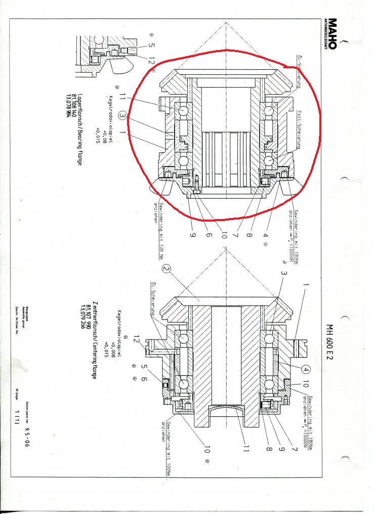

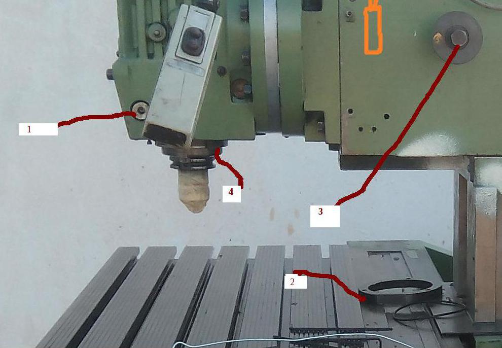

drimaropoylos / John Hope this helps
#2 is the steel holding the shaft wiper ,the add on O ring is there also
#4 is where the shaft wiper goes ,and spindle nose has two drive dogs that drive the tool holder
#1 is another part that was loosened
#3 does your horizontal Quill also move ?
Maho Head.jpg[/attachment]

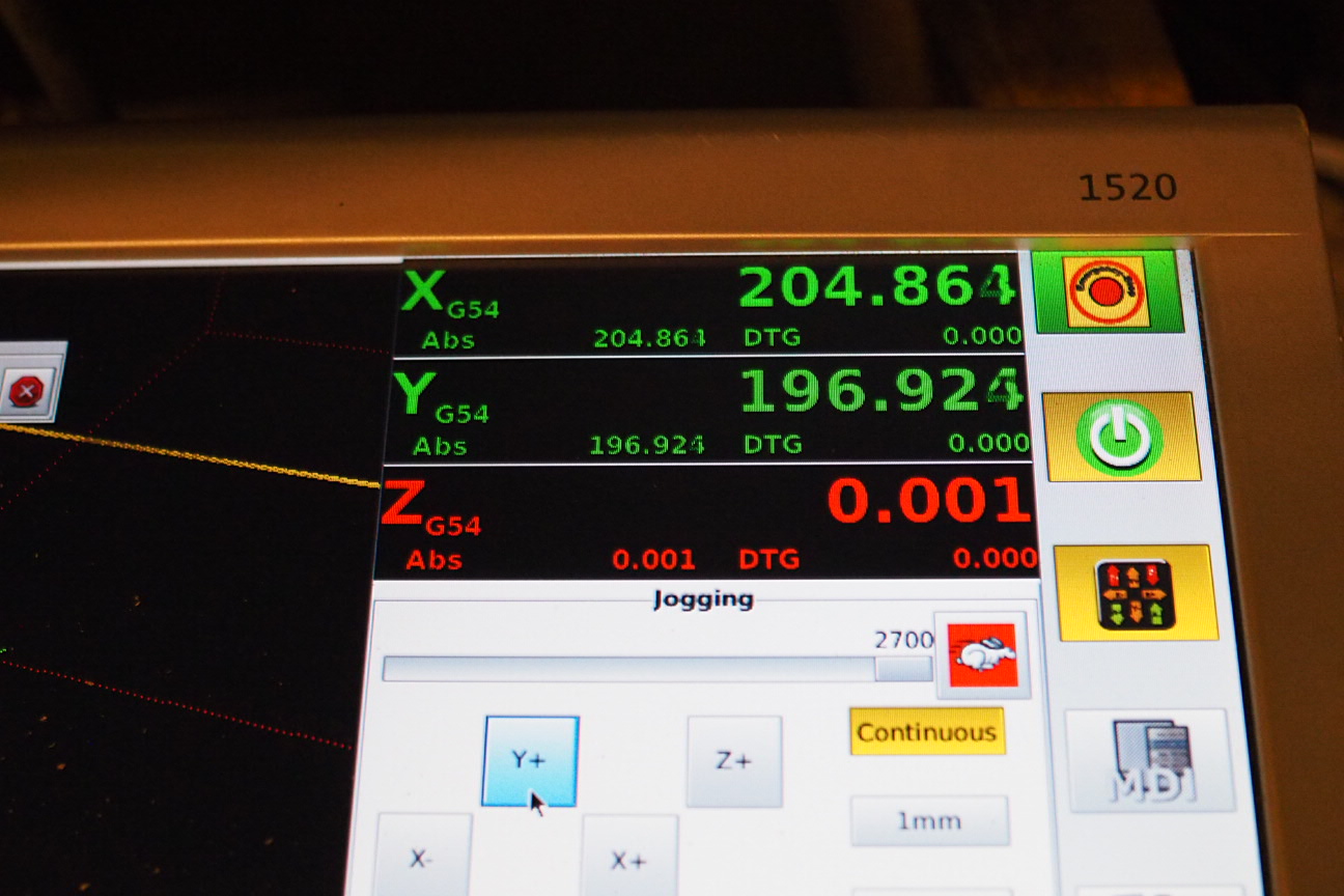

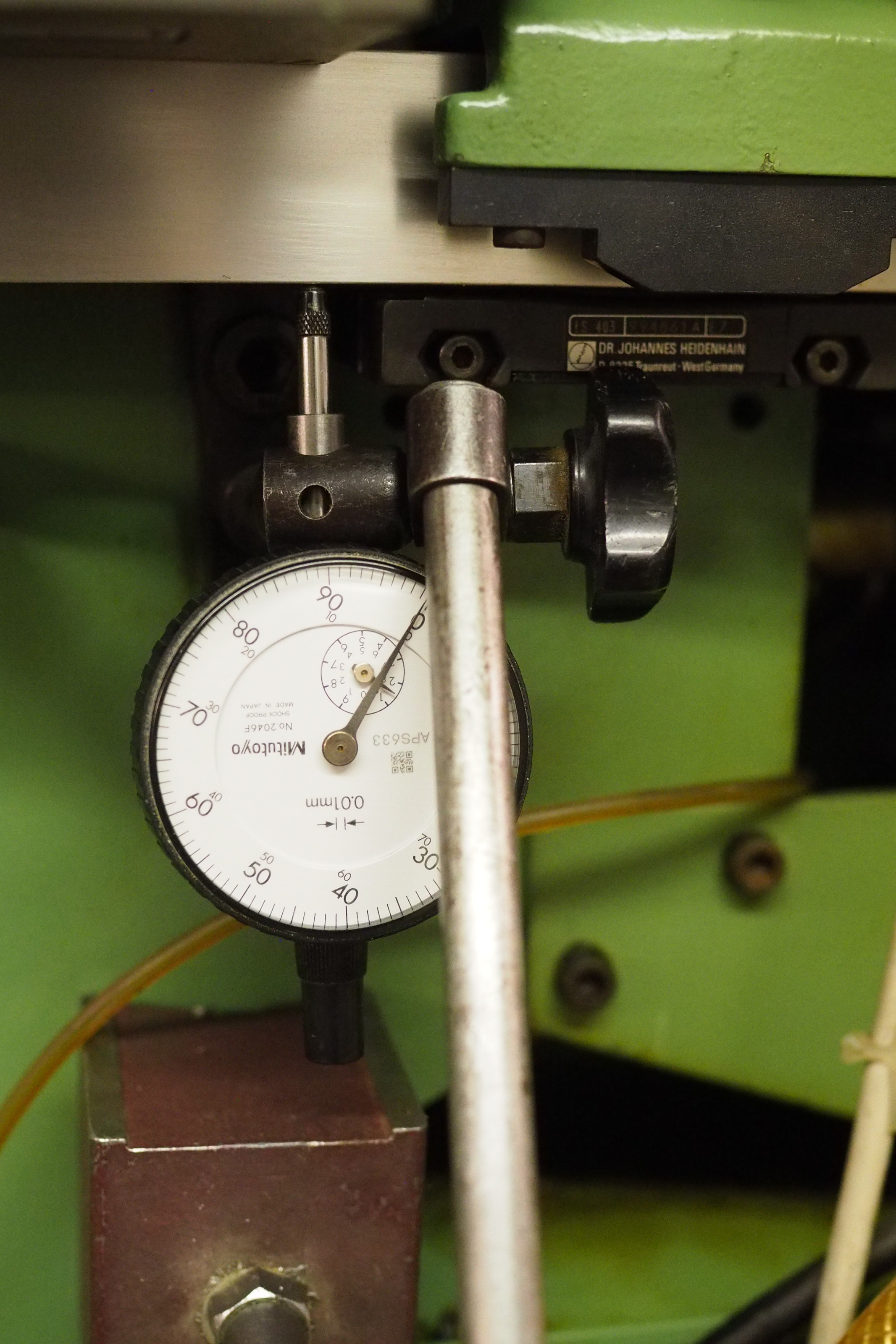

24 Feb 2018 12:53 - 24 Feb 2018 12:54 #106430
by RotarySMP

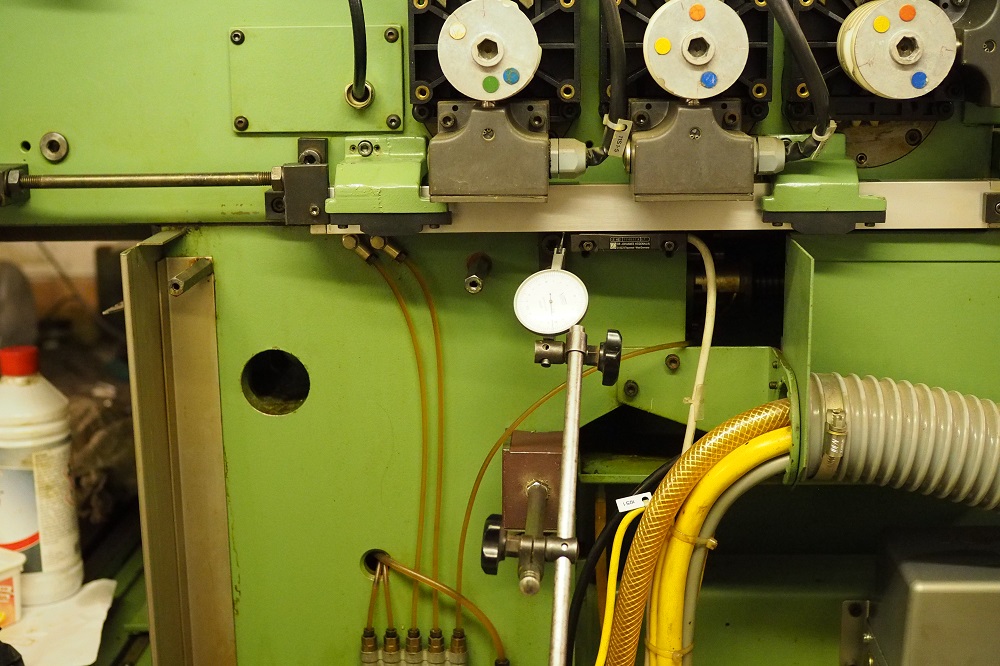

I aligned the Y-axis Heidenhain LS-403 scale today. The allowed tolerance is 0.1mm over the length, but it was pretty easy to set it within about 0.01mm.
The gap between the scale and the head should be 1mm +/-0.3mm, which was also easy to set with feeler gauges.
After reinstalling the end stop blocks and switch, and testing them, I homed the axis...
...and jogged it around for a while, checking it's postion against a ruler. It now seems to work correctly. Where before it was gaining about 20% on jogged distances due to lost encoder steps, now it seems fine.
I also got my USB cellular network datastick working under LinuxCNC which will help with updating and looking stuff up.
Mark
Mark
