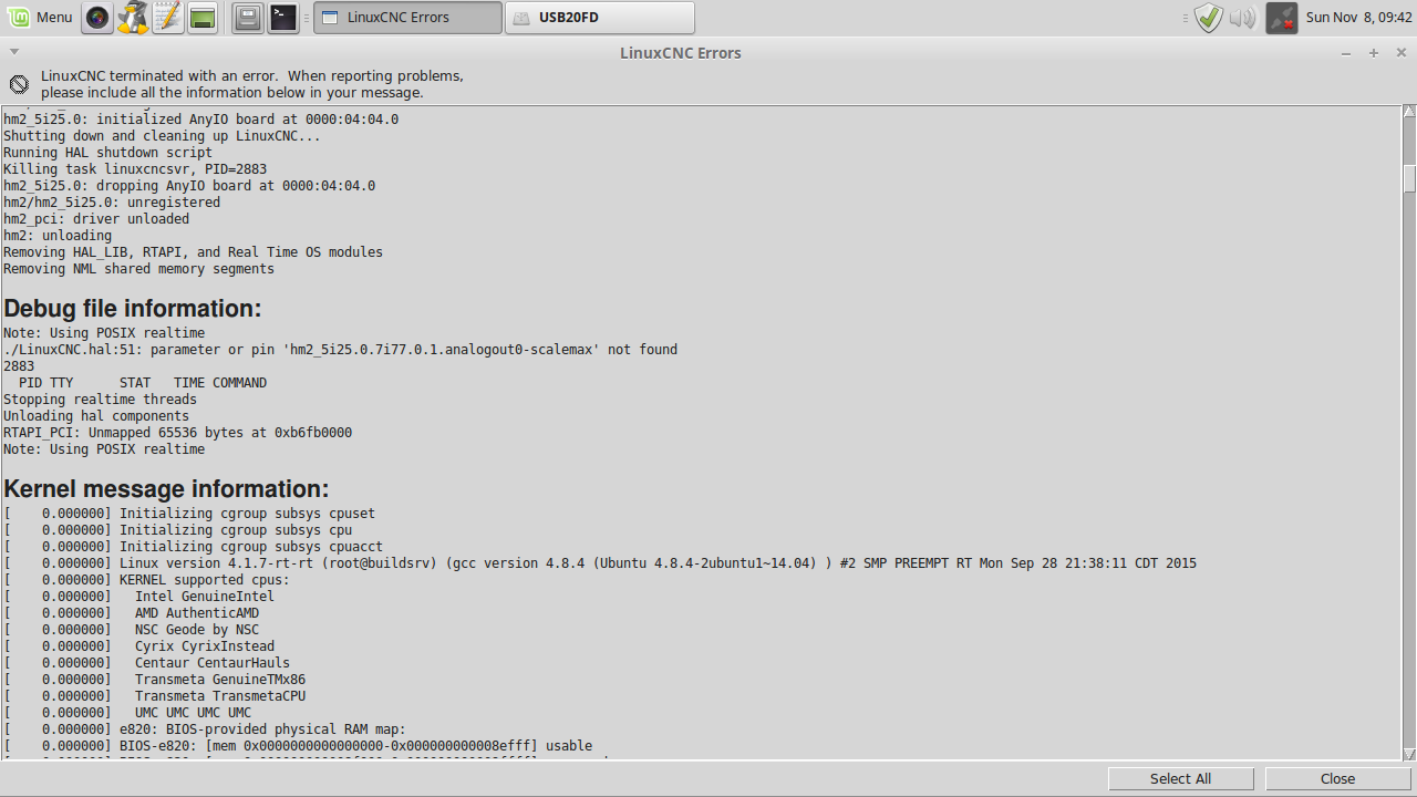

Todd, USPO just delivered (as per USPO promise of 3:00 PM delivery) new 7i77 card, tomorrow I will swap out, change jumpers position, review SW1 positions & use last wiring diagram (using pins 9 & 11). Todd, many thanks, for your continued support.
New 7i77 card installed, jumpers w10,13,15,17,19 & 21 to the left; SW1-1=OFF,-2=OFF,-3=OFF,-4=OFF,-5=ON & -6=OFF. The x axis runs away, as soon as e-stop is released (the yellow that shows motion of tool, that "ctrl+k clears" will be visible), if you set SW1-5=OFF the red LED is on driver, will slow the speed, still does not match DRO. The y axis osculates about a 1/3 turn, and then will oscillate back the 1/3 turn. Attached is a pic of debug info if you try to run linuxcnc w/o power to power supply.
Many thanks

Many thanks!! With linuxmint running, release e-stop and x axis motor starts motion, start linuxcnc and DRO is counting (the yellow line was moving off the screen to the right). The direction of the motor (as to move table as you stand in front of mill as to operate it, the table moves to left), I believe this matches DRO direction. All of this is while (F1, is clicked) if you release f1, no change; click f2 no change to DRO but (joint 0 error) will appear.
Y axis (as 1st boot up) DRO is moving (the DRO will start at 0.0 go to around +.028 & then go back to 0.0), very close to how x axis is working; if you try to turn motor shaft, it will resist, if quickly reverse direction you are tiring to turn shaft, it will resist; with f1 un-clicked and turn shaft will get (joint 0 error), I believe the joint error happens as soon as click f2.

tommylight, many thanks for you help! I have used ohm meter to trace each lead from the encoders to the TB3 connection, so with 100%, know where each lead is connecting. I found issues, did not record them. Removed the leads from TB3 that are not being used (2 & 5).
Now with linuxmint running, release e-stop and motors are in motion, open linuxcnc, DRO is reading ok and F1 is down; x axis is run away, at low speed; y axis is oscillating about .140", back and forth; release F1 (up now), no change; click F2 (down now) both axis stop motion, you can turn motor shaft and move DRO the correct way.
Drive settings: X axis, SW1-6=on (if this is other way motor will still run away, and Red LED will be on drive)
Y axis, SW1-6=off (if this is other way motor will still run away)
The attached wiring diagram was used as reference during wiring. The address of TB5 is 1=ENAO-; 2=ENAO+; 3=GND; & 4=AOUTO. This is not included diagram. Does diagram look ok?
many thanks, for all the continued support.
Edit: The diagram shows no lead from P1-11 GND (Signal Ground) and (Location 3) GND on TB3. Should there be?
