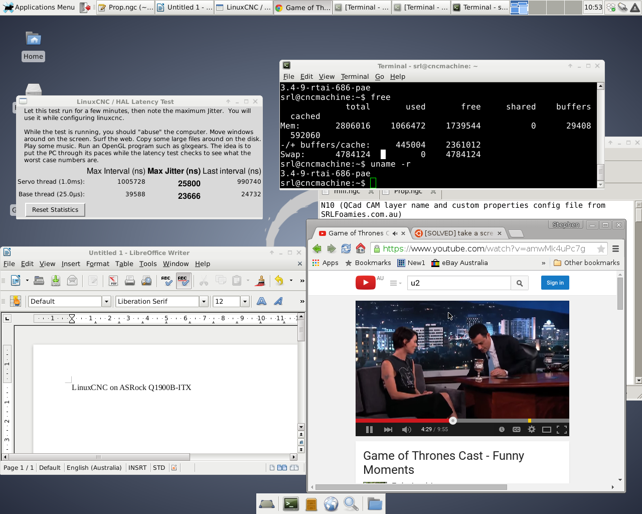

07 Sep 2015 03:03 #62177
by SrLange61
Replied by SrLange61 on topic Intel cpu on board motherboard suggestion
Here is the screenshot I took some time ago.
sr
sr
The following user(s) said Thank You: eFalegname
- eFalegname
- Posts: 252
- Thank you received: 30
07 Sep 2015 08:29 - 07 Sep 2015 09:13 #62183
by eFalegname
LinuxCNC on AsRock Q1900B-ITX Max Jitter 26666 ??? I'm in shock Sir
At this point the AsRock Q1900M Pro3 seems to be a better option for LinuxCNC
Replied by eFalegname on topic Intel cpu on board motherboard suggestion
