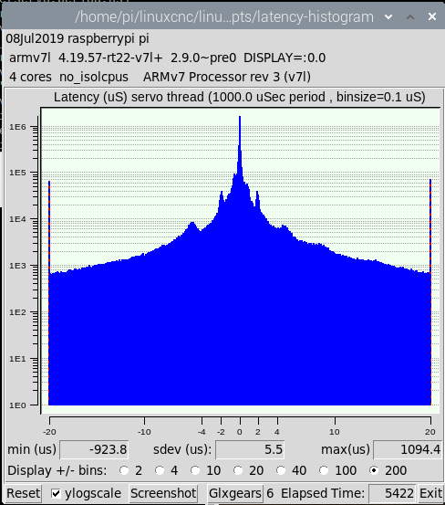

Replied by andypugh on topic Raspberry Pi 4
People have achieved better than that with the Pi3. so I think that there may be room for improvement.
Try here; github.com/guysoft/RealtimePi

13 Jul 2019 15:13 - 13 Jul 2019 15:30 #139257
by Hakan
Replied by Hakan on topic Raspberry Pi 4
I am all for improvements. Checked the link. We both use the RaspberryPi kernel patched with the official Preempt RT patches. The link uses CustomPi, I used standard raspbian. My immediate thought is that there should not be much of a difference.
One thing I know is that the sd-card I used during these tests was amazingly slow. I will retest early next week with a much faster sdcard, perhaps that slowed things down. Apart from that I can just say I was hoping for a better result and I am willing to test good leads.

15 Jul 2019 16:57 #139467
by Hakan
I tested today again with a new sd card. Well it was better but didn't really solve anything.
If I run latency-histogram for under 1 minute I get similar looking graph like wicki's.
The previous graph I posted ran for 1.5 hour with me surfing and 7? glxgears.
I can't see there is a real difference otherwise. I used the 4.19.57 kernel with the RT-patches for 4.19.50, but it shouldn't matter, the RT-patches don't change that much and the patching was clean with just a few line offsets. wicki used 4.19.50 for kernel and rt-patches. There is a difference of course.
wicki what does the latency-histogram look after, say, 10 minutes?
And does it work running linuxcnc, that is of ocurse the interesting question.
wicki, if you are busy testing I think I'll wait for your results.
