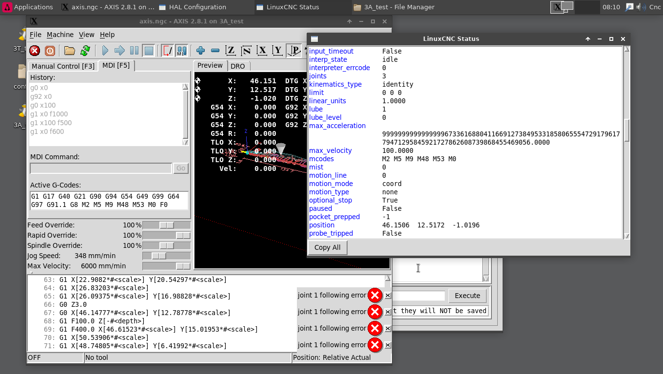

I have play around the system few time, When I runing the NC program and open some other windows like LinuxCnc Status to watch the parameter and setting, It will shows up "Joint 1 following error."

Hi! What's the status of this project on H5? Is it usable? I'm having problem with my PC motherboard and latency spikes. Is it usable at the actual stage?

I purchased one of these H5. Wanna try it on real hardware CNC. By usable I mean... It loses steps, or have any serious bug that would prevent for being used? I'm avid to use it! I've been searching for an example of it working on a real machine but haven't found anything.

So, I guess no ARISC support in H5 at this moment. I should've picked an H3 but thought 512 MB RAM would be too low to run x server and axis. Anyway, I would be glad in doing tests and reporting back. If needed, count on me. I have a fully assembled machine to this.
