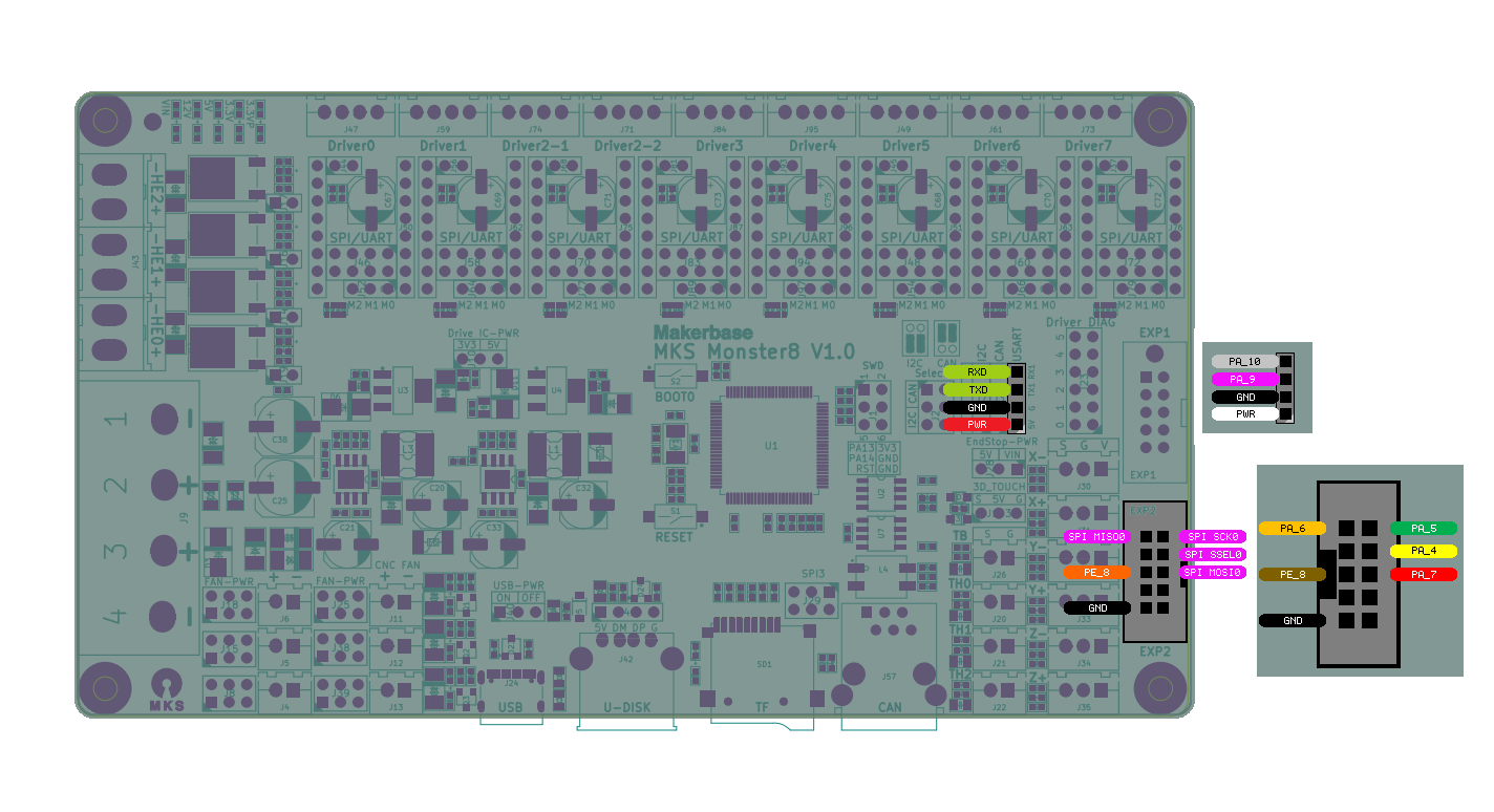

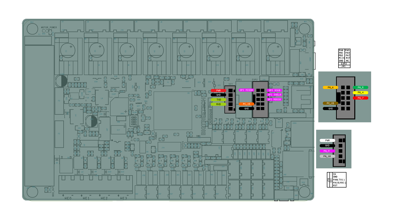

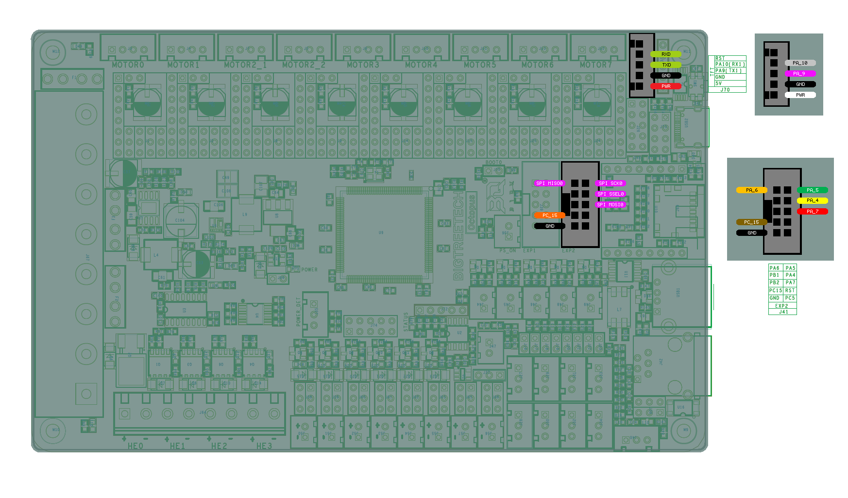

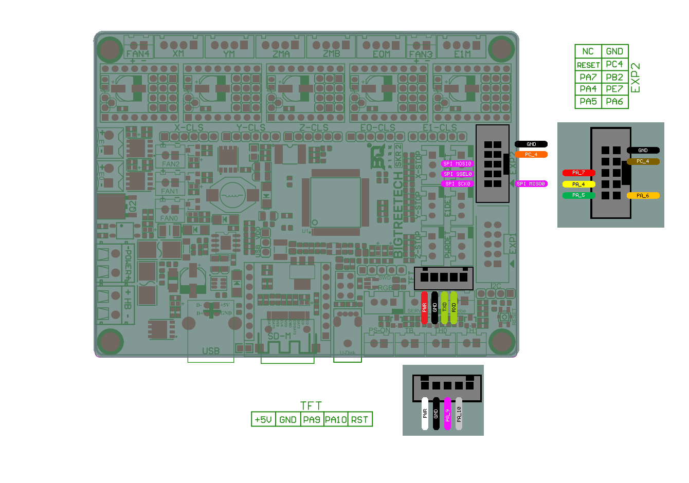

I thought those pictures you have in the docs looked pretty damn slick, so I did my best to keep with that.
SKR2 (407 and 429)
OCTOPUS PRO (429 works as expected)
OCTOPUS V1.1 (446 works kinda without bootloader)
MONSTER8 (works kinda without bootloader. I can get the config to load if I eject the sd after boot and pop it back in)
SKR2 (407 and 429)
