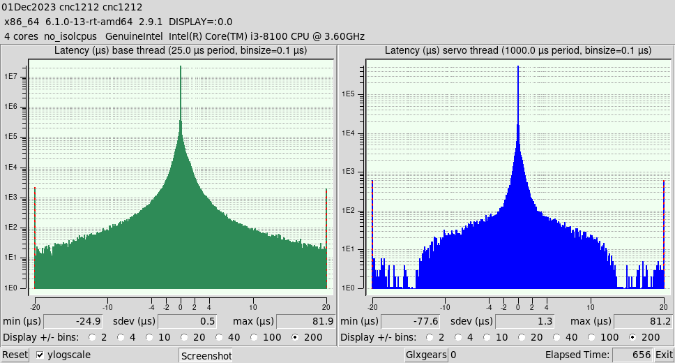

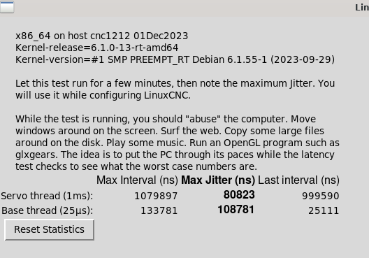

- 0jw
- Posts: 98
01 Dec 2023 03:21 #286924
by 0jw
Replied by 0jw on topic Remora - ethernet NVEM / EC300 / EC500 cnc board
the latency actually looks pretty bad on this desktop. I have youtube running in the background and some files open.
