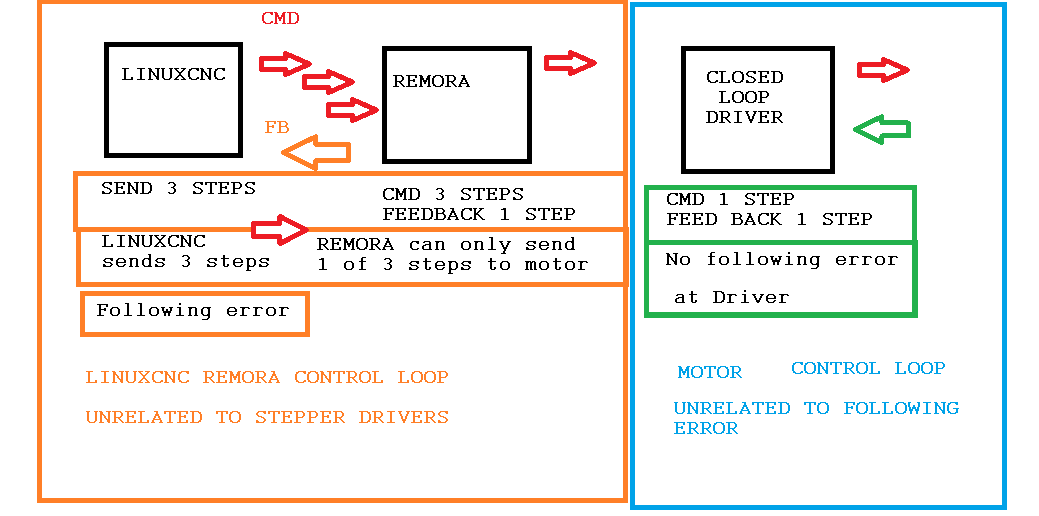

21 Nov 2023 10:05 #286179 by cakeslob
Hey Hans.
The type of stepper motor makes no difference in this case, and even closed loop motors will be affected by following error. Following errors would not be detected by your stepper driver, your stepper driver will only detect physically missed steps unrelated to linuxcnc, because it is not in the linuxcnc control loop.
A following error is in the control loop between linuxcnc and remora, your motors are not involved. If the controller ran blind, you would still and the same issue, it would just not be detected. Your stepper motors would not detect the issue because they are not involved in the process.
How could this be fixed?
You need to understand the issue and fix the root cause.
The issue is Linuxcnc is sending more steps than remora can execute (to put it simply) But it could also have to do with the speed/accel settings, where linuxcnc cannot preform the desired moves without deviating from the ferror parameters. In a blind system with closed loop motors, it would still be a problem, but it would be undetected by the controller. You would have a positional error but linuxcnc would not know, and your stepper motors would not know.
The root cause is found somewhere in your ini file. I would advise you to revert the configuration and component to the supplied default parameters and work from there. By modifying the component and changing critical parameters, you are making it more difficult to troubleshoot. You shouldnt need to modify the component to make it work with your system. I would suggest brushing up on some of the linuxcnc concepts in the manual, keeping in mind not everything will be relevant to remora, but some concepts like motion and speed, will always be relevant.
I made a quick illustration that is a simplification of what a following error is and why it affects closed loop drivers, incase it will aid in the understanding of the issue. I dont have the most comprehensive understanding of it all but I think I understand a general amount.
Perhaps I am wrong, but I would revert your component and configuration and start with the parameters mentions in the earlier post by Scott

Hi cakeslob,
Tanks very much for Your detailed information! I appreciate Your time You invested into this!
I reverted the component remora-eth-3.0.c and my ini file.
The only difference in the ini file now is the SCALE only, which I set, according my hardware, to 1000.
I know the theory of following error, but I was not aware that here the following error is caused by remora not beeing able to send all steps.
As a test I increased the SCALE to 2500 and set the setting on the motor accordingly, I got following errors again, especially on fast moves. Back to a SCALE=1000, which would be accurate enough for my use, I can make even very fast moves again.
Thanks again for Your highly appreciated help!
