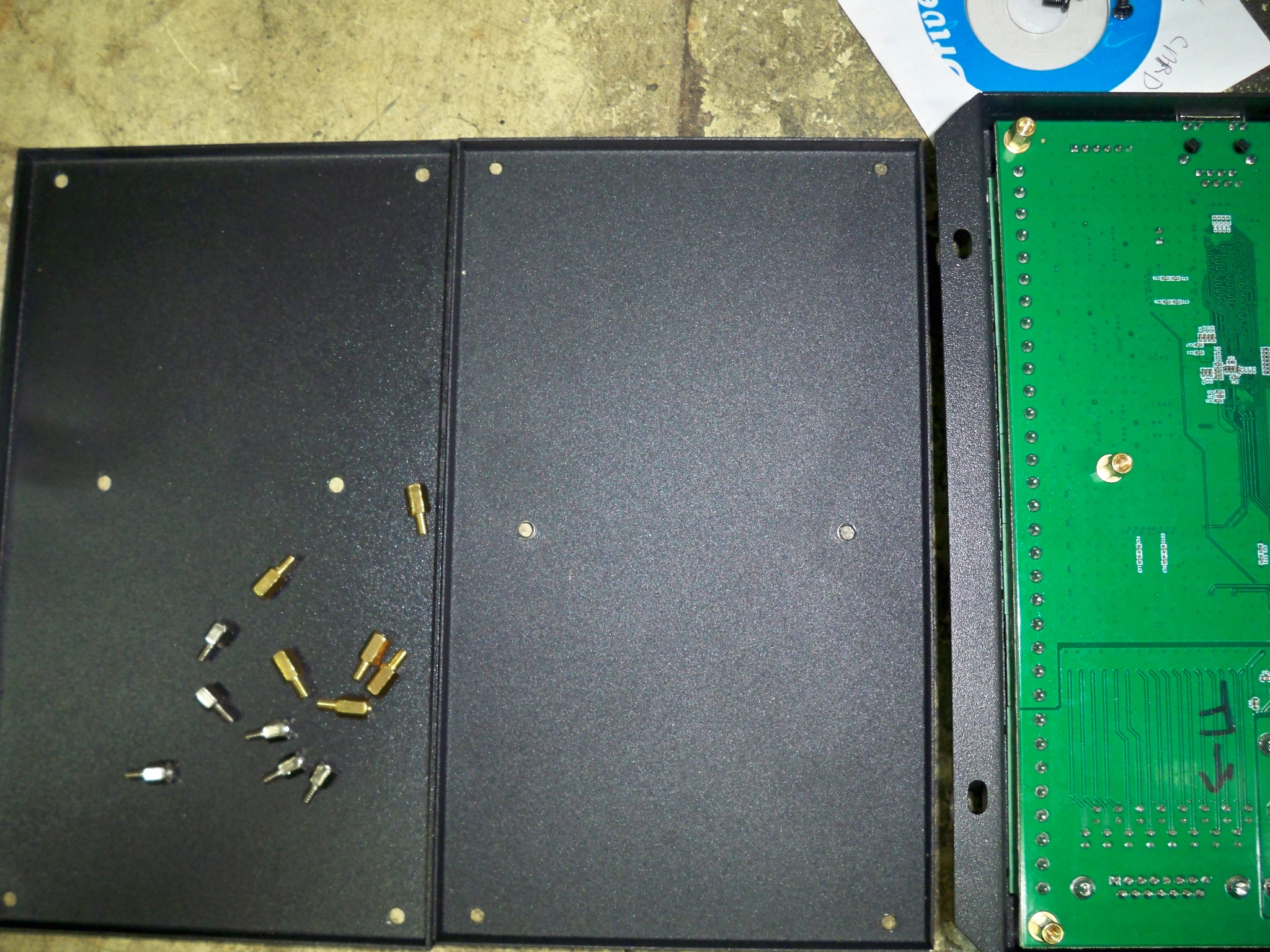

14 Nov 2023 08:37 - 14 Nov 2023 08:59 #285351 by frayja2002
Replied by frayja2002 on topic Remora - ethernet NVEM / EC300 / EC500 cnc board
Just to confirm on this I have flashed another board (with lots of checking) and it does appear that output 13 on my new board is faulty.....
Oh dear China !?!
I was also wondering if I upload a reduced size config file (IE 3 axis instead of 6 axis) does it increase the speed of have some other effect on cycle time?
Alex

14 Nov 2023 10:14 - 14 Nov 2023 10:29 #285357 by andrewt12
Replied by andrewt12 on topic Remora - ethernet NVEM / EC300 / EC500 cnc board
Hi All,
I Have an NVEM with rt1052.
Is it normal for the 12volt outputs to be at ground and the grount to be 12 12volt ? Im talking about the the bottom rows along where all the inputs are.
Also the manual shows to use PNP inductive sensors but the inputs need to be pulled low to get them to trigger. It is completely the opposite to what is shown in the manual.
I can make it work I just find it strange.
Cheers
Edit. Never mind. Worked it out. They changed to NPN inputs on the v5 and reversed the polarity on the output voltages. What crap.
Last edit: 14 Nov 2023 10:29 by andrewt12.
