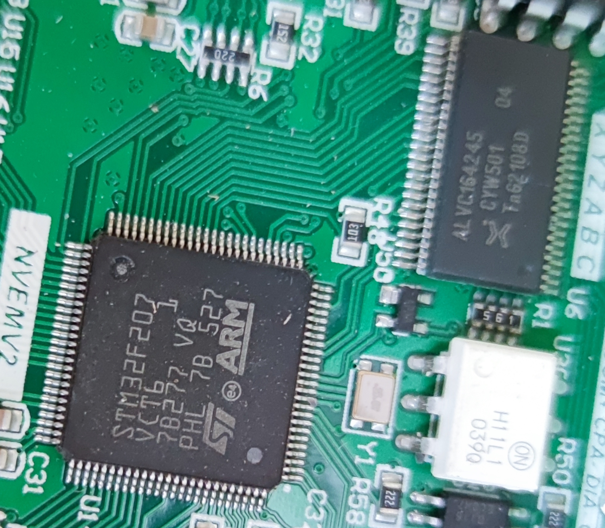

Which version of the NVEM board do you have?

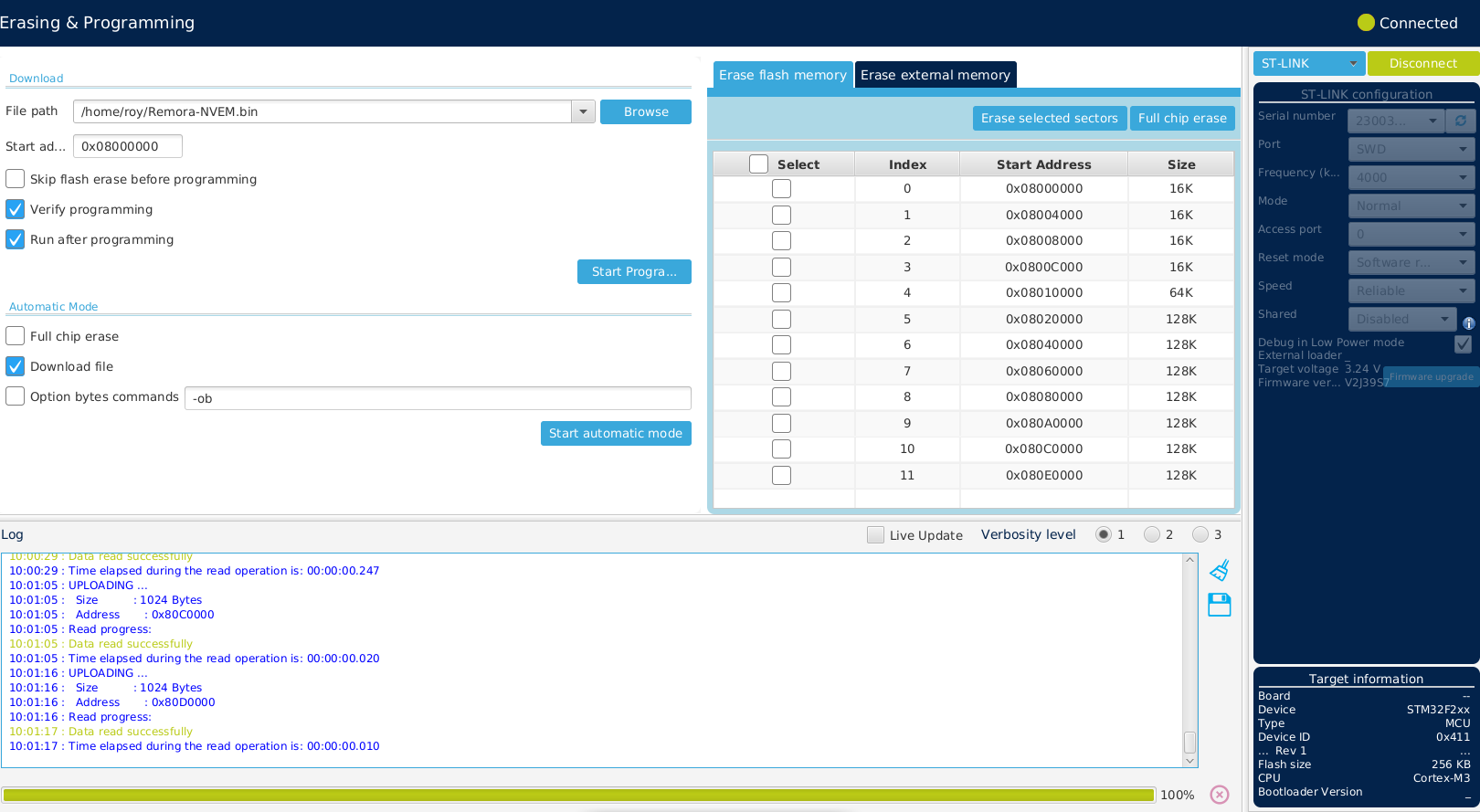

No response indeed, but it's resetting after an attempt to upload. With tftp on command line I could connect but, but when I try to "put" the file it also gives a time-out. It's an NVEM V2, I could send tomorrow the memory layout. I saw that the json will be written in the middle of one of latest 128k blocks, is that how it supposed to be?

Yes, blocks 10 and 11 are used as temporary and final storage locations of the config file.

In stm32cubeprogrammer you could save the memory from the device, maybe I could upload yours with the config included?
