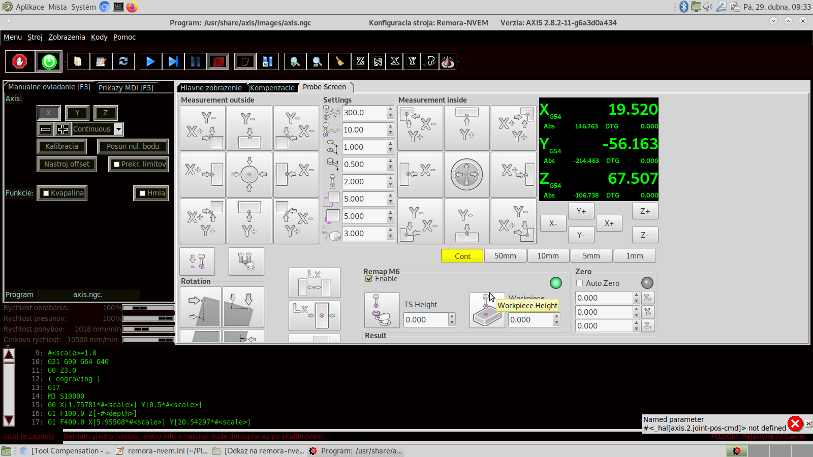

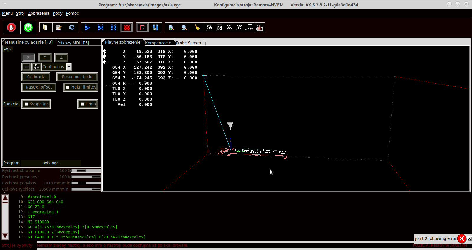

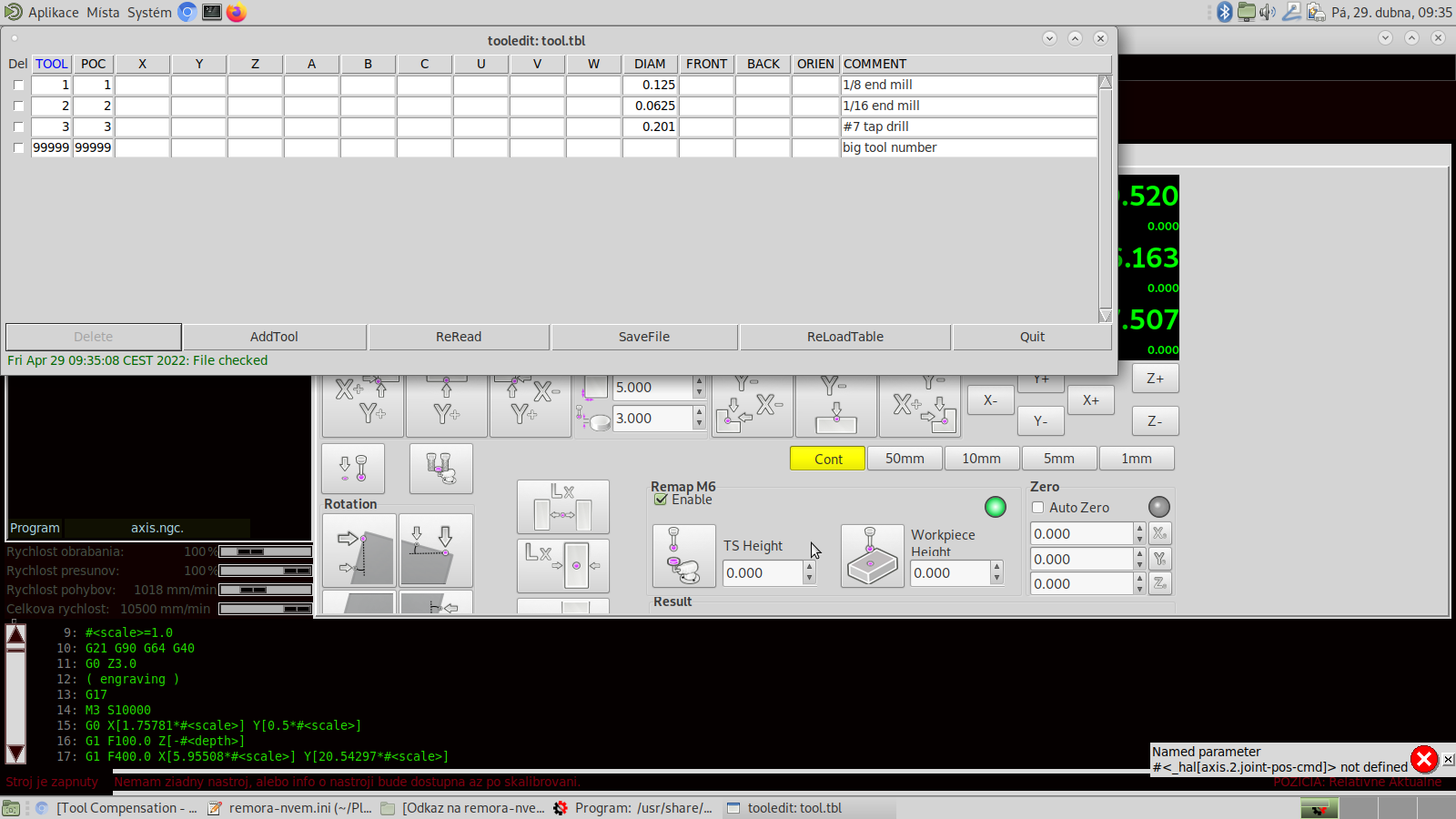

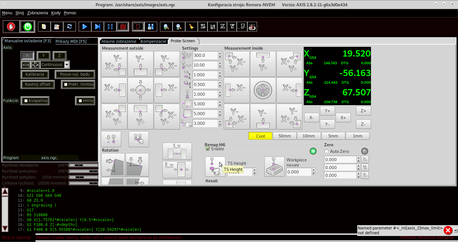

Hello. I ran almost everything. Air for probe touch sensor and so on. The spindle failed. Royka: Wouldn't you provide your file ini? And I have another problem that I can't solve. still has joint2 and max limit error. I've tried everything but I can't handle it. I send photos and files of halls and others. Thank you in advance for the advice.

???? This is an NVEM V2 board. Can someone please help with my problem? In fact, anyone who goes the route will need it. What I'm very grateful to Scott for. If I have everything done and functional then I will be happy to share the files for everyone. I'm beginning to understand paths and lines. But not yet at 100 percent. well thank you

Edit: didn't see the pictures, but still isn't it t a problem with the board/firmware. For the following error you could set the velocity of the joint higher then the axis velocity. Scotta explained that already to me in this topic, however I still had the following errors. The parameter errors I don't know. As far as I can see it's nothing from the ini or hal, perhaps in one of the other linked files "toplevel.py, one of the probescreen files, etc...", but better to ask these questions in the right section
Replied by royka on topic Remora - ethernet NVEM / EC300 / EC500 cnc board
This is nvem2 topic indeed. the problems you mention has nothing to do with the nemv2 board/firmware. As Scotta already told you there are other sections on this forum for these questions. In my ini file you won't find anything about the spindle, this information needs te be in your hal file, this info I've already posted. The max limit is the soft limit you set in the ini file under the axis and joints, but again this has nothind to do with the nvem2. It would be nice if you could keep this topic clean, so when people want to find info about Scotta his firmware for this board they could find it easily.???? This is an NVEM V2 board. Can someone please help with my problem? In fact, anyone who goes the route will need it. What I'm very grateful to Scott for. If I have everything done and functional then I will be happy to share the files for everyone. I'm beginning to understand paths and lines. But not yet at 100 percent. well thank you

For [AXIS_2] MAX_LIMIT is not defined, this looks to be because of an old version probe_screen.py
forum.linuxcnc.org/gmoccapy/36973-error-...be-screen-v2?start=0
I'm guessing the _hal error is also due to an old probe screen of gladevcp using axis numbers rather than letters. Best to ask for help in those sections of the forum.
