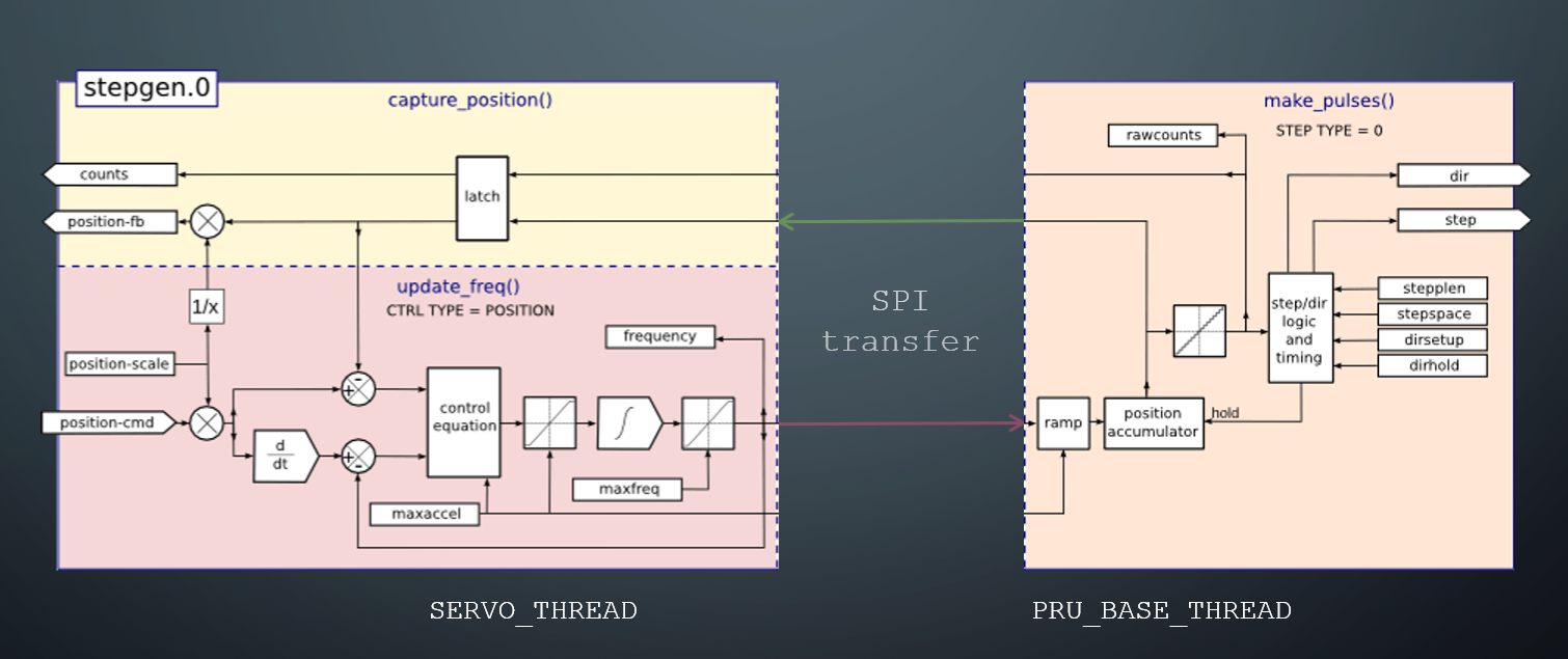

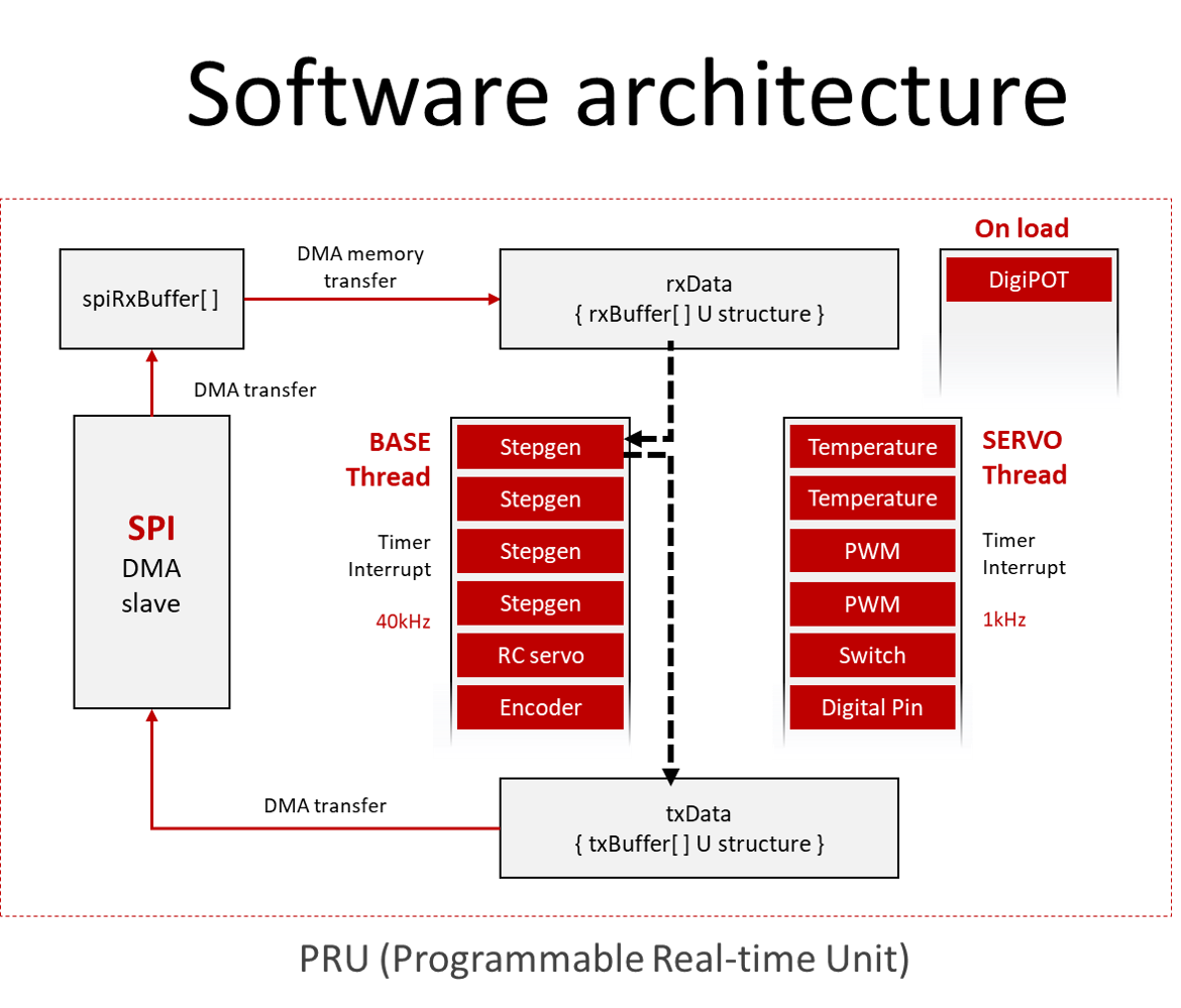

No problem, I did see your posts in the ESP32 thread. Below is the data flow. The two threads are essentially timer ISR routines that iterate over a vector of pointers to the base class method of the modules.
The Remora stepgen module evolved from the standard LinuxCNC stepgen.c, with the two halves split between the LinuxCNC component and the controller board. A PID loop was adapted into the stepgen to cope with the time difference between a read and write to the controller board.
The DDS (position) accumulator is at the heart of the make_pulses(). It does two things, the first storing the position (counts) and the other determining when a step should occur by monitoring a step bit (pickoff)
