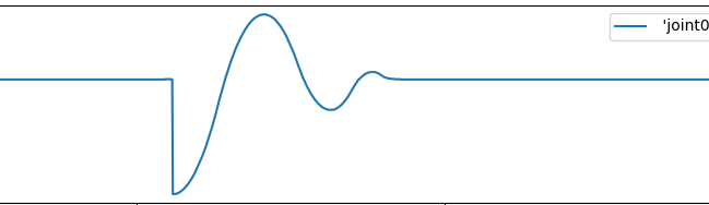

03 May 2022 12:24 #241909 by spdbmp927
Replied by spdbmp927 on topic Remora - ethernet NVEM / EC300 / EC500 cnc board
scotta post=241746 userid=24854Roy, FYI I'm still looking at the following errors. Something really strange going on somewhere as the errors are consistently the same magnitude. I could test by increasing the max following error so that the program would keep running. The same magnitude following error spike on different joints. Makes me think it's something to do with DDS accumulator over flow that Rafal observed in the other thread. Anyway, Thanks for your help and patience.
Scott, Thanks for sharing that i was wondering id it was just mine. I am getting following error also. I have recorded what appear to be jumps in position FB from the NVEM that are consistently ~420, or ~60 counts. I have seen only these two values, in both directions, on all 3 axes. I decoded some packets to see what I could see and got some cool graphs like this:
Very weird. I modified my Remora-eth.c so that it does not update the accumulator on large sudden jumps. Instead I have it modeling feedback for the cycles in question to try and minimize position loss. Im going to test it out later today, but maybe it can help alleviate position errors until we can find the problem.
If there is anything I can do to help track this down let me know.
