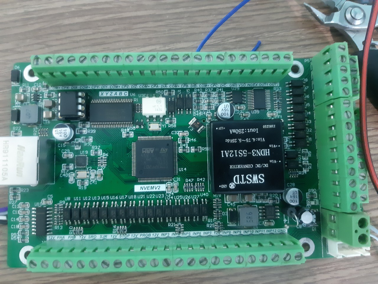

- Win_D
- Posts: 3
24 May 2022 23:26 - 24 May 2022 23:32 #243758
by Win_D
Replied by Win_D on topic Remora - ethernet NVEM / EC300 / EC500 cnc board
For those want to run B and C Axis.
Not sure if all NVEM V2 are the same in pul/dir pins, for my PCB, B and C Axis as following:
B step: PE_7
B dir: PE_6
C step PE_5
C dir PE_4
I downloaded this config and all XYZABC were running fine.
B step: PE_7
B dir: PE_6
C step PE_5
C dir PE_4
Last edit: 24 May 2022 23:32 by Win_D. Reason: attached image data display wrong
